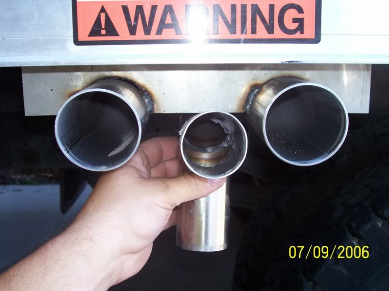

Is that the new parts? Are you going to convert all the way to the tank like Dave & Adam did? This is why I like AT they seem to try to do all they can for everyone no matter the name on the equipment.

You are going to love it. When it is cold, you will be able to keep your side door closed. You can run over the beam and out the stainless trim at the bottom of the box. That's what we did. Good Luck.

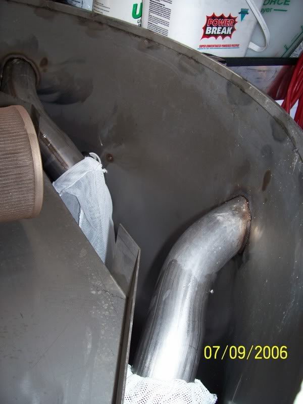

The best thing I ever did. That kit looks really good. AT did a good job on that. I had a local welder do all of mine. I think everything cost about $440, metal and welding. I got a good deal.
I dumped the filter sock in about 10 min. of use.

The FlowEzy filter(s) at the top look to be pretty loaded up too. Spin them off and clean them from the inside out. Hope there is more than one??

There is 3 filters and the discoloration you see is the pantyose that I have on the filters. I clean mine everyday.

I see the kneehigh cover, but I was speaking of the stuff in the pleats, especially noticed at the ends. If you pressure wash the filter out from the inside it looks like you could blow that out.
We run two 3" ss Flowezy filters on each of our little 47's, so three sounds about right for the bigger blowers. I've seen a bunch of 405's with the fitting reduced to use a 2" filter...bad economics.
