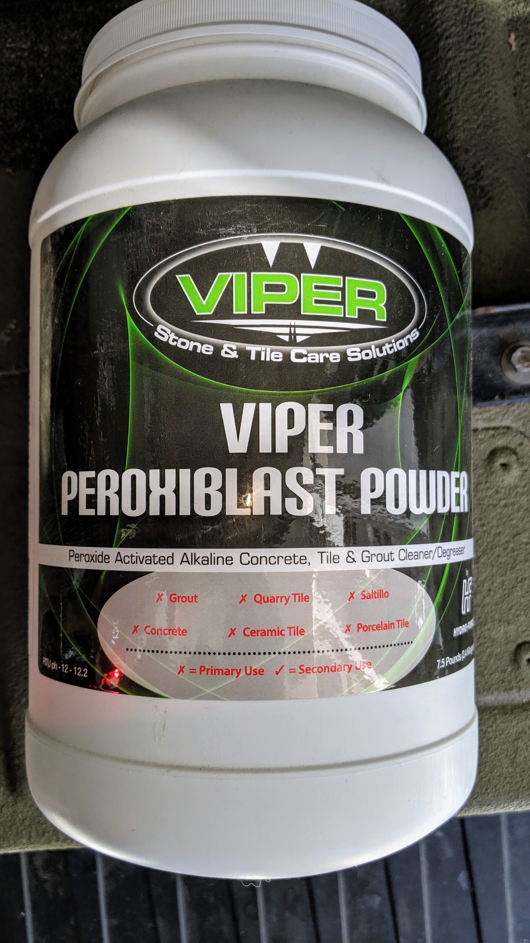

A liquid with a pH of 14 is an accident waiting to happen. My suggestion is that you use powders if you think you need such a high pH. At least with powders the alkalinity is not immediately active and you will handle it in a more diluted form as a ready to use liquid.
Do you have a powder that you use?
Name of product if you don't mind.
115,993
Reactions: hogjowl and Condog
Tom Forsythe
Dec 19, 2006
486
Viper Peroxiblast as Mike showed. Most powders with sodium percarbonate added use a small amount. We use at a level so that it is equal to adding 1 ounce of Boost All to a ready to use gallon. We also have Viper Venom Powder and I have heard of a lot of customers using Flex Powder on tile and grout.
