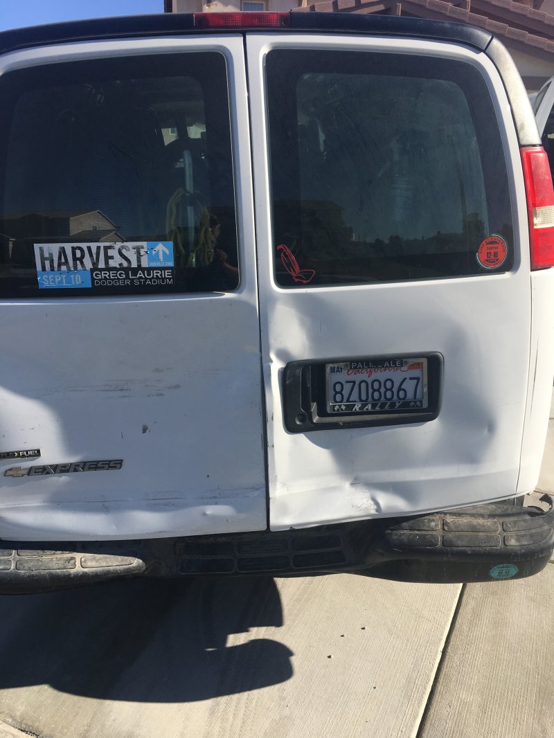

Got rear ended yesterday freeway became a parking lot and he stopped on time
But the guy behind didnt.
