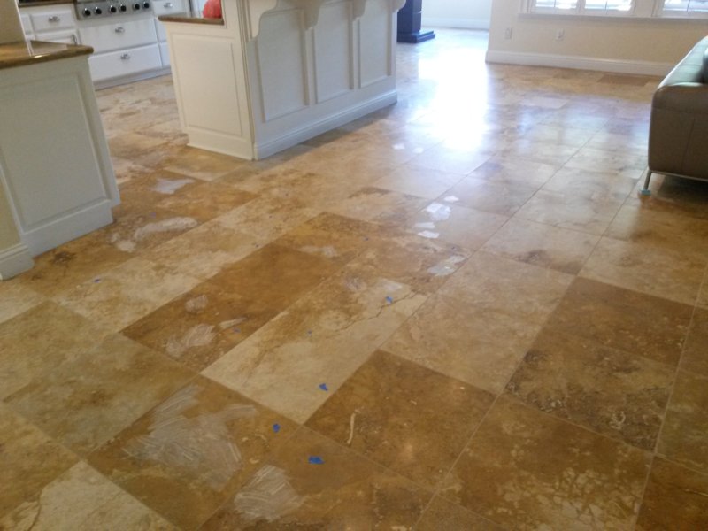

May 11, 2016 #5 Mikey P Administrator Joined Oct 6, 2006 Messages 116,004 Location The High Chapperal I was asked by no less than 25 Blue Hairs to go home with them to clean their floors I was called Cinderella four times I got 8 "Wow Your job sucks! I handed out 5 cards Got watched by one competitor and could have sold AT LEAST 30 Rollie Knee carts from Harbor Freight Reactions: Old Coastie, dgardner and Mark Saiger

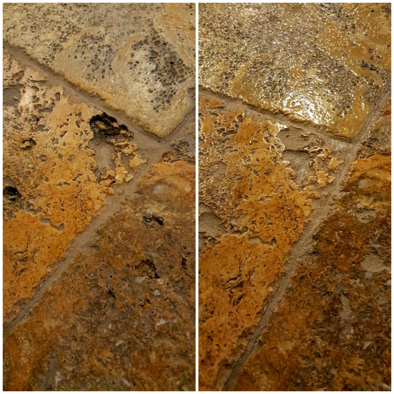

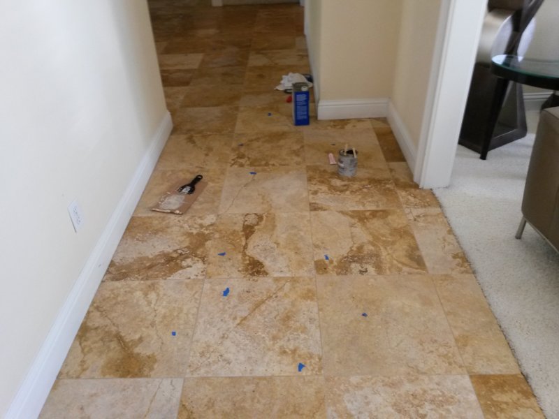

May 11, 2016 #6 GeneMiller Member Joined Mar 24, 2009 Messages 3,547 Location Boca Raton Name gene miller What did you fill it with, Unsanded grout . I don't do it anymore , I just start to lock up if I'm down to long. Most of the guys here use the expoxy filler now.
May 11, 2016 #7 Mikey P Administrator Joined Oct 6, 2006 Messages 116,004 Location The High Chapperal Sanded, mixed 50/50 with Acrylic Admix and water

May 12, 2016 #9 jcooper Member Joined Oct 7, 2006 Messages 3,232 Location IL Name Jerry Cooper clean image said: please tell me you didn't put a topical on there Click to expand... Why wouldn't you seal travertine? Mikey P said: just wet... Click to expand...
May 13, 2016 #10 Mikey P Administrator Joined Oct 6, 2006 Messages 116,004 Location The High Chapperal We sealed the floor with a PENETRATIVE last month..
May 14, 2016 #11 Hoody Administrator Joined Oct 24, 2007 Messages 6,391 Location Bowling Green, Ohio Name Steven Hoodlebrink Years of Experience 20 You said... Mikey P said: PENETRATIVE Click to expand...
May 14, 2016 #12 clean image Member Joined Oct 5, 2012 Messages 970 Location Orlando Name Carl Maddock Impregnating... Ok Not film forming sealers

May 15, 2016 #14 GeneMiller Member Joined Mar 24, 2009 Messages 3,547 Location Boca Raton Name gene miller didn't know you could use sanded grout. i always thought it would scratch the finish.
May 15, 2016 #15 Mikey P Administrator Joined Oct 6, 2006 Messages 116,004 Location The High Chapperal Huge holes...
