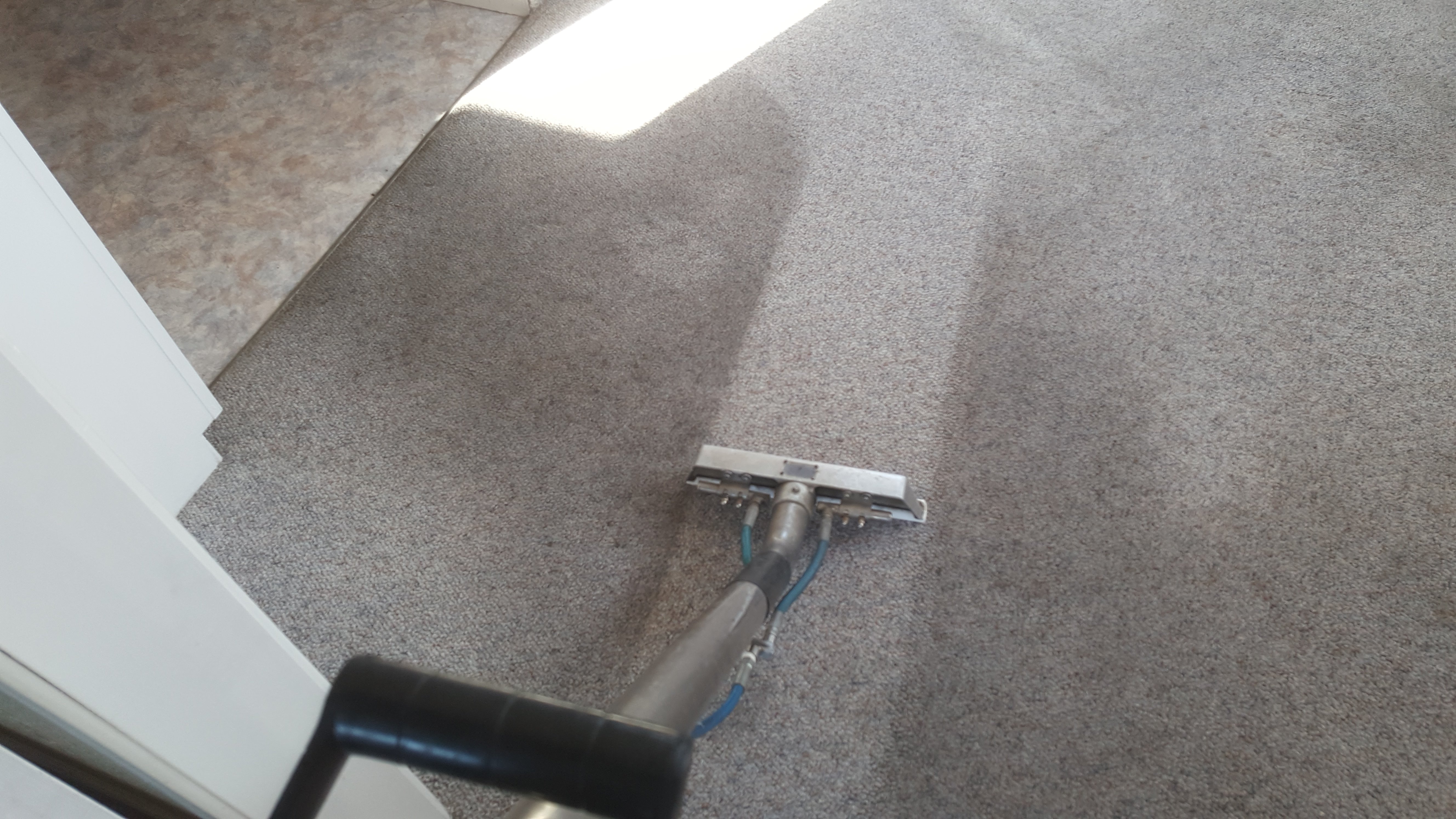

20180720_101634.jpgFourth wool job this week and its my quiet season..
just because its wool doesn't mean it gets respected!
Didn't work too much on some the staining, the old boy just wanted it tidied so he could bring his girlfriend back from the retirement village lol
