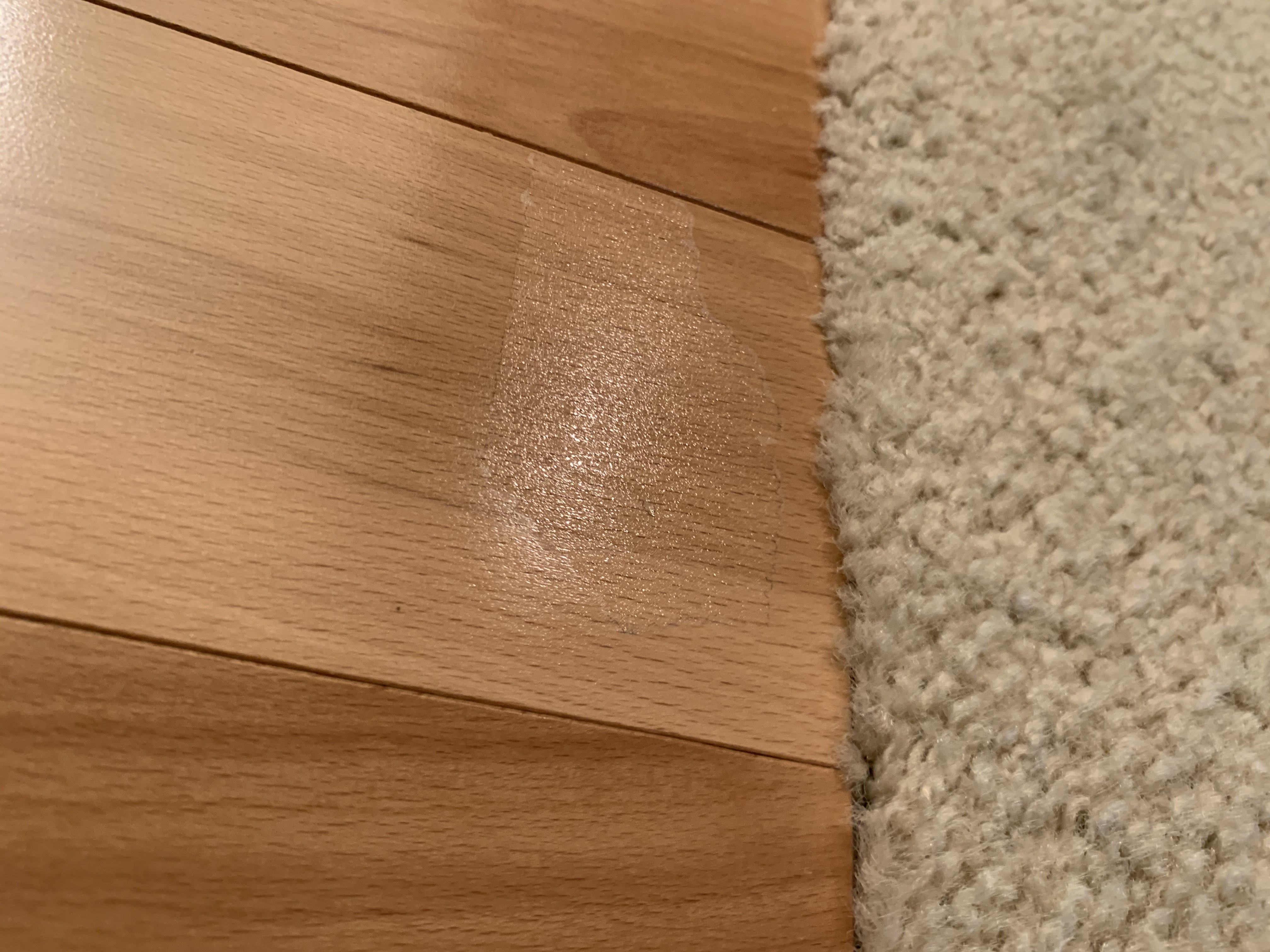

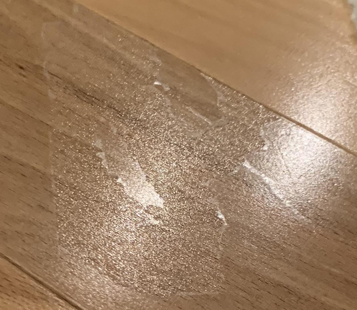

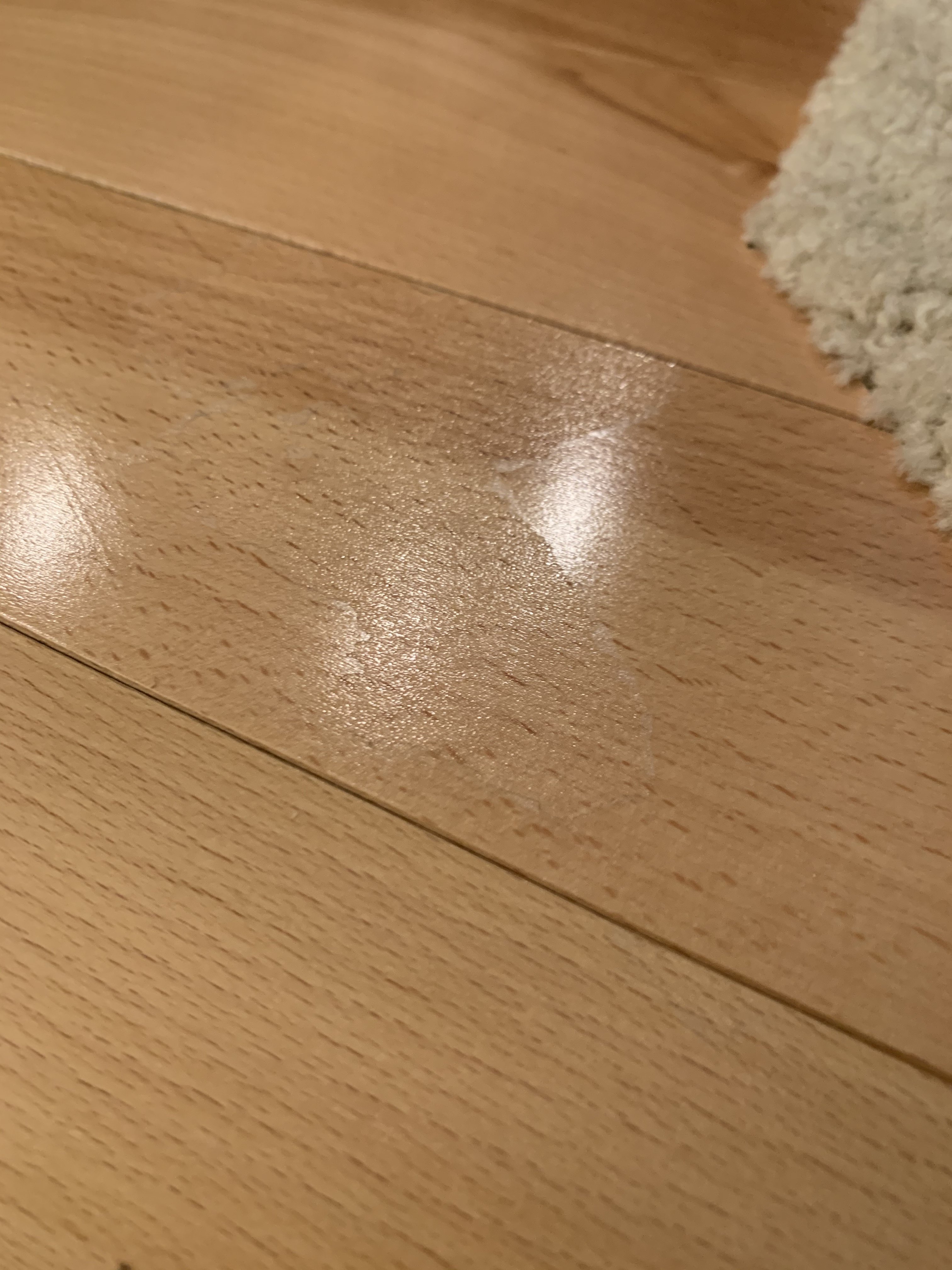

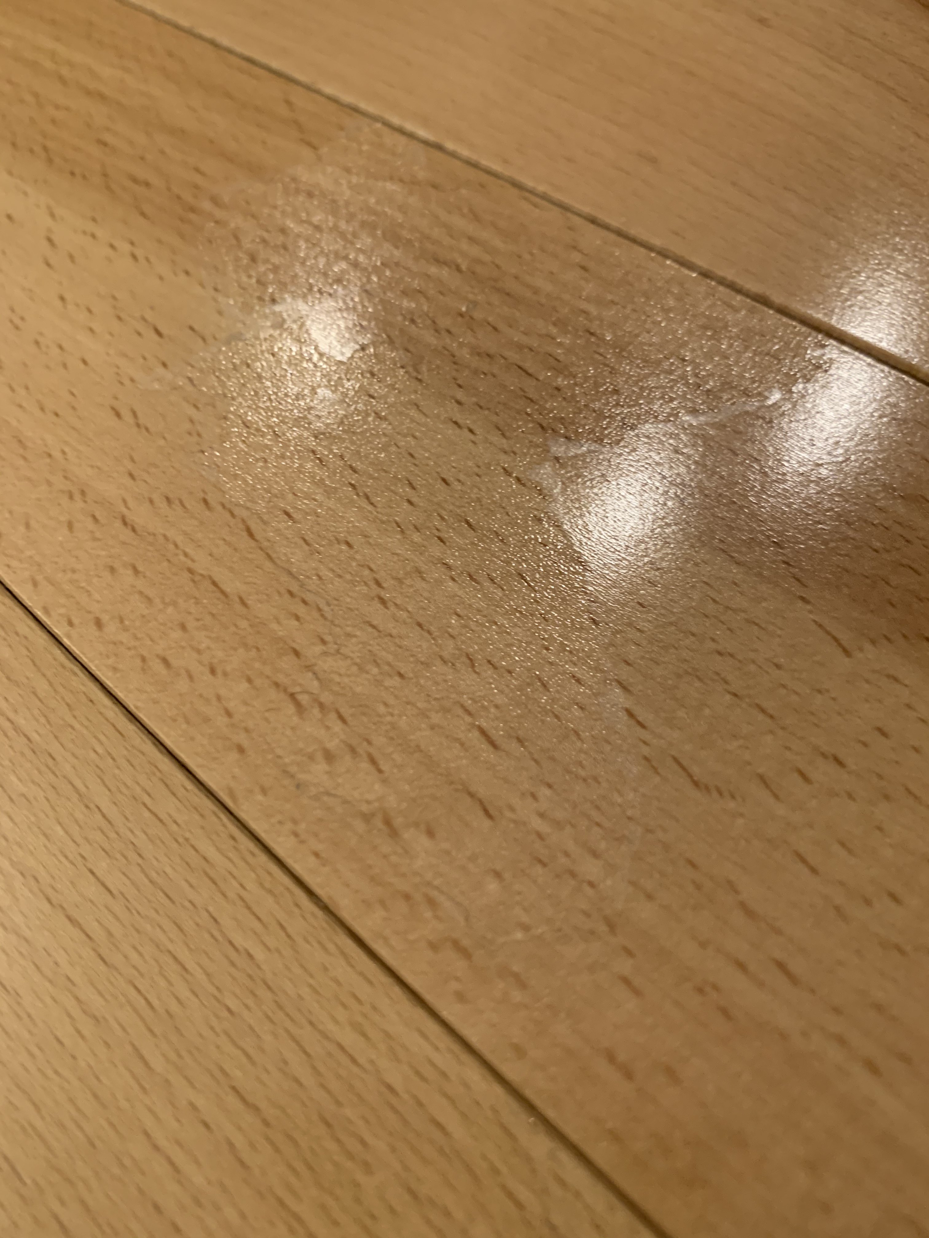

last pic looks like the finish was actually pulled off
Looks like the finish bubbled to me.
Probably going to need a light sanding either way and new finish.
The area that looks wet still probably the same repair but put a fan on it after sanding to get it dry.
I'd say the Prespray migrated under the tape and ate the finish on the bubbled spot and possibly the other spot too. The finish was probably already wore out allowing the Prespray into the wood. Could have got under the finish from the edge also from getting the carpet too wet.
After looking closer I see the finish on the water stained spot too.
5,295
the customer had me clean the carpet prior to moving in so maybe the sellers had the floor refinished. That is something I will need to find out.
No real floor finish will peel like that.
Any scrub and run wood cleaners here that can tell us what product might have been used? Maybe the right solvent applied with a white pad will take off the rough stuff so more of the same garbage finish can be applied.
It might be an opportunity to make friends with a hardwood guy that likes small repairs. He's probably seen this before.
scotty747
Oct 19, 2006
922
The tape sealed in the prespray. Light sand, light coat, buff to blend. After that its a refinish to get everything to match.
