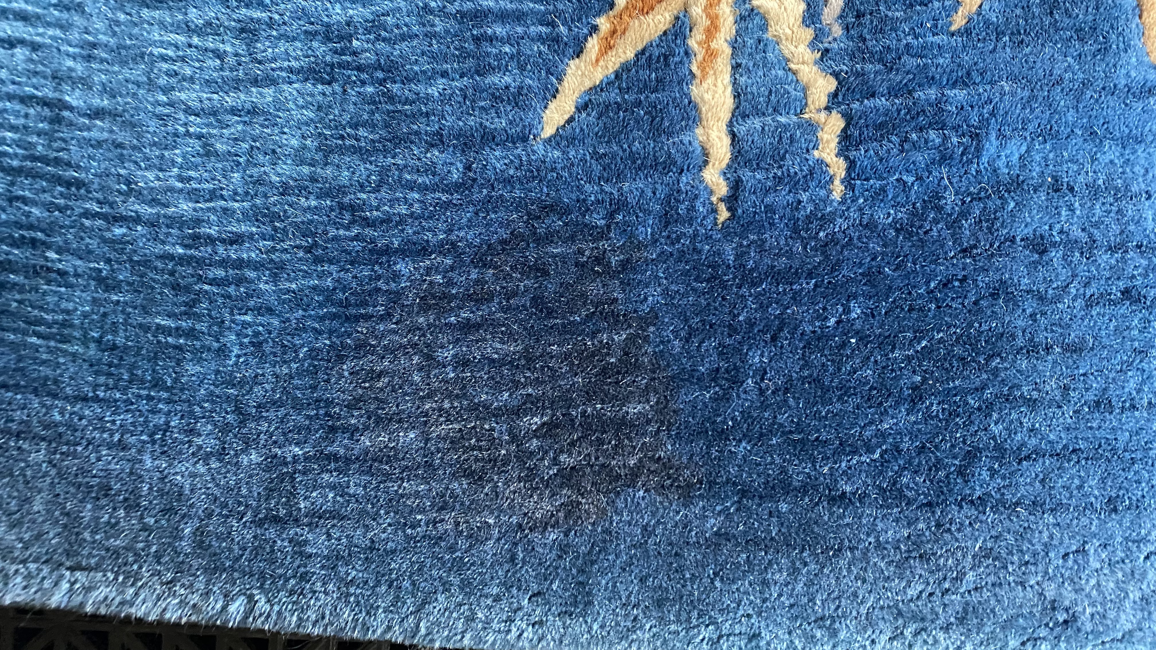

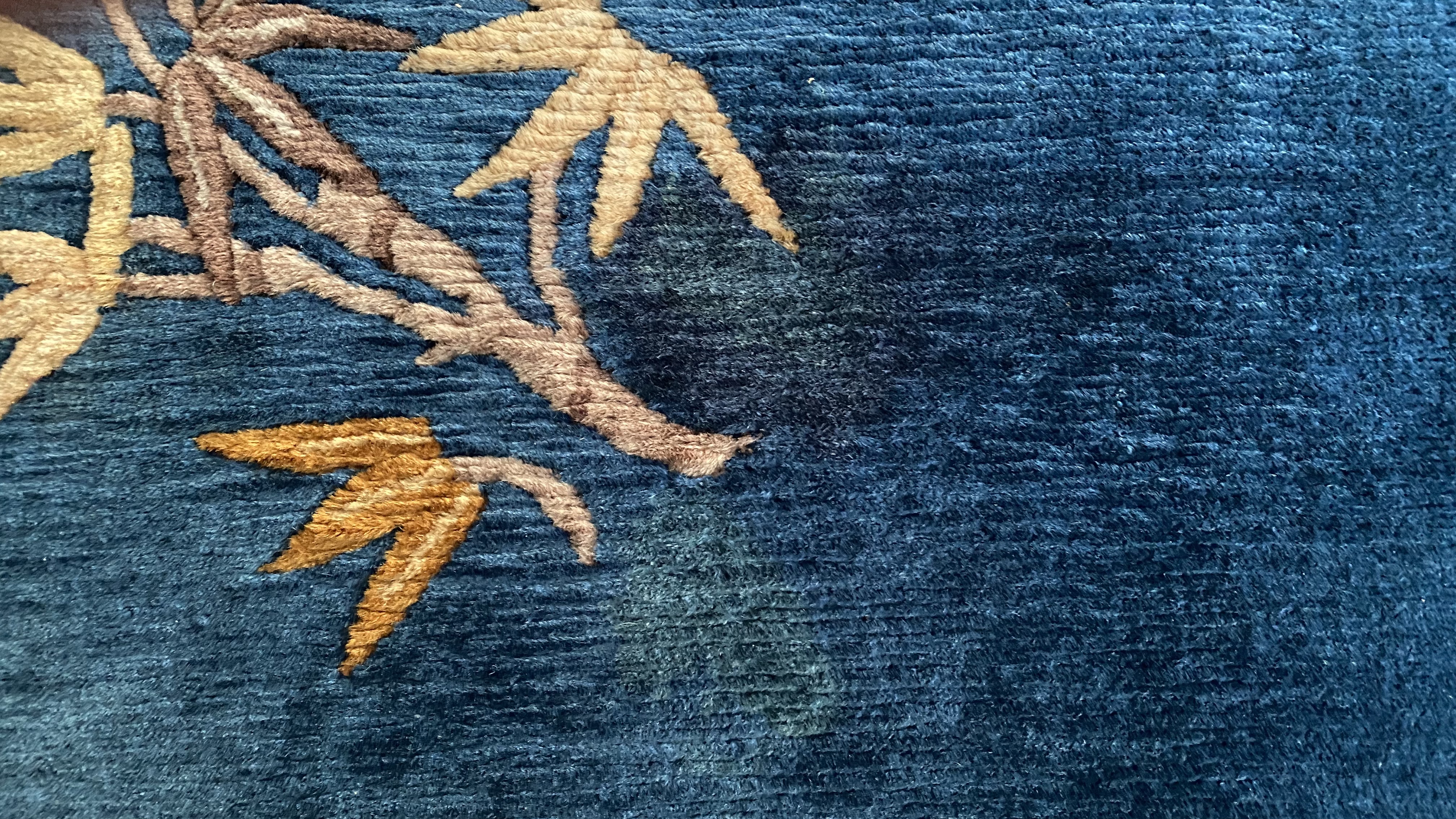

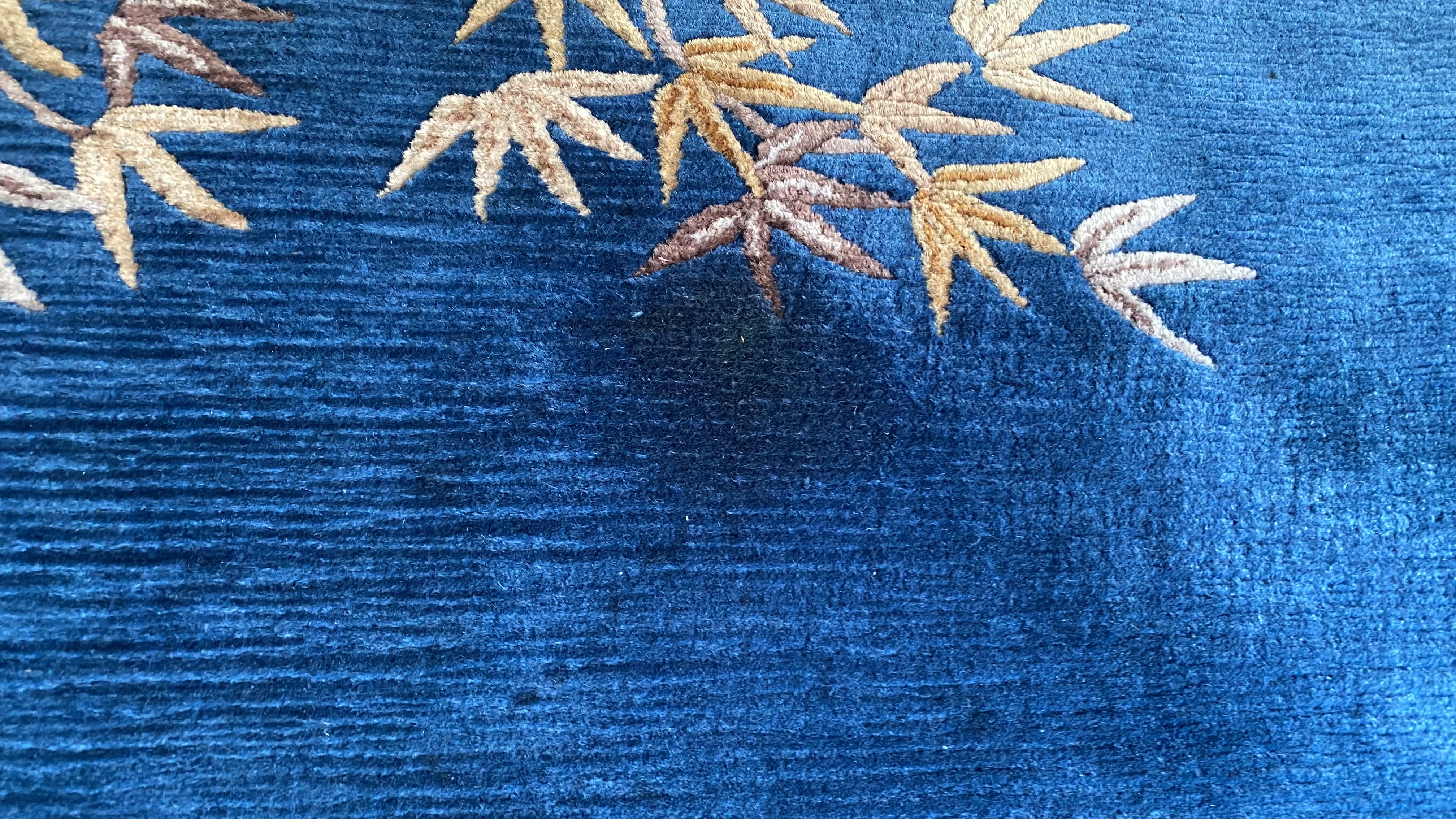

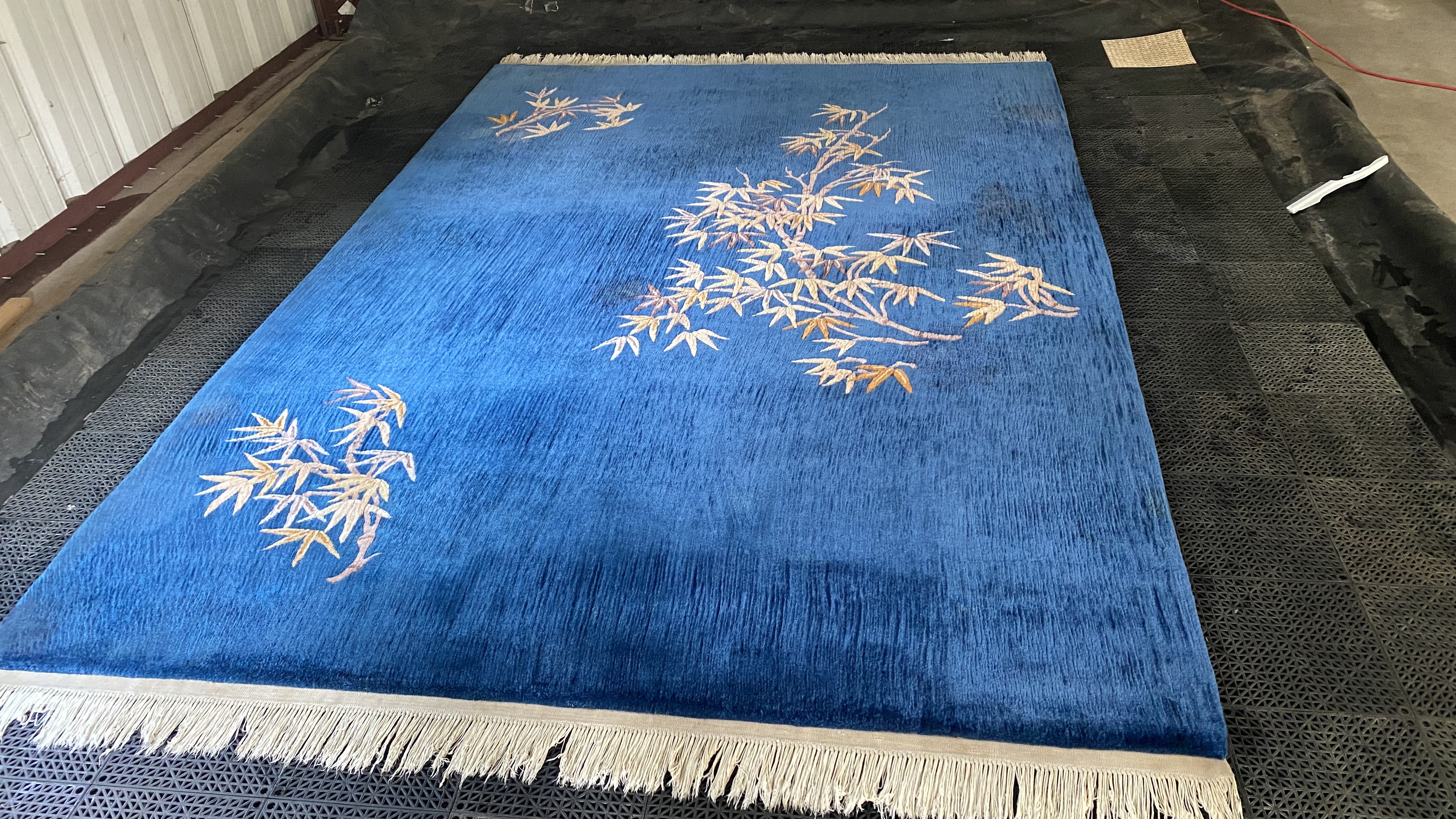

I’m cleaning a beautiful rug today. I warned the customer that the preexisting dog vomit might cause further damage to the rug and be permanent. Sure enough the dyes migrated and the bile bleached the rug. Very sad. But over all the rug cleaned up nicely. Just posting this to show an example of the damage thet urine and vomit can do to a wool rug. I’m glad I exonerated the customer of the risks before taking on the job.

90 lines are notorious for staining easily.. It's the chemical wash they use to soften the wool to get that luster feel.. Don't try peroxide on them either..
You could touch up with the dye pens for rugs.. Expensive for a set, but you can hide/lessen the appearance of the stains.. White knots are a common occurrence..

By making these issues clear, you have a happy customer instead of an expensive claim.
This is business is all about communication and expectation.

Honestly guys. I’m nervous about returning this rug. The vomit stripped out the color in some areas making it look worse. Even though I was clear about this, I’m still a bit nervous.
Don't let her see you sweat
Don't apologize, just let her know that what you suggested might happen, did.
Then be quiet and let her speak next.
Remember Grasshopper, it was the dog than diminished itself by its behavior, not you...
You'll be fine
