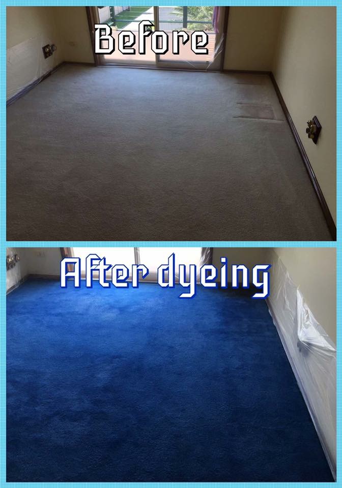

Check out this color change that one of my trainees in Australia just did today! Very proud of him!
Notice that he taped off the walls to protect them. We just use a dye shield, but nice to see how he respects the customer's property.

Nice job on the protection. Just wondering if they just wanted to change the color or was there something wrong with the carpet, ie: bleach, color damage or something we can't see in the pics.

Not asking for a lecture on your favorite subject Chris, just asking how often do you have clients who want a complete color change just because.

It depends on the customer [obviously]. We're doing a massive job right now in Bethesda, Maryland where we're changing the color of 29 floors (don't quote me on that number) of hallways that are as long as airport runways.
Having said that....complete color changes aren't nearly as popular as they used to be. When I got started in this business back in 2000 there were a lot of carpets that were 80's colors (pinks and country blues). So in the early years we literally did thousands of color changes to get rid of outdated colors. We still do some of these, but they're not as common as they used to be.
But we still get HEAPS of requests to create custom colors for clients for both carpets and rugs. Custom colors would be defined as a color that's not available anywhere else, so they contact us to create it. We typically charge $12.00 per square foot for creating these custom colors.
Why so high? Because it's a luxury service (kind of like owning a yacht). It's not something that's needed to live/survive. These custom colors are usually requested by people that are working with interior designers and/or architects who are trying to achieve a very specific decor. They can't get it anywhere else, so they come to us for the final solution. We charge accordingly. :)
