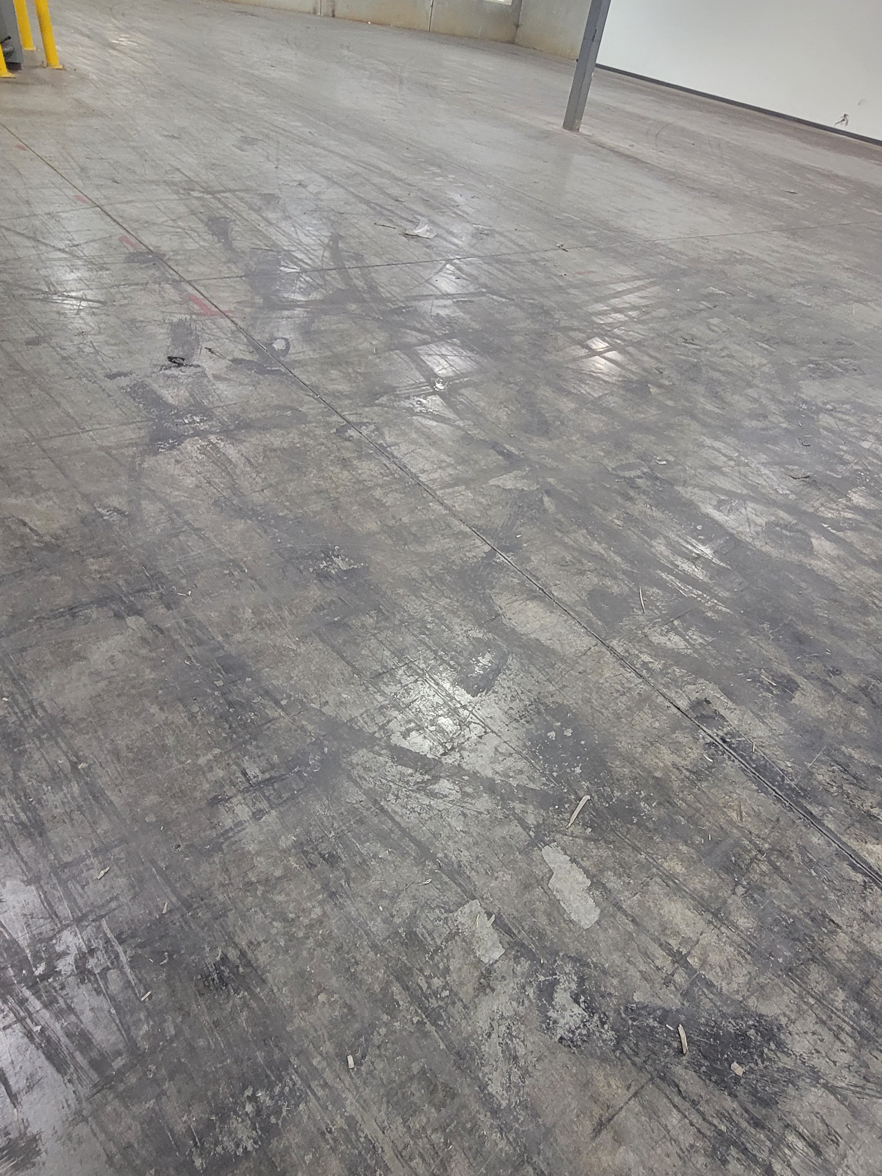

Best way to clean forklift tire marks on sealed concrete?
Cybei
Oct 27, 2021
1
FORT COLLINS
Andrew Johnson
So my boss got a job cleaning a sealed concrete warehouse, we have never cleaned concrete before but we have cleaned other hard surfaces. So I was wondering whats the best way to clean off forklift tire marks, any help would be appreciated! Have picture attached for reference 20211027_170917.jpg

I remember reading about that problem on a pressure washing board once a few years back. There’s a product just for that, but I don’t remember what, or the techniques used. Look around FB for pressure washing groups.

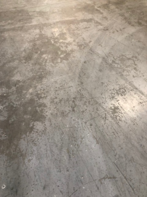

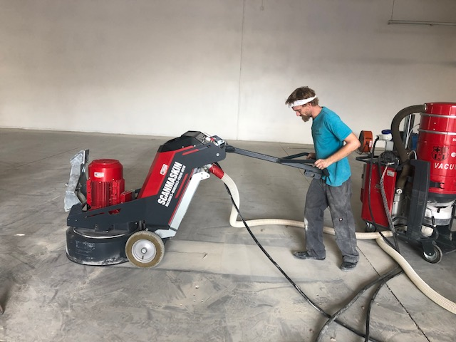

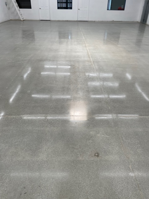

Todd Slamen
8000 sf building it was with failing epoxy, ground off start 16, 40, 80 metals, 100 transitional, 100 resins, denify, 200 -1500 guard and burnish
I started off carpet cleaning went into tile and grout, then marble granite, and now concrete. This job almost paid for my equipment just got into concrete in January.
Just do marble, granite and concrete, do use truckmount to rinse them
