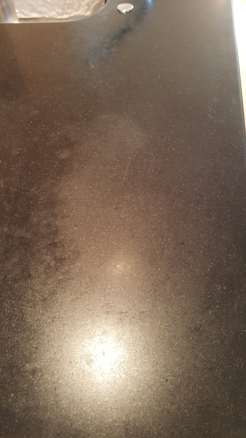

That looks like black absolute honed-it has a color enhancer on it-thats whats etching and degrading.
You can use a honing powder from 150g to a 280g range to remove all the residues of the enhancer.
Then give your client an option to color enhance or leave natural.
We do a lot of black ab here in the city-sometimes busy kitchens are better left natural.
If you give the client sound cleaning advice they will do well with honed black ab.

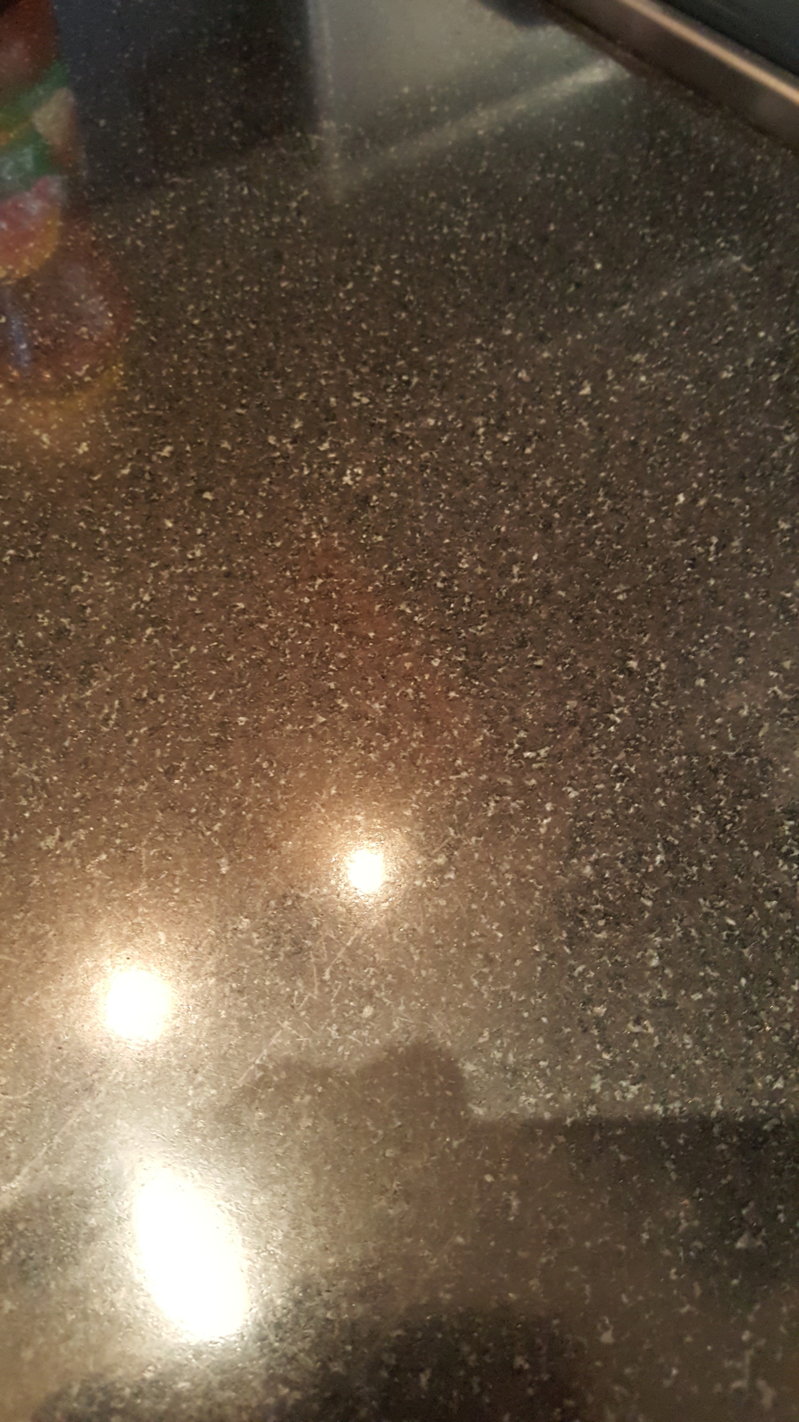

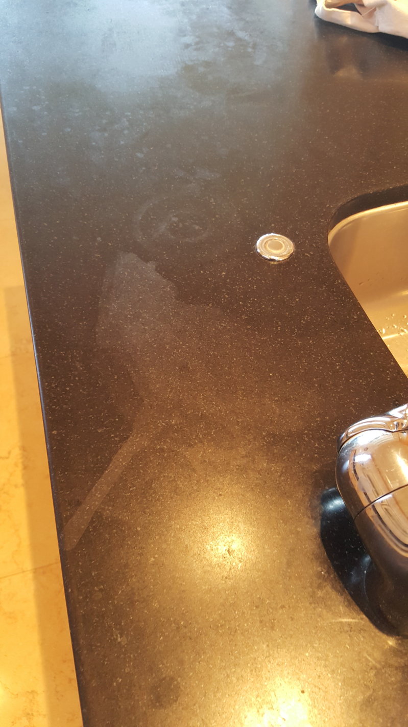

The grain structure sure didn't look like Absolute.
Never seen the sort of "etch" damage one one either...It's twenty plus years old so I doubt it's been died.
The house keeper says she "oils" it frequently till try and hude the stains/etching or color loss if you're correct, with no success

this is a version on BA they sell on the market, but it is not the original Indian Premium Black. This is a version they dye to achieve the black color and it etches fairly easily. So when you successfully remove the etch marks and restore the polish, you will often be left with a dark gray color instead of the deep black. The larger white speckles is what gives it away to being the cheaper version. This stuff is a nuisance and the only way to be sure it turns out evenly IMO is to cut the entire thing down and bring it to a honed finish, then use an enhancer.
You can also re-dye it with Tenax Uniblack or Tepox V, but there is no guarantee that it will be even and not splotchy

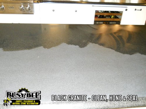

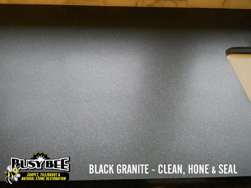

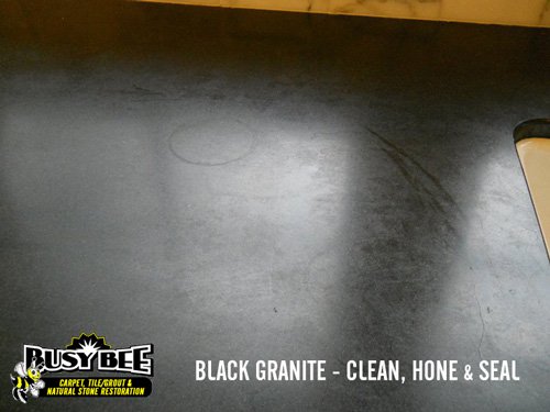

Here's how these come out looking Mike. This job was a referal from Stu several years ago (Thanks Stu!). I honed with 200 and 400 honing powder and enhanced with STT CE
Reactions: Jimmy L
