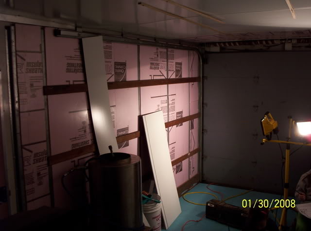

the process of insulating
did the ceiling....this summer going to somehow finish up the front part (no framing to put insulation panels in)
then put the ole space heater in
the truck is usually nice and toasty...nothing frozen yet..though i do sometimes worry about stuff on the floor...
