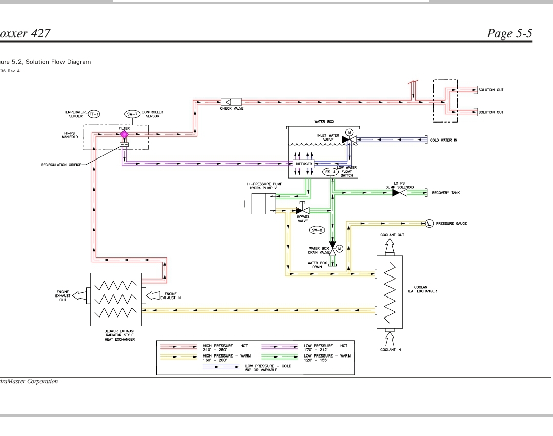

Dale
I recently replumbed my thermalwave very similar to the everests layout. If you want to send water to the water box to circulate, you need a size 20 orifice disk installed on the ystrainer where you qd’s are so it can send the hot water back to the box when you’re not pulling the trigger on the wand and will also be accurate in the water temp readings

Swani
But I can’t remember if that model truckmount has a ystrainer
