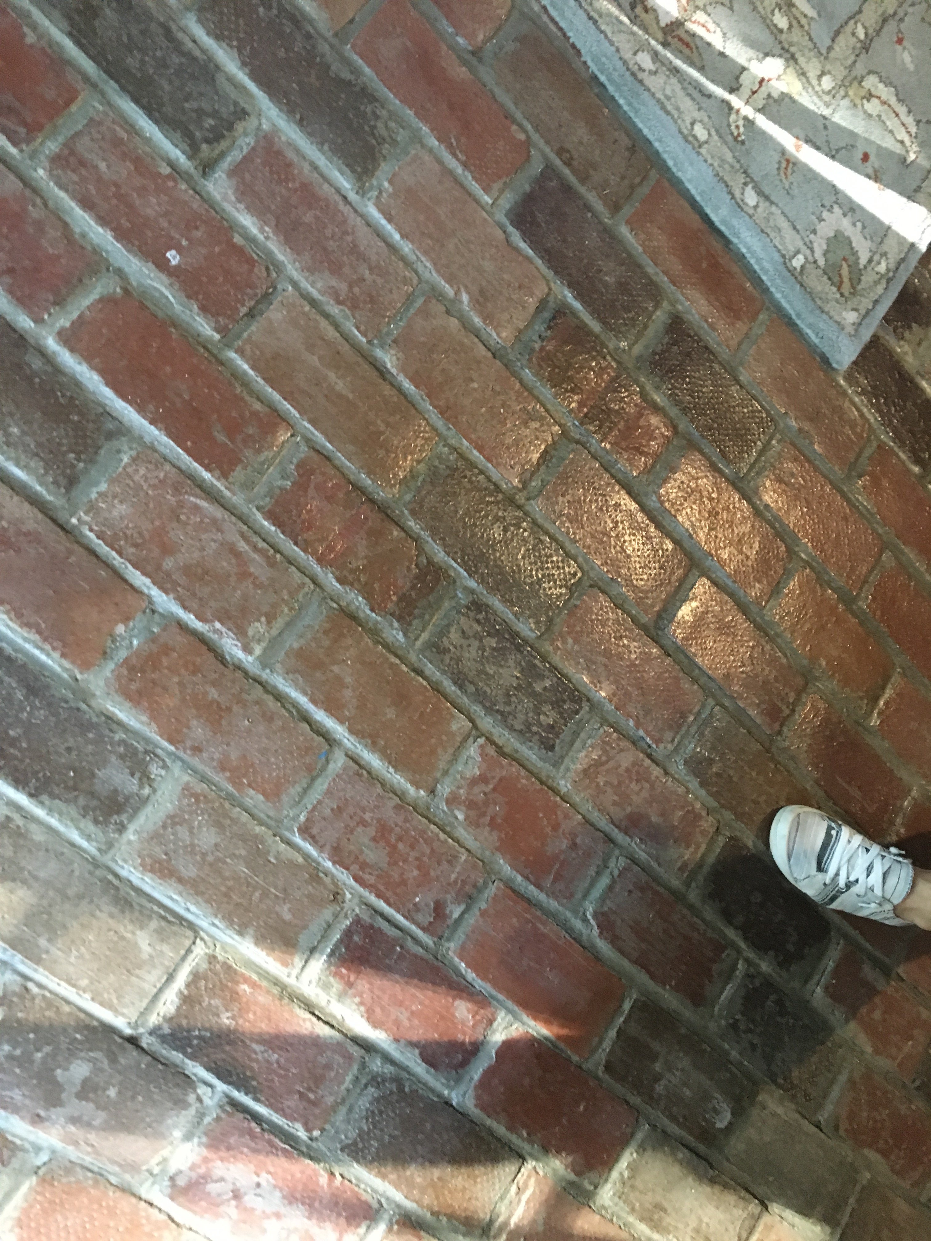

So far, this looks like the best stripper. If I could paint this on in 100sq. ft. sections and let dwell for 30min, that would speed the job up really fast.
Most strippers are gonna work fine Matt, the way to do these floors are multiple strippings per each area. It’ll usually only get off a layer or two at a time. The hardest part will be the last 10-15% of finish on the floor. Patience is the biggest part of these. Not at all like tile and grout
Floor finishing application is also good too protect it from resoiling and scratches

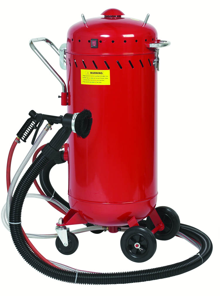

I wonder if it would be possible to use the Dustless Blasting system on something like that. Have to do a lot of plastic and taping.
.dustlessblasting.com

Wow, you all make a mountain out of a molehill. Do a test patch stripping the bageezuz out of it and let owner decide what finish if any they want. It’s a floor for crying out loud. It was only new once Ma’am🤷🏻‍♂️
