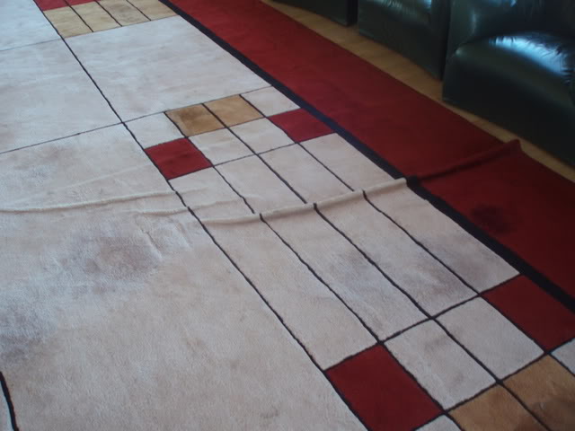

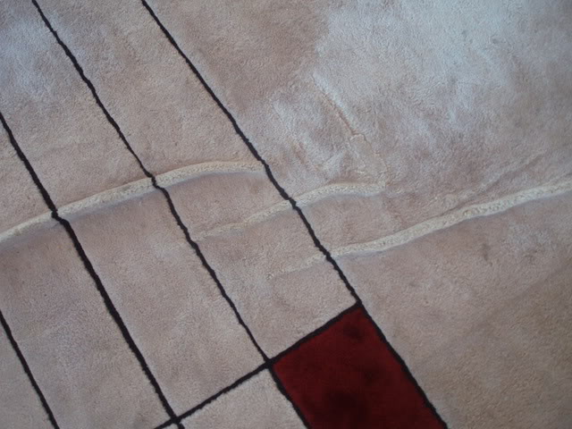

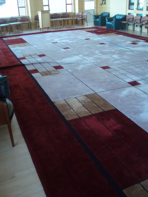

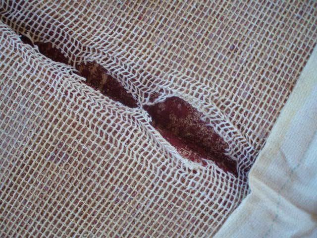

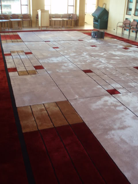

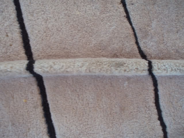

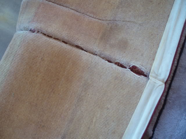

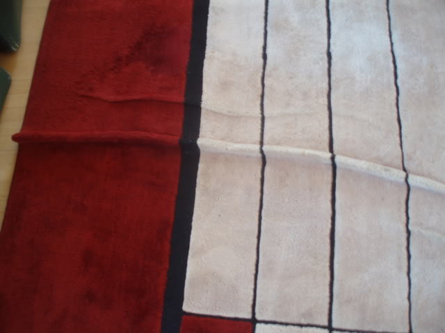

30 year old wool. All pieced together. Sees lots of use through out the average day. Chairs and tables getting hauled across it daily being rearranged. The damage to the backing was doe when the last company rolled this beast up and dropped it down 3 flights of stairs.
This is the 3rd time we've cleaned it on location.
I've put a sheet of particle board under it and stapled it down but as the rug gets used, the wrinkles come back. (in the same place of course)Usually takes a month or so.
Rug is not fixed to the floor in any way and is on top of so Nomuv.
How would you go about fixing this?
I have some ideas but would like to hear those of the Tool Room Pros.
After I stretched it out and tacked around the wrinkles.

I think that the problem here is that there is not enough dimensional stability in the backing for the size of this rug.
So my guess would be to latex on an extra layer of backing material like monk's cloth.

I'm thinking along the lines of Tony.
My question is, do I cut open the wound to drain the puss or just flatten the lumps and glue them down?
Some serious damage to the backing as you can see and so much slack that I could cut out the damaged area and stretch it back together before applying a new backing.

Bet you could make a few simple stretchers out of 1x4 boards, tack strip and allthread. Stretch out from backside and repair in sections by glueing on new backing in affective areas.

You would have to steam out the wrinkles carefully ,or block it out on a floor . I would latex and reinforce it with a Scrim tape 6 inches wide. Let dry over night. Also what you do if they dont mind . Assuming this is a wood floor you can put down some tackless and make a permanant frame. I see you wrote they do alot of moving things around. I had a 3/4 yd wilton rug do the same thing. Who ever sewed it put to much tension creating puckering that eventually turns into wrinkles. Permantly block it after a couple attempts . No problem since.

Winner! The backing is broken down enough over the entire rug that fixing just the wrinkled section will invite the adjacent backing to fail. Tacking it out won't help as under tension the weakened backing will continue to fail.
I'd use Jute to give it a heavier backing, and jute sticks to latex better than Monk's cloth. Well, at least the current version of Monk's cloth that has a lot of polyester in it.
Roll the rug up, drag the roll around 180 degrees and pull it back out upside down. Usually you'll have to put tension end to end to get the area of broken backing to lay flat. Sometimes this is as simple as having two guys pull on opposite ends, sometimes you'll have to figure out a way to tension. I've used two senior carpet stretchers assembled into one with a head on each end. If it doesn't want to stay stretched, you could try "massaging" the back of the carpet with hot water using an RX-20 while the carpet is under tension. We were successful fixing a 40 x 90 hand-tufted in a hotel lobby this way. There should be no need to cut the wrinkled areas.
Once the wrinkled areas are flat, starting in one corner, spread a good quality latex (Parabond) over an area 4 feet across the width of one end of the rug wide by three or four feet down the length. (3 or 4 foot wide fabric is easier to work with than wider widths, and easier to find). Spread the latex just thick enough for it to get a grip on the backing fabric - it shouldn't be in puddles. Set the backing fabric into the latex and let this first section set up until the fabric is well stuck. Keep working down the length of the rug.
Lap your next course over the previous by an inch or two and do it again until the rug is completely covered. Leave it in place to dry overnight and then roll it up and turn it face up. Other than making it a double-stick installation, the choice is between doing this or replacing the rug.
NOTE: When stretching, pay attention to the straight lines of this carpet and try to keep them straight. If the ends are irregular when finished, trim them and finish the cut edges with latex and hand bind.

Unless there's a lot of wear or stains, or they just don't want it anymore, the rug should be fixed. I'd venture replacement cost for this rug would be well over $100k if sourced directly through a Philippine shop.
Does it have any surviving label? If it is a Tai-Ping (which it looks like) or a V'Soske or Fields (which it does not) the replacement cost could be double that.

That rug looks to be at least 60x20 feet. So if this turns out to be a $9,000 job or more, make sure you video the whole operation. I'll bet there are a lot more like that in the Bay area and this would be great promotional material.

For goodness sakes! Don’t do anything drastic. If that rug were my problem I would insist on an appraisal. Then you know what liability you’re up against if things go sour. The rug could be worth less than the can of gas to burn it. Or, it could be a gift from the Prince of AreaRugastan.
Even if it’s only worth a couple thousand bucks I wouldn’t misrepresent my area of expertise. Make no mistake about it, “I’m an expert textile cleaner”. Besides, there are dozens of rug repair shops in San Francisco Bay Area who are experts in their field. A quick google revealed one shop that will clean, repair and guarantee for $2.00 sf. I wouldn’t worry about losing the client to the repair shop for future cleanings because it’s not practical to move the rug for purposes other than repair. Another google revealed Pam Hiller http://www.hiller-restorations.com/index.html . She’s a bay area local that advertises appraisal and repair (send her a pic).
If the client thinks the rug isn’t worth appraising, and decides they want you to do your best, make sure to get a release in writing. Then you can hone your area rug repair skills with all the latex, monks cloth, and duct tape you want without fear of lawsuit or insurance claim (if your insurance will even cover it).

The goal is to get the rug flat and get it to stay flat. Very quickly those wrinkles will show wear from people dragging their feet over the high areas.
If it isn't possible to stretch the wrinkles out and get the center of the rug to stretch the same amount, you'll end up with a wavy end. A straightedge or chalkline can be used to mark and cut the ends and the cut ends can be given a finished look by wrapping them with binding tape.

I would start in the center and work my way outwards until it’s securely anchored to the floor in all directions. If the edges aren’t perfectly plumb afterwards so what. Who care’s? From the pic’s the room is cluttered with podiums, chair’s, love seats etc… I bet nobody would notice, or care, if it’s not perfectly square.
Did you say something about a pad underneath? I didn’t see it in the pic’s. If there is a pad then we have a problem anchoring it to the floor. But, you have nothing to lose by Cool Gliding the weak and broken seams. If it doesn’t work out you can always re-activate the tape and remove.
