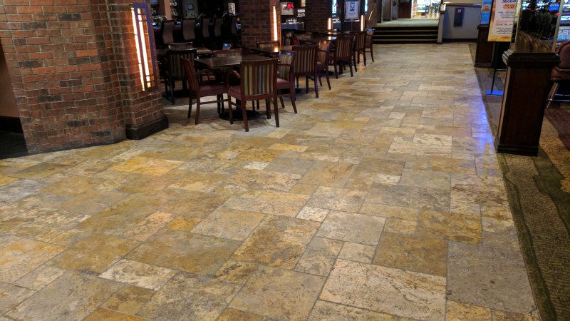

I spinner'd and Cobbslopped this floor over a year ago.
Still looks pretty good due to switching them over to a flat mop routine.
But could use a freshening up.
I'm thinking of running the Magic Eraser pads under my Cimex which should do great on the tile but not the grout. That might be good enough.
If not I could mop down some nuetral, CRB, mop up the bulk of the mud then Magic Pad it. The magic pads suck up a lot of muck and would need frequent rinsing but I should still be able to do it all in a couple of hours..
Thoughts?
