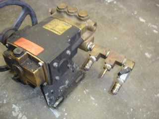

Chad, you are a smart guy, starve your pump intake 10% (needle valve is best, but even a ball valve will work) then T off the intake and run a small line over to your Dwyer meter....viola' your pump will pull that lost 10% from your Dwyer, you meter from there.
let me see if I have a pic?
Closest to the pump is the bypass return, then the small barb is for chem line, last is the fresh water feed.
