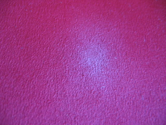

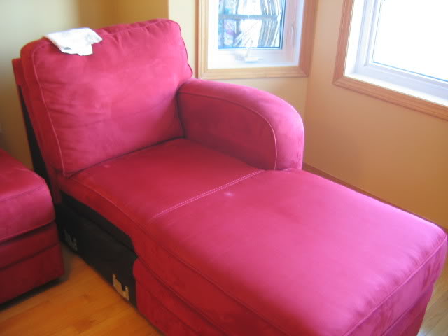

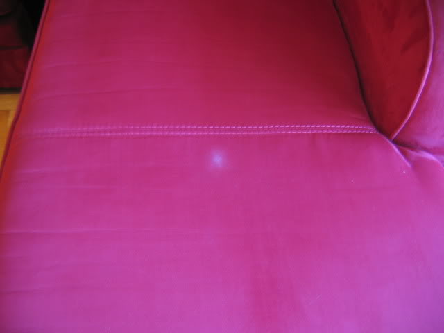

I attempted a spot removal on a polyester sofa recently. No pre test. Used a vds and no problem spot came out but removed color also. Is there anything that can be done to rectify this?

If it removed the color just use some dye. There is so many shades in micro fiber when looking at it that if the dye is even close you will never know its there.

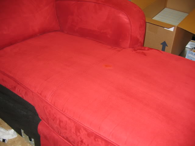

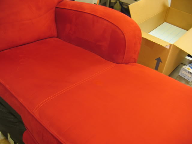

Did a burn test, all I can tell is that it is synthetic burns down to hard ball and has a white cotton backing. Found a marker pen that I thought was close and depending on light and lay of the nap looks not so good:
or not so bad:
Will return piece to customer and see what they say. Thanks for all the help
12,835
Your burn tests confirms synthetic. All that I can imagine is that it might be nylon (there is some nylon microfiber out there) that wasn't dyed properly.
The repair looks better than the fade; if your customer is a decent, understanding person, I'm sure you'll be ok.
