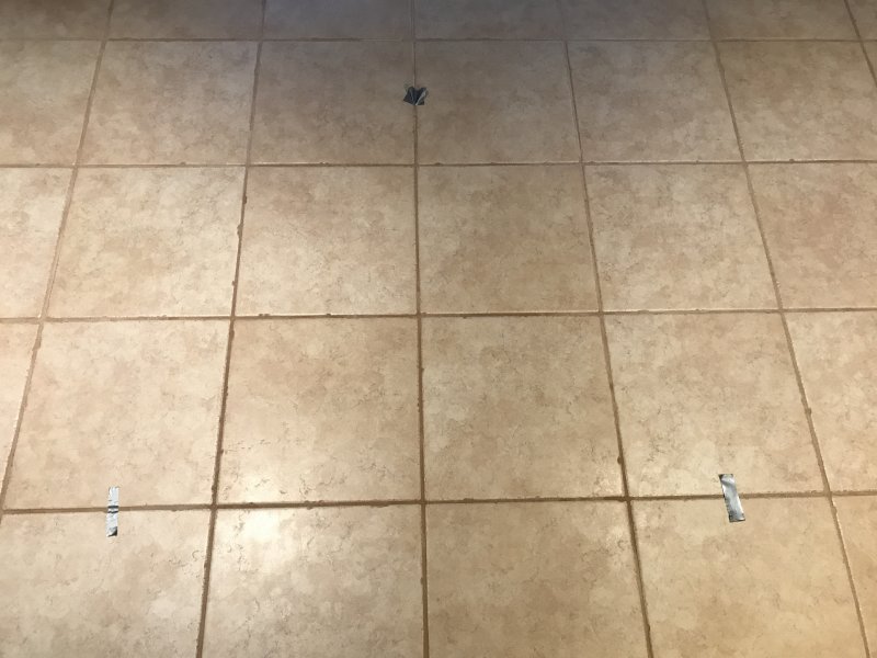

Here is the tile I'm talking about.. Does this look like color seal?

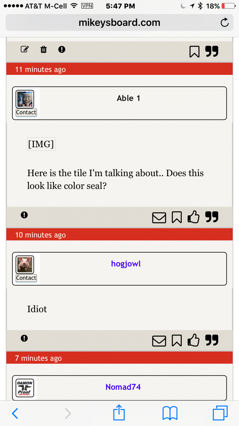

The pic. was copied and pasted from an email, does that not work?
No. At least not by referencing the location in your email. That is secure/private
You can see it because you are allowed to see your email...we aren'T
You can drag/drop the image in a message , copy/paste the image itself, or upload the image

It's been a long time since I loaded something off my computer.. You guys only get live shots!

Photobucket.. It's been three years! So what say yous?

Lol, pic of the day! So wth is wrong with the tile?
