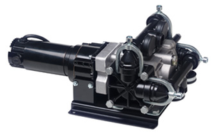

Show a picture of you pump out so i know which one it is and then can advise on possible solutions.
should have done that, here it is

That pump is a true semi solid pumping pump.
I am wondering if your motor is weak or if you inlet is somehow blocked with a large solid.
If the motor is fine and getting the correct voltage and amperage then there has to be a blockage or the check valves are not seating as there is not much to this almost bullet proof pump design.

there is no impeller in this pump out it just has 2 pistons turning off of one crank pumping through check valves for proper water direction/movement.
sam is correct as there are 4 check valves 2 per piston. take the caps off the intake and discharge and clean and inspect check valves.
