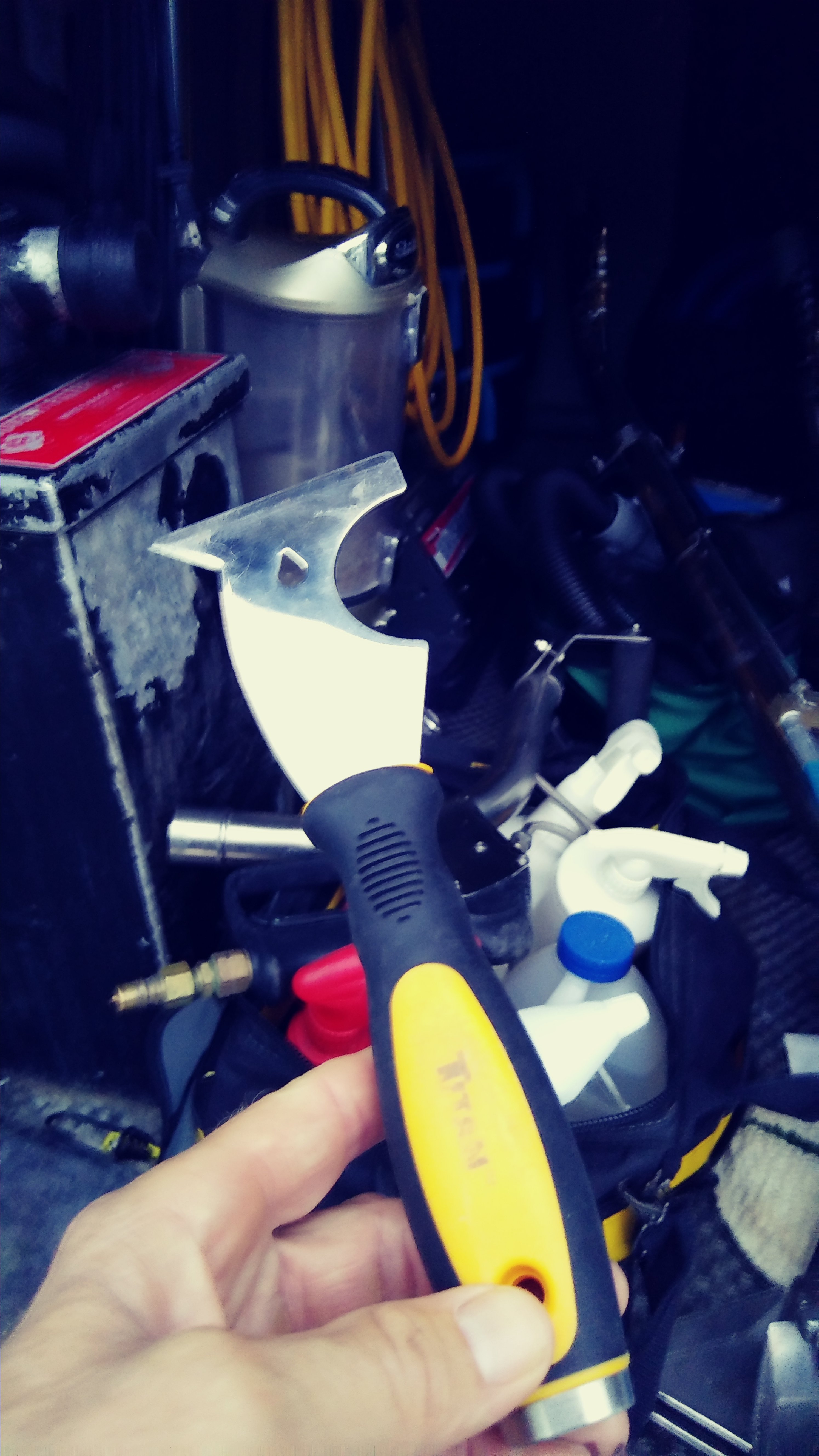

Carry a heavy duty scraper to remove glue and paint while shop vaccing.

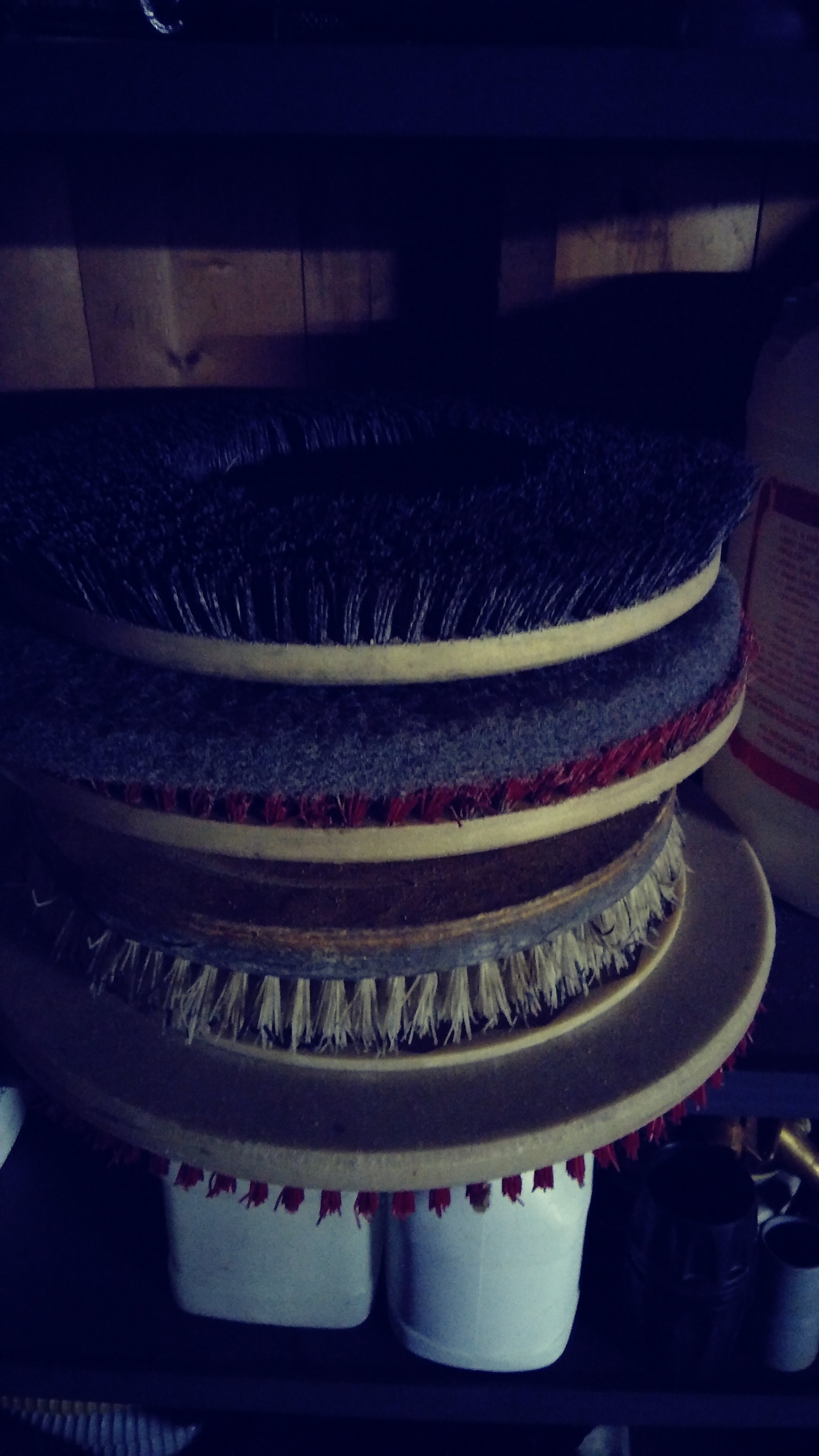

You have to scrub the crapped out it for good results.. pressure washing alone wont get off a lot of the crud..will most likely etch it as well
No you don't and I do this every couple weeks.
Spin in and wand out. Scrape anything that doesn't come out. Scrubbing is actually a waste of time from my experience. Its how we started out. Scrubbing and bucket brigade.
This method gives the best results for us. Gotta wash the hoses off afterward too but cleaning on the way in helps a lot.

And a sharp one of these.

800 on new construction yes unless that 175 is spraying and sucking. But the brushes would still load up and just spread the mess around.
