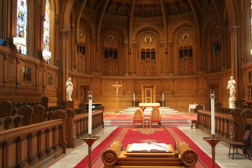

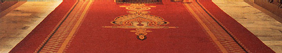

I'm guessing all wool, hand tied. The two smaller matching rugs can be cleaned in plant, we'll have to deal with the 70x12 on location
Any suggestions or concerns to look at on the pre visit?
The new manager says it's filthy and has no idea when it was last cleaned.

I think you want to spend some time doing some dye bleed testing. Review all the info in the dye bleed threads and contact some of the gurus there. Personally, I would like to try some dye inhibitor and use a 175 with a solution tank,shampoo brush with a fine fabric shampoo, maybe with a mild reducer and rinse with a cool slightly acidic rinse (5.5 ph aprox.) Speed dry with air movers.

Most likely it has tons of sand and dust. If you can (no super heavy furniture) turn it (drag) upside down and go with a beater bar or (is it dust devil?) you'll be able to dislodge a lot of sand and dust that vacuuming will never pick up.
Sweep, drag back to position and proceed to clean. You know the wool spiel. I'd go acidic, cold and potentially gently buff if needed.
