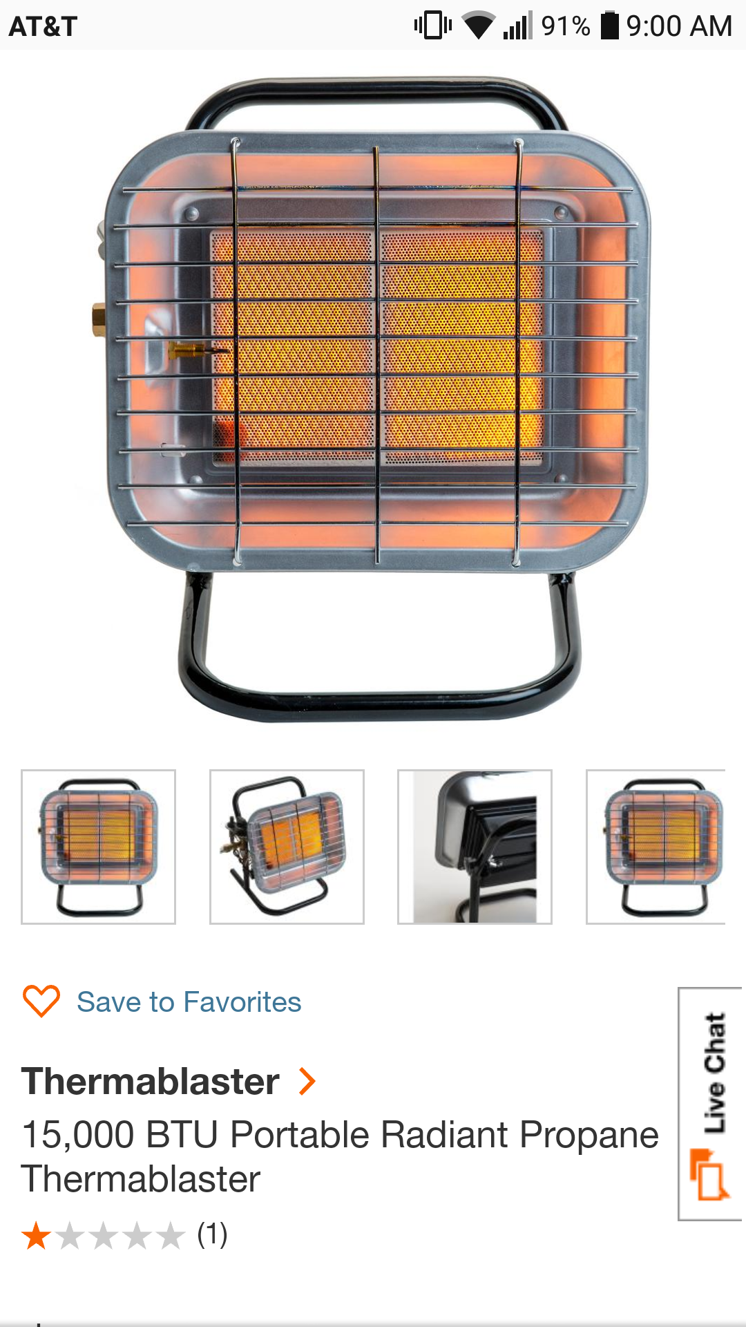

I might pick one of these up for a backup to heat my trailer. It may come in handy in a pinch. Could save me a heat exchanger.

No batteries required for this one.

The Ryobi can be plugged in or use one of the batteries. I have little buddies set up to put in my rentals They can be adapted to big tanks. It doesn't take a lot of heat to keep a house from freezing. There are some $40 heaters that clamp on the top of a tank that work great.
That will put out way too much heat to use in your van.
