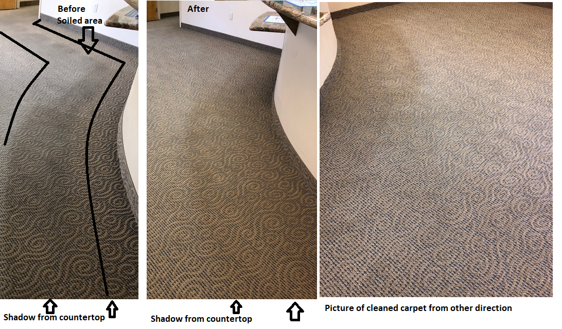

I haven't tried 175 on CGD, so I can't say. To be a fair appraisal I would need to try 175 on carpet enough to know its strengths and weaknesses.
This is b4 and after from Trinity on CGD I did today.
Dark areas on after areas hasn't dried completely. I'll go back when I get a chance for a dry pic.
