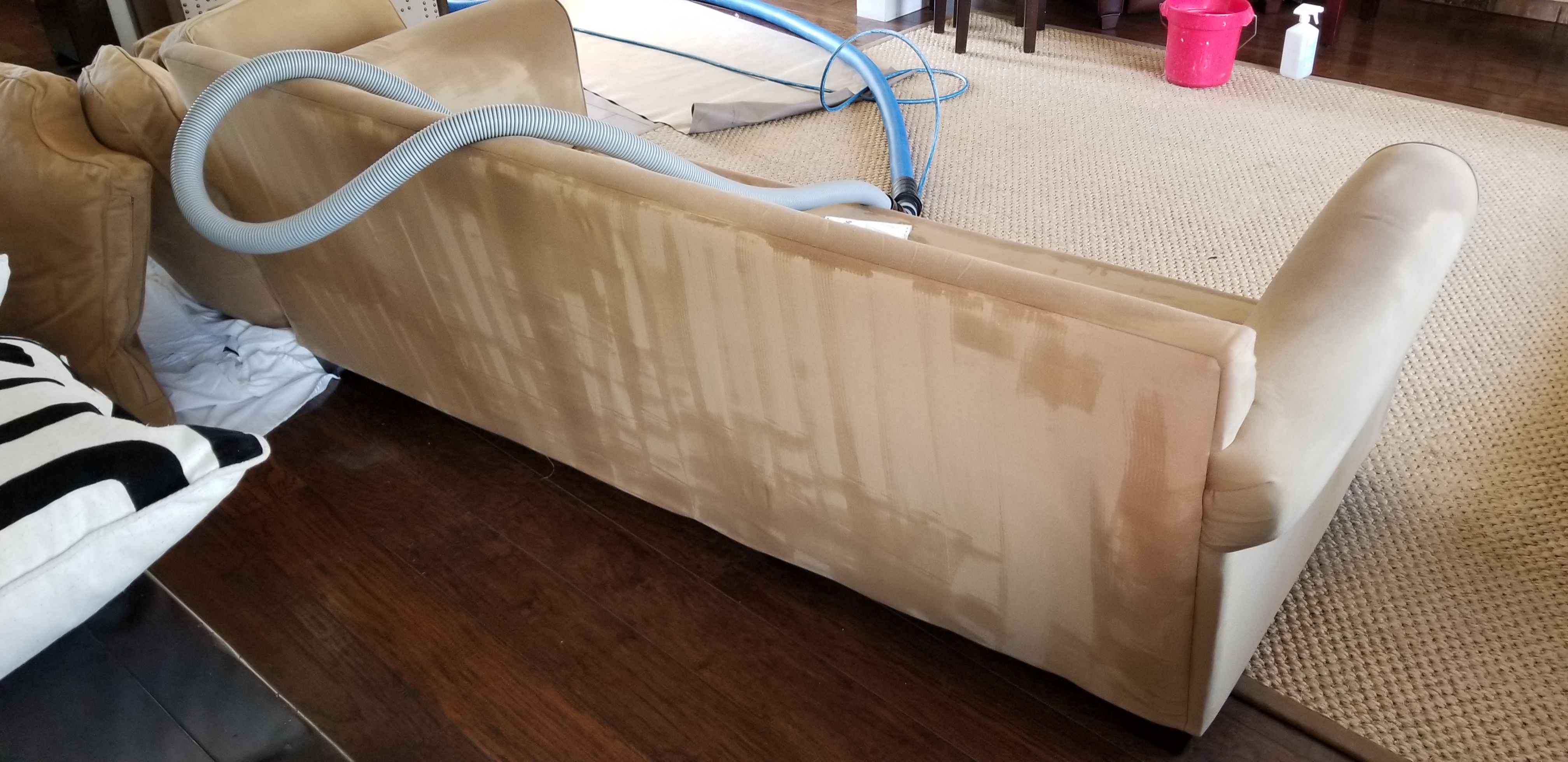

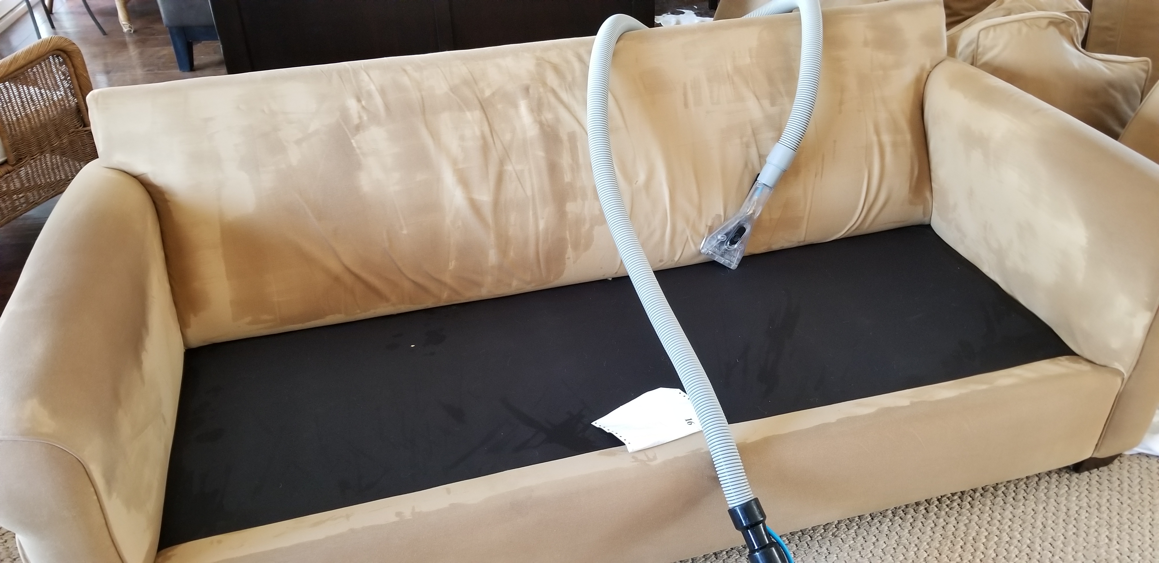

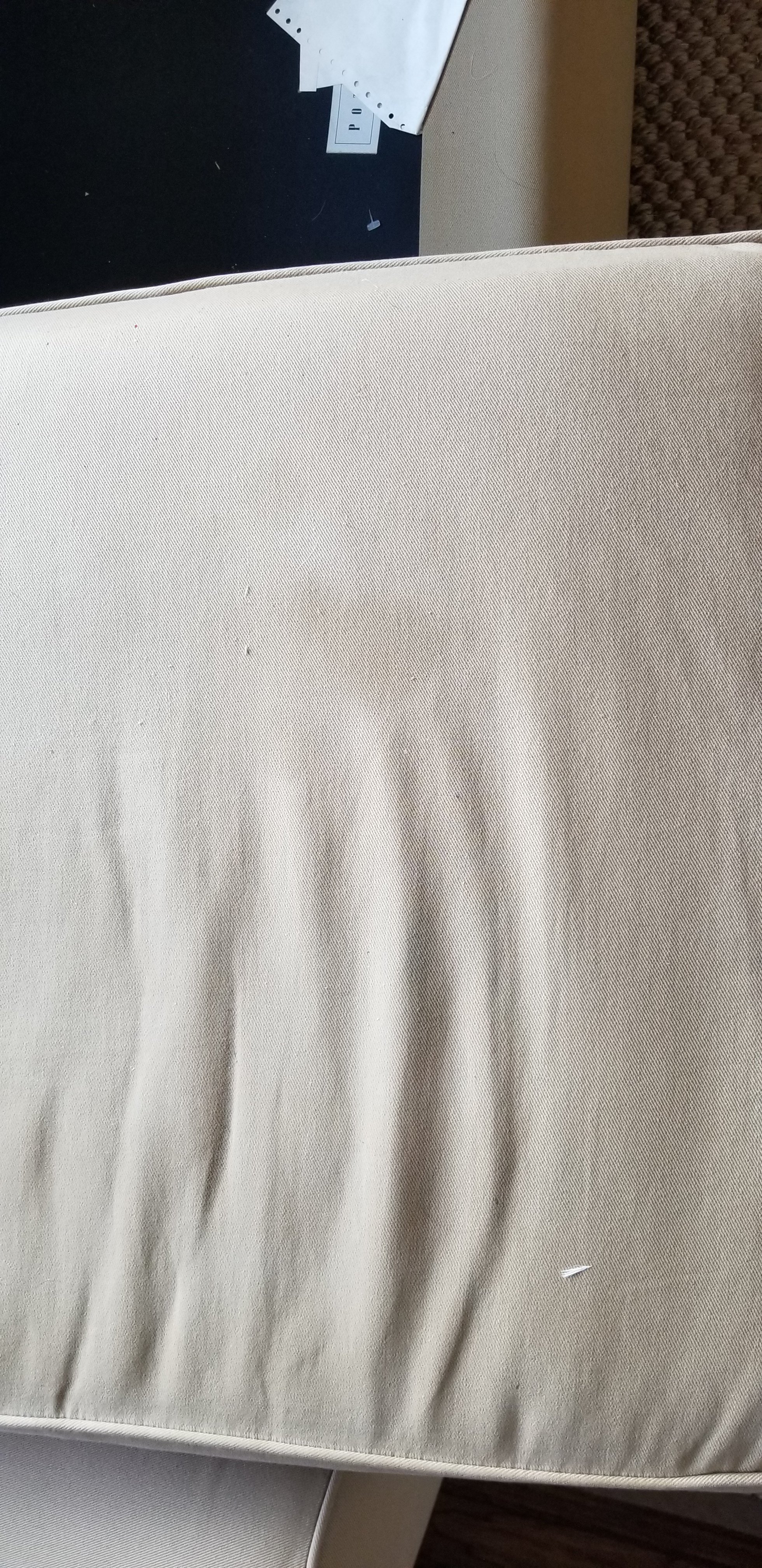

Shes in my lical B2B group.
Pottery Barn cotton of all things..

Did you cause that whitening?

That one's bad, but some PB are even worse with full skirting and fabric all over about twice a baggy as that. They market it as you can take it off and wash it but people seldom do after they've tried to do it once before...it's a project. Cleaning these sucks.

When they call the fabric 100% Turkish cotton I immediately think... So is it cotton or something else?
Or does Turkish cotton mean the cotton is going to brown/yellow like the old Tahitian/Haitian cottons. Is there viscose blended in there.
I see a lot of the Sunbrella for indoor furniture also from Pottery Barn.
Upholstery cleaning can get exciting very quickly...and not in a good way.

When I do upholstery, especially the slip covers, I use a hose cuff with 4 - 5/16th holes drilled in it so it does not over-suck - controlled air leak.
Try it.
The whitening was already there.
