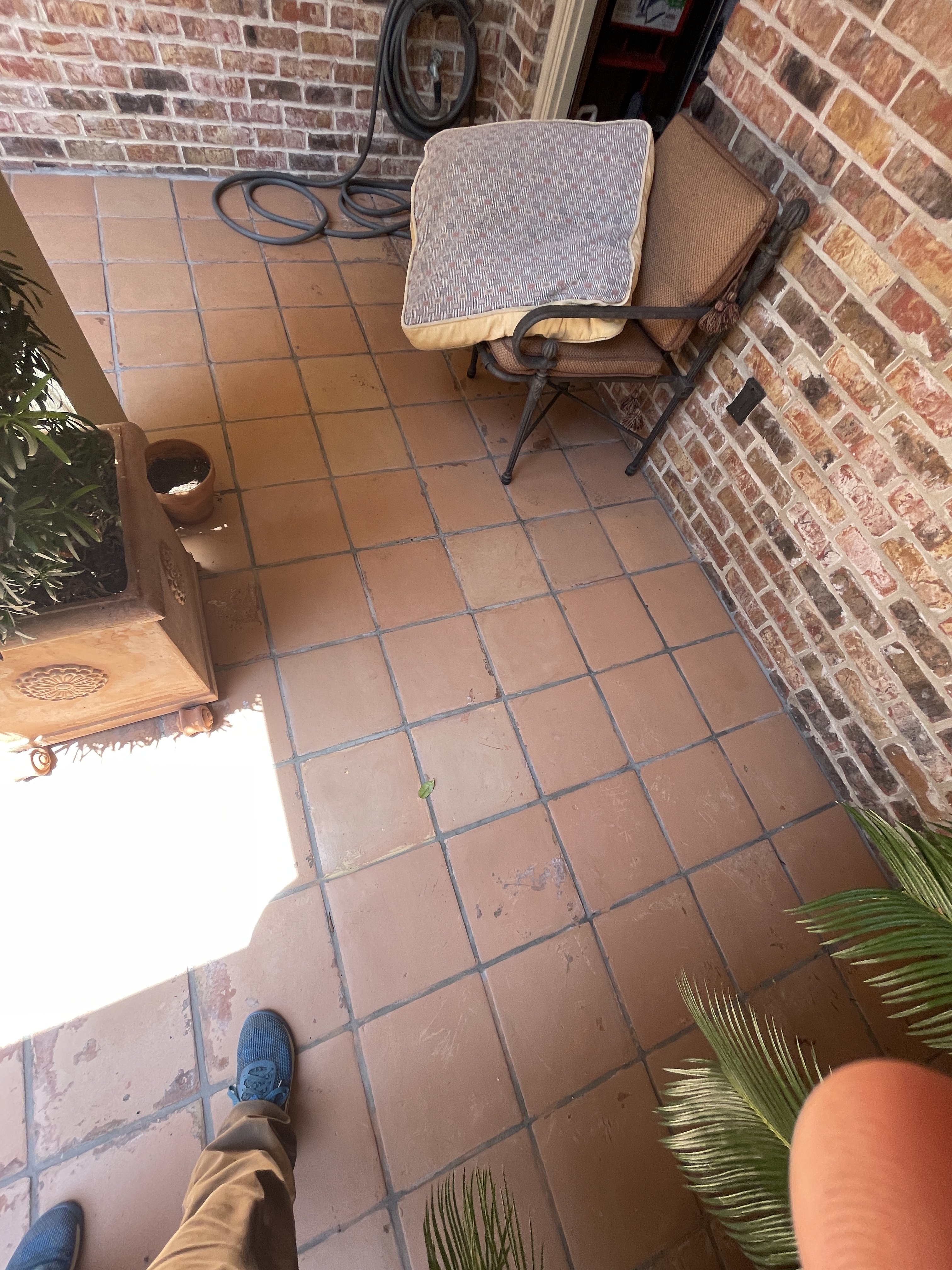

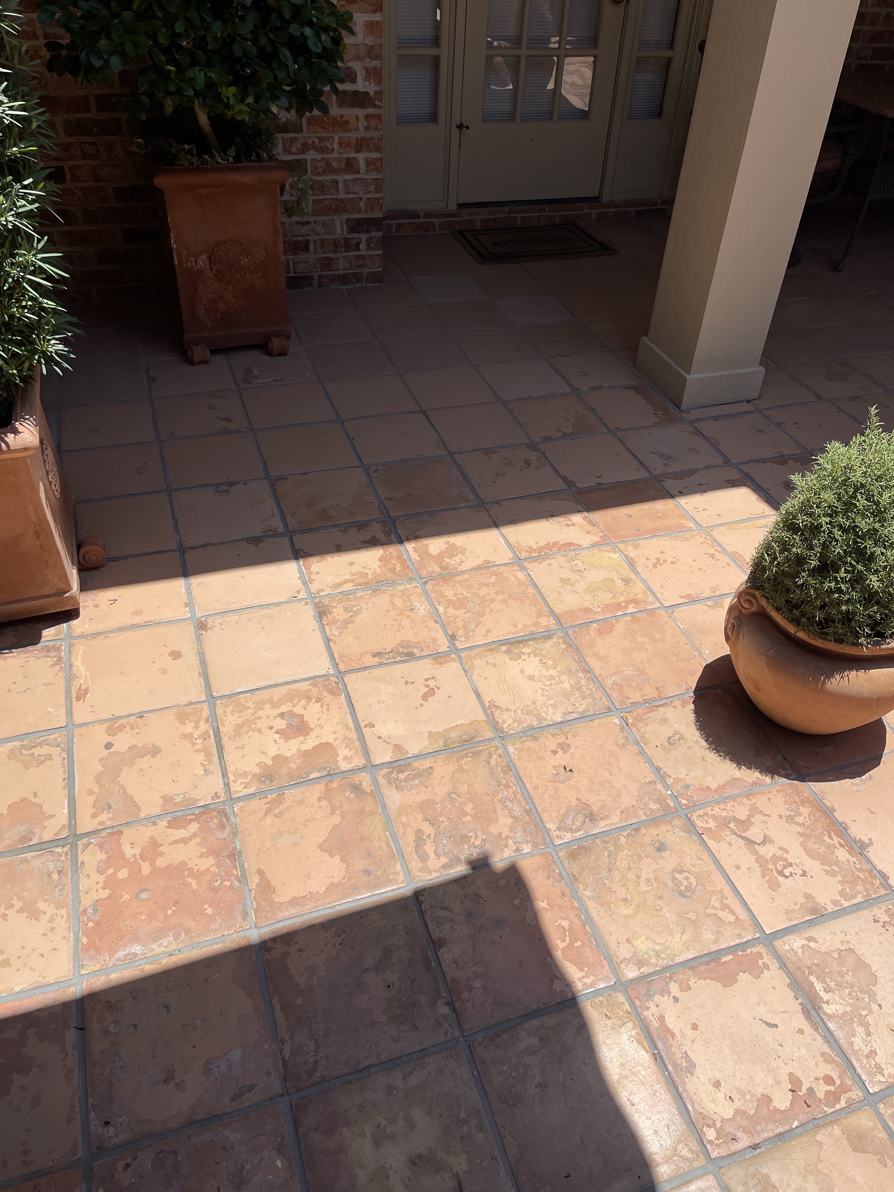

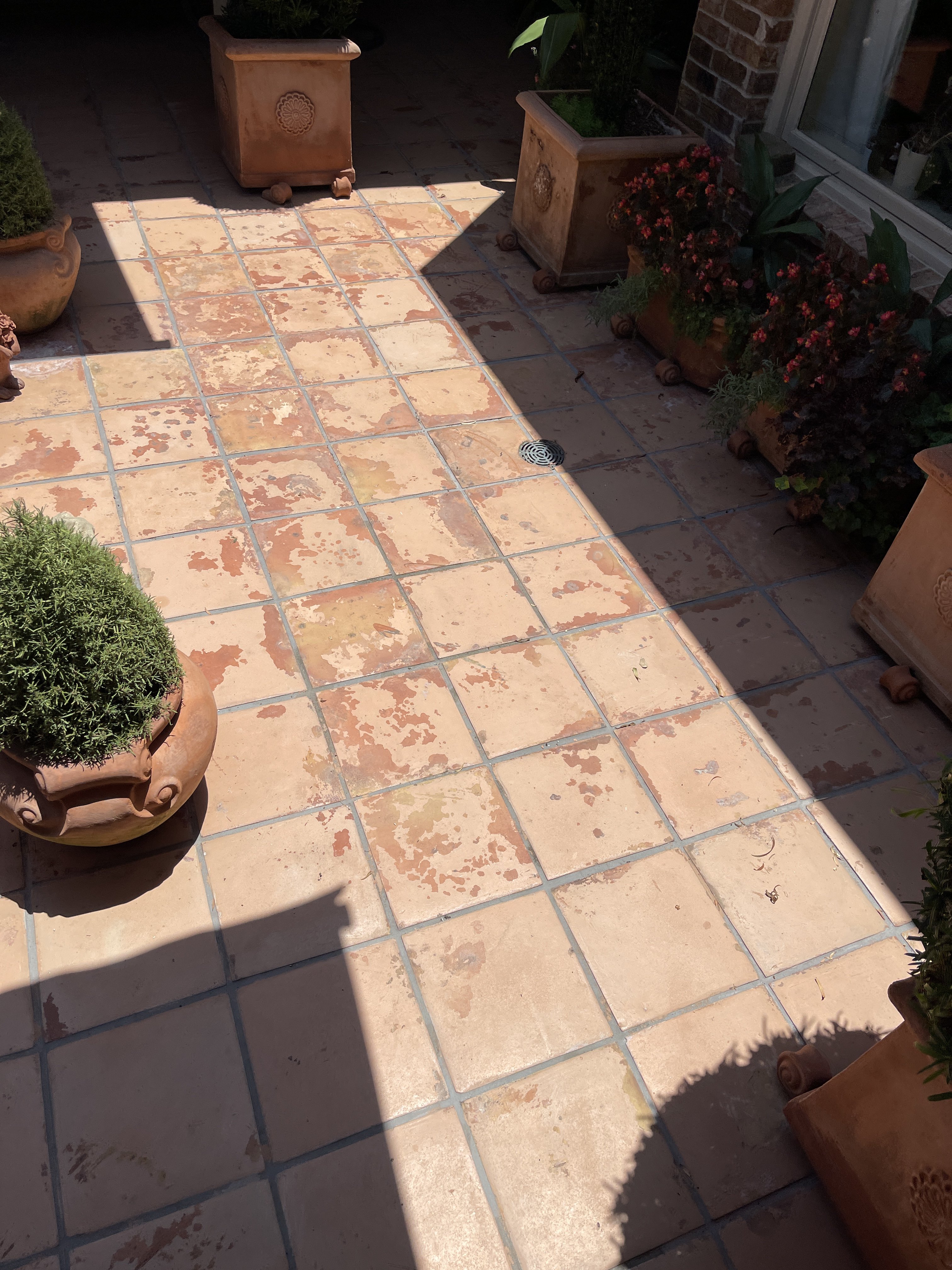

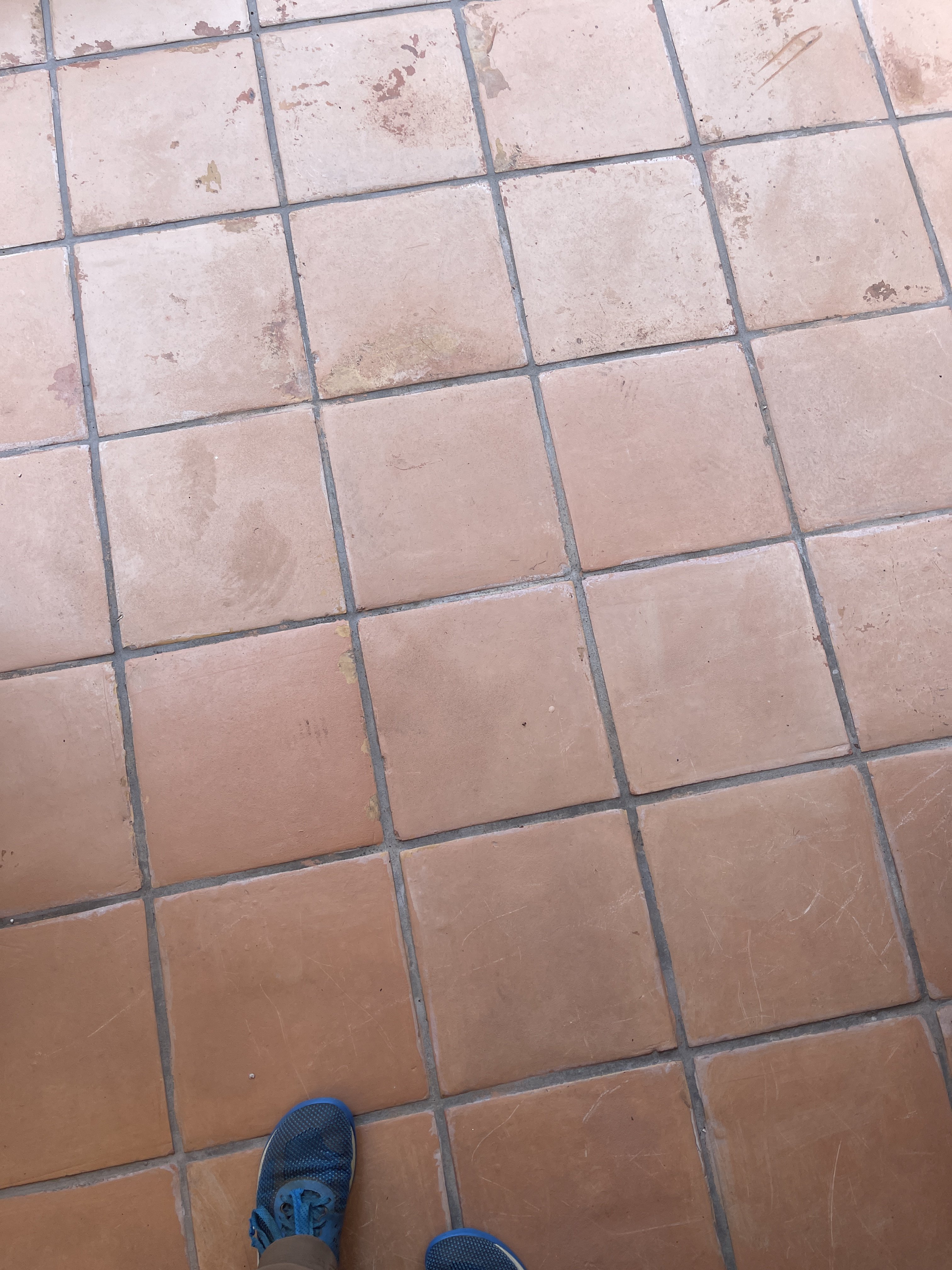

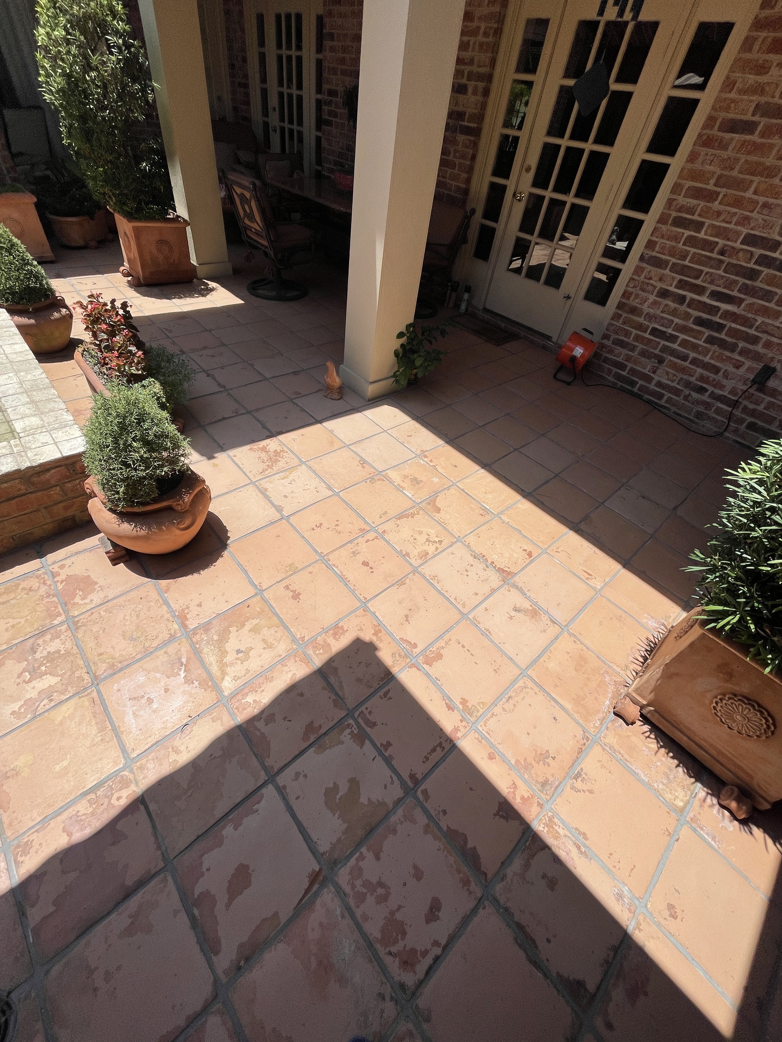

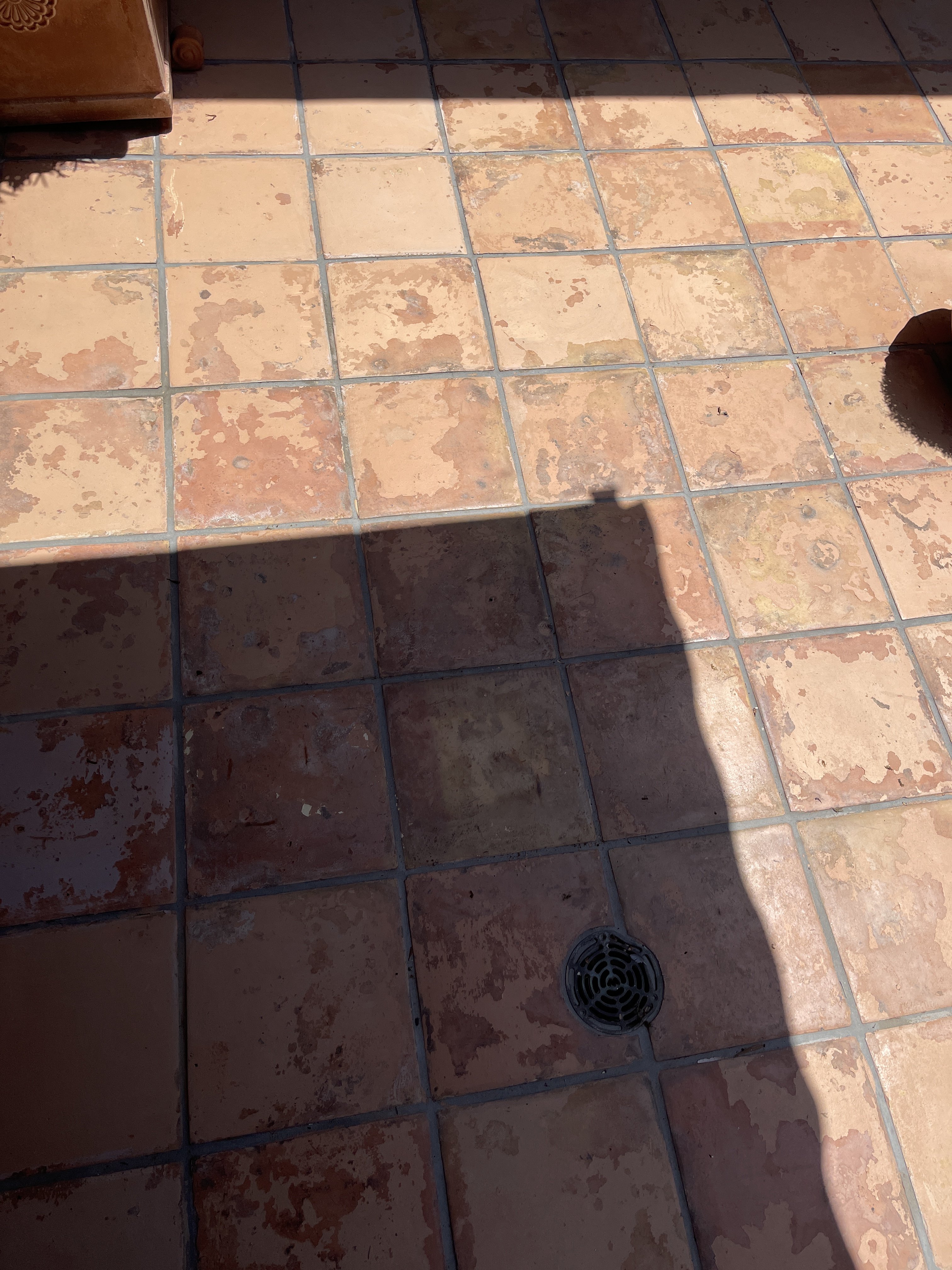

A client has a courtyard with Dhanis Mexican tile, a red terra cotta type tile.
She says it was to slippery when wet so she brought a company in and they painted it with some an aggregate impregnated paint. 5 years later the paint is chipping badly in the areas exposed to UV and the direct heat of the Texas sun.
The paint chipped up fairly easily when I scraped it with my pocket knife.
She wants to go back to the original tile look and feel. What’s the process for taking this paint up? I feel like my Trinity machine will be helpful here but this is an important client and I want to get it right.

Youll have to mask every room at least six feet up from the floor.
There's so much agitation involved. Chances are you're going to ruin whatever the baseboards are so you better be a good painter and carpenter.
If the floors ever been recoded it can take you over an hour per square foot tile all said and done.
If it happens to be a synthetic super salltillo you can expose an aggregate and you just bought the floor.
Do you have a weighted 175 and an 80 grit malish brush?
Are you familiar with how to heal it?
You enjoy the smell of butyl?
Do you have a large commercial Shop-Vac to extract all the top coat into? if it gets into your truck mount blower its game over.
You have a helper with incredible patience and to enjoys the smell of buytl?
Are you ready this great that coating off from the edges and in the corners and under kick boards in the other obstacle where you're 17 in 175 can't get into?
Are you comfortable cussing in front of this lady?
5,294
Aaron,
The customer wants a return to the original look, and that's pretty much impossible. If you want this to be a profitable job, removing the paint and restoring the the tile will likely cost more than replacement.
A more durable and less slippery choice would be a grippy quarry tile.
Or just repaint.
