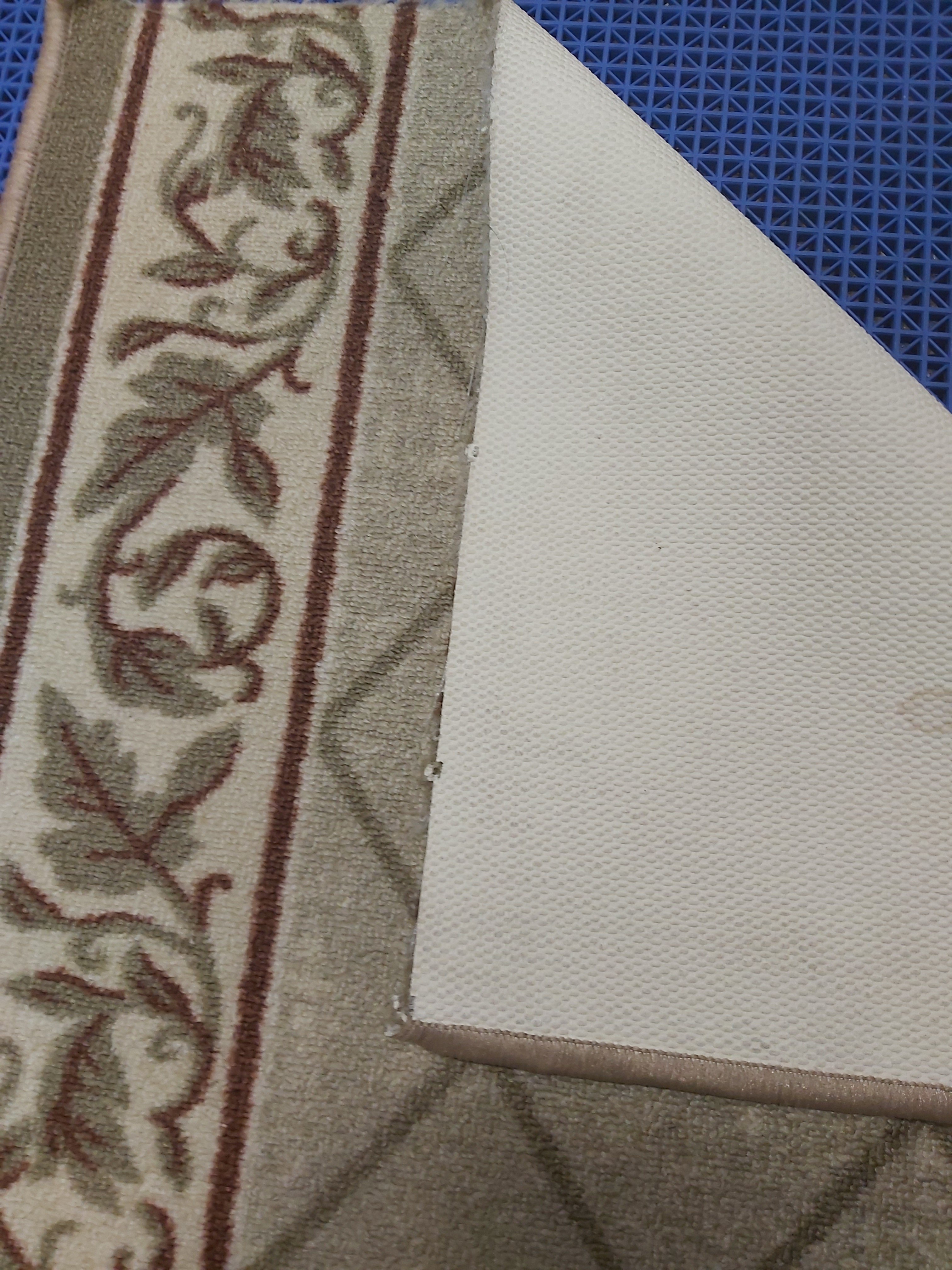

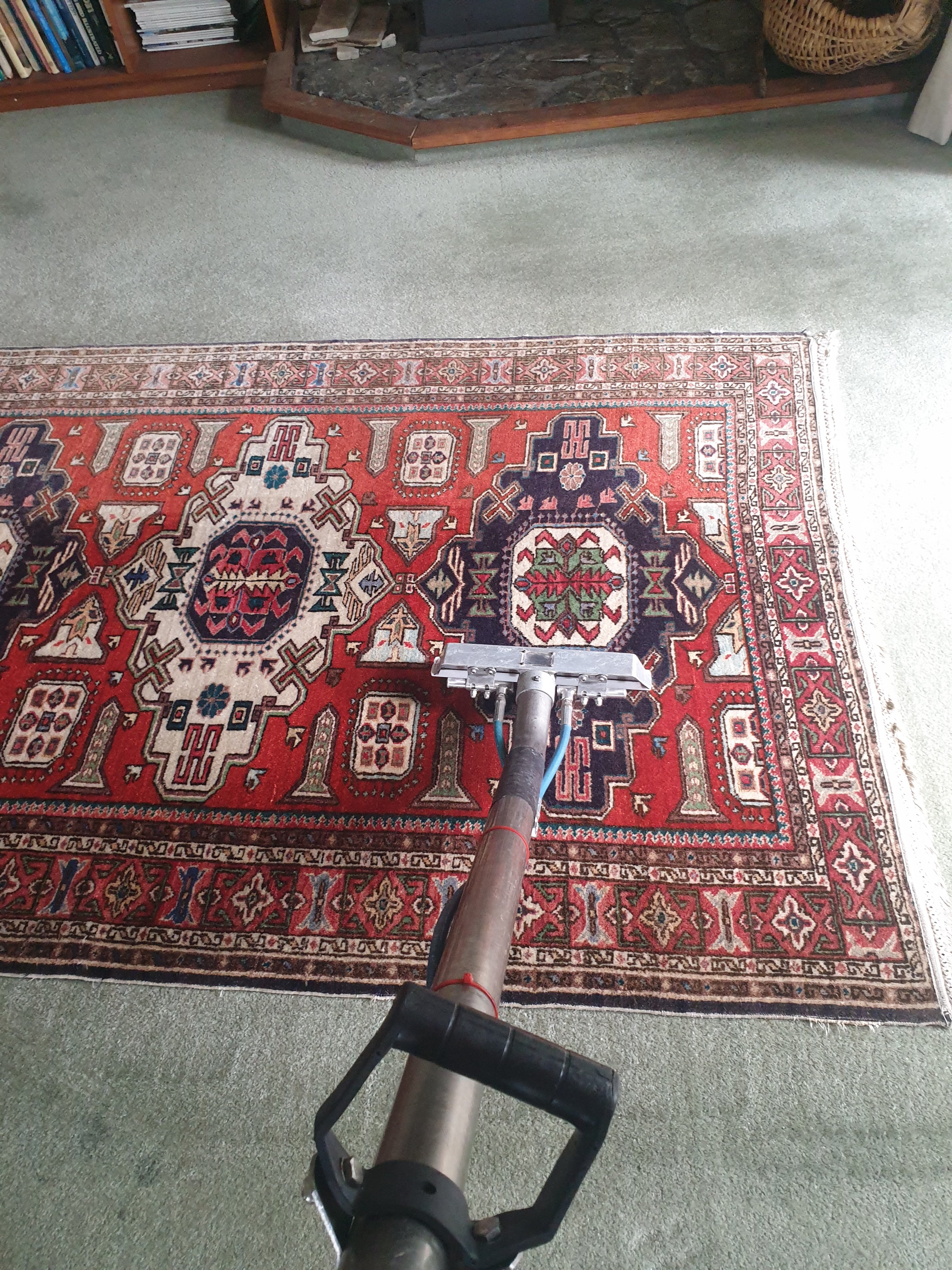

Can you ID a potential bleeder from across the room?
What about synthetics, from across the room as well?
Tufteds too?
What precautions do you use to protect the floor?
Do you accelerate drying?
Will you leave a fan behind?
Where do you draw the line?
