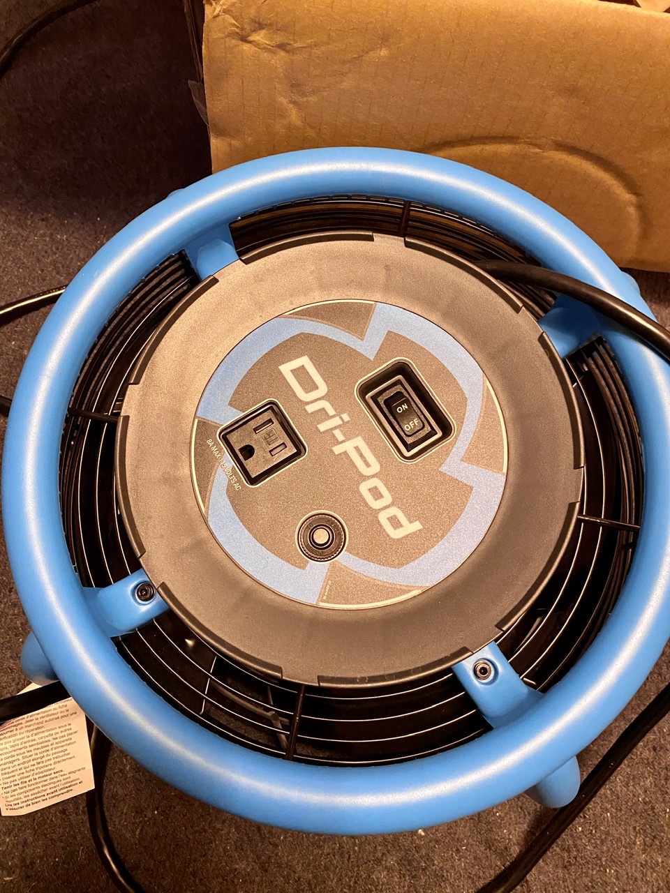

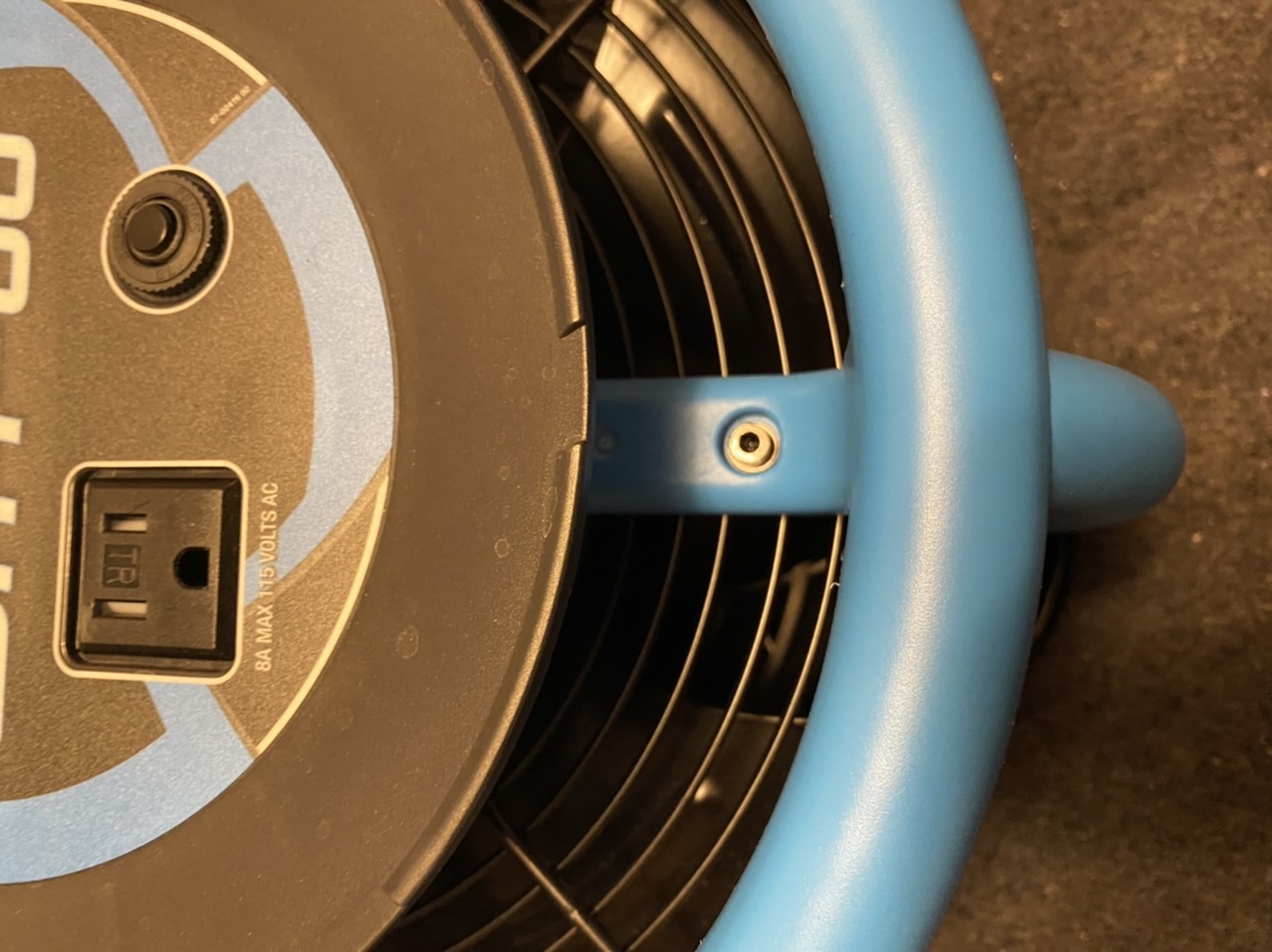

Hope they ditched the rivets in favor or nuts and bolts as well...

4 hex/socket head screws on top. 4 Phillips between the two plastic pieces. Another 4 bolts if you want to drop the motor.
No nuts..... I probably wouldn't make taking it apart a regular thing but it can be done easily
