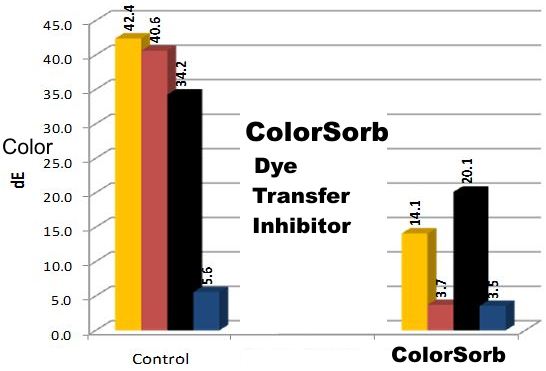

We have a new 3rd generation product to absorb any loose dye in the wash process. It is called ColorSorb and I have some testing on various colors on it's effectiveness. It reduces red, yellow & black dye transfer quite effectively. It works with anionic & nonionic detergent systems. Both anionic and direct dyes are absorbed.
http://www.cobbcarpet.com/zen/index.php?main_page=product_info&cPath=65&products_id=5424
