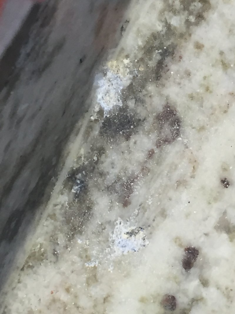

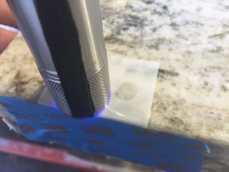

It can be used for that, but I would recommend an epoxy. The FillaChip is designed more for cosmetic repairs on the face.
Here is FillaChip used on a granite top. Some shaved ape did the job, proving it is nearly Coastie..
I mean a monkey proof process.
