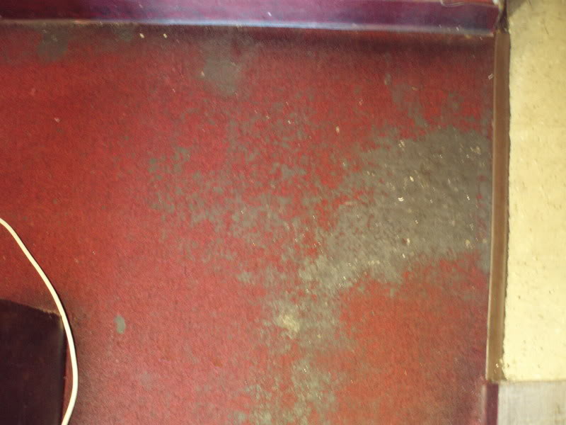

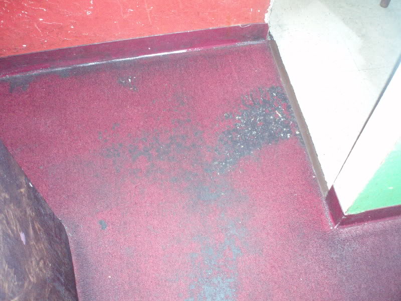

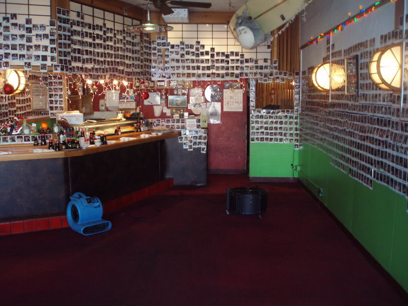

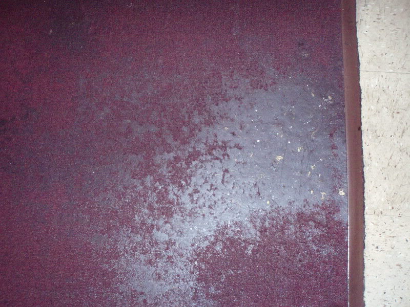

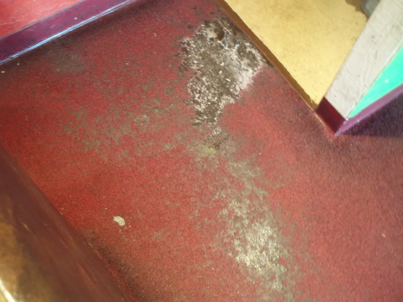

10 mounts since we "cleaned" it last.
Kitchen entry, hold the wasabi

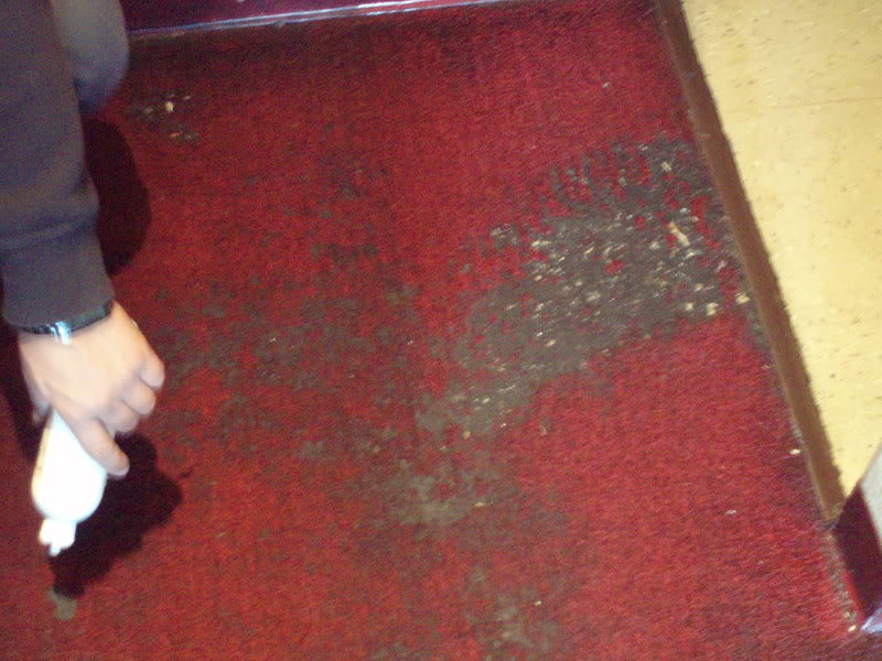

So tasty you could eat it with a Pocket Bushmaster.
Pre spray icing.

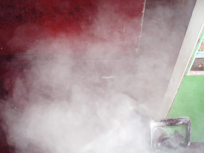

After a good Purple Powering & Green Padding which did next to not.
Top layer came off exposing more shrimp and mac nut
But eventually 250º got it out with 30 slow passes.

I clean a restaurant on a monthly basis with the same problem. At first I thought they may have a water leak, but then I learned it was from the kitchen help pouring buckets of water on the kitchen floor to scrub with deck brush etc. and then mop. Water would get on the carpet before it was moped up. I have to extract the carpet in a small area with a claw first and then clean.

One of my regular accounts had a grease slick like that. I didn't get too fancy, third month in it was gone. Came back a little each month, but I have been able to keep it at bay now. Every 3rd or 4th cleaning I have my helper monkey get down with a bone scraper and scrape the build up at the edge of the tile with some gel break and flush it out.

Be a man an take the damn glide off. go to costco and buy a gallon of degreaser for 6 bucks and for Gods sake clean the damn edges.I cleaned greasy chinese restaraunts four over ten years before i got smart and fired them all.If you take the glide off you wont need fans to dry the carpet.My jobs looked just like yours and my tm put out 170 degrees you know this is not rocket science. There is no excuse for not getting a carpet clean and being the guru of this industry you shoud hang your head in shame.Love you keep up the good work. :wink:

When it comes to the "ICE CREAM SCOOP" style nastiness in front of the kitchen, I take the glide OFF.
You just need that extra agitation.
Then re-attach the glide for the rest.

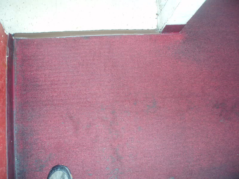

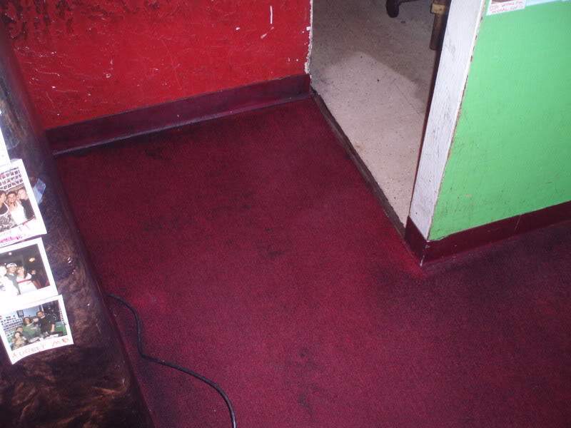

Are you telling me after looking at the 2nd to last photo that I didn't get it clean?
Zep Purple Power was used, did you over look that too?
