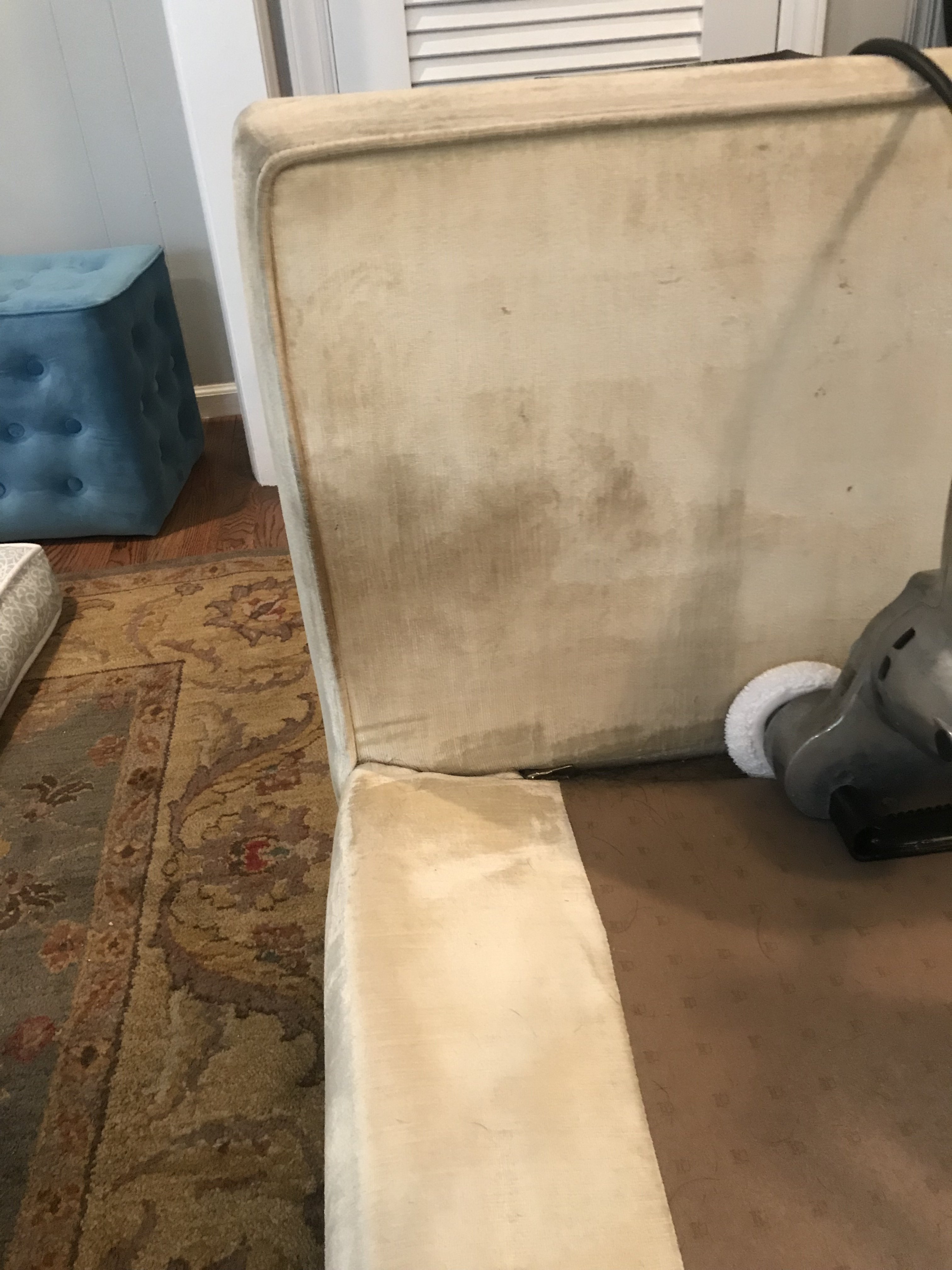

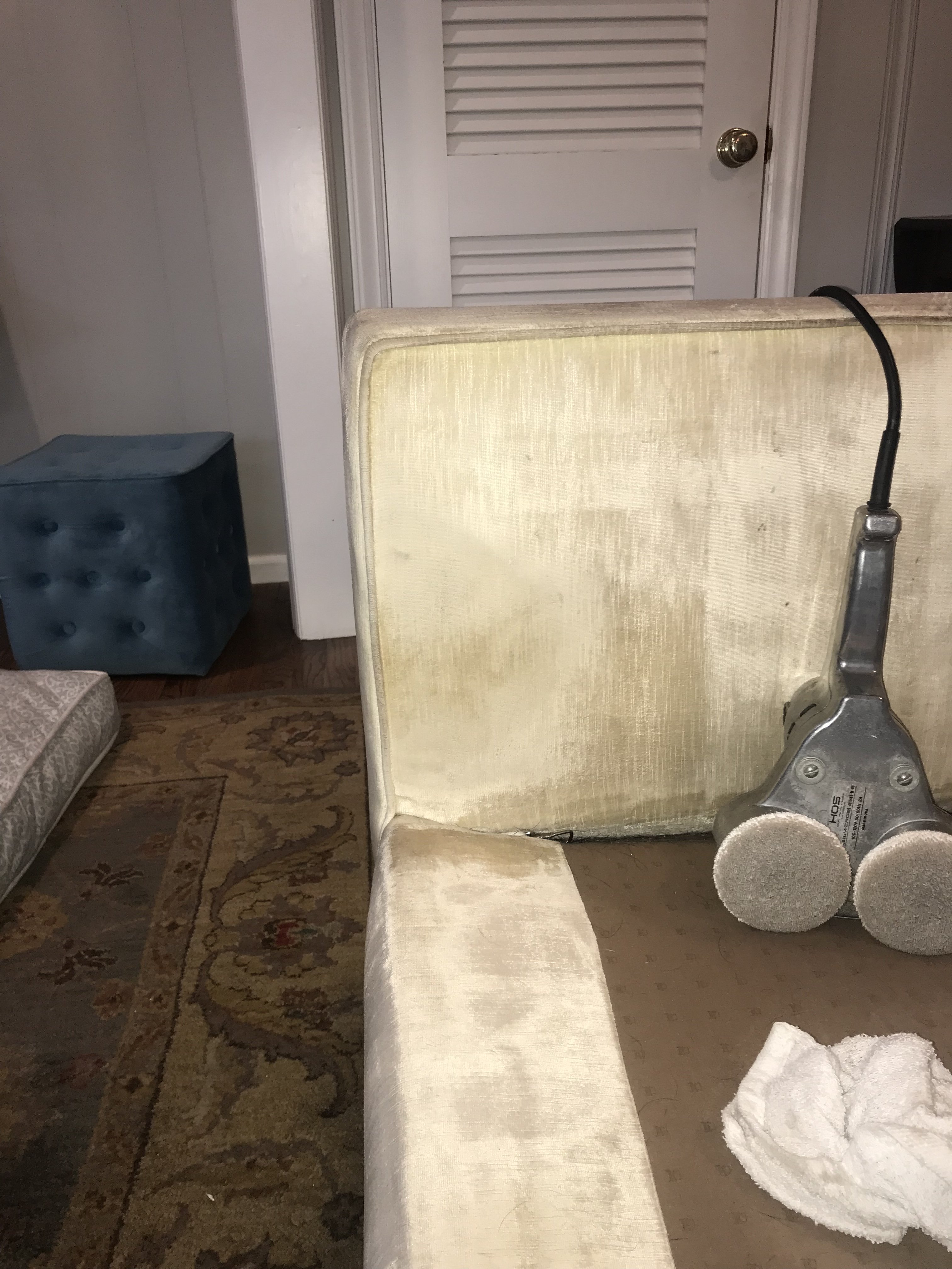

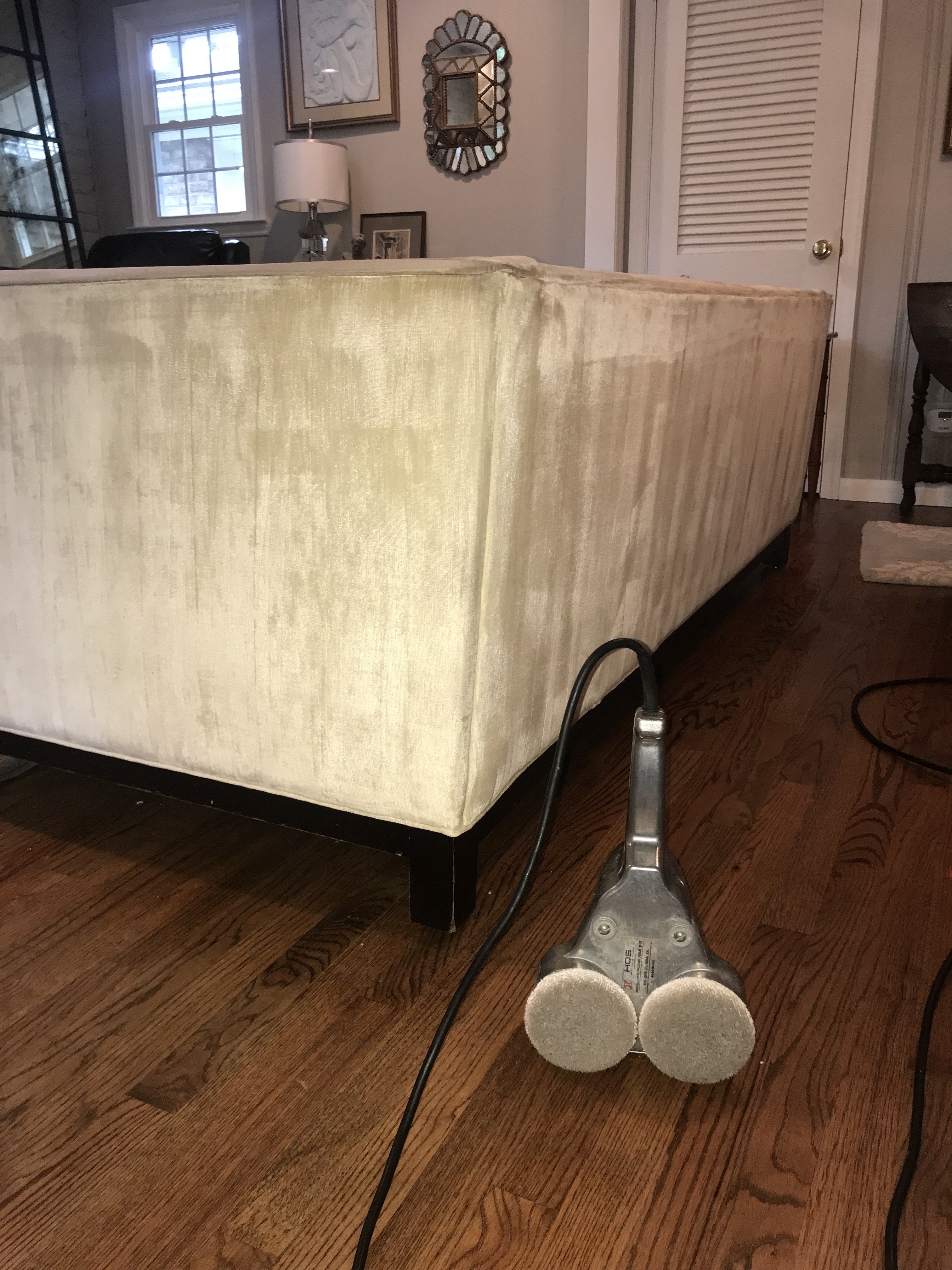

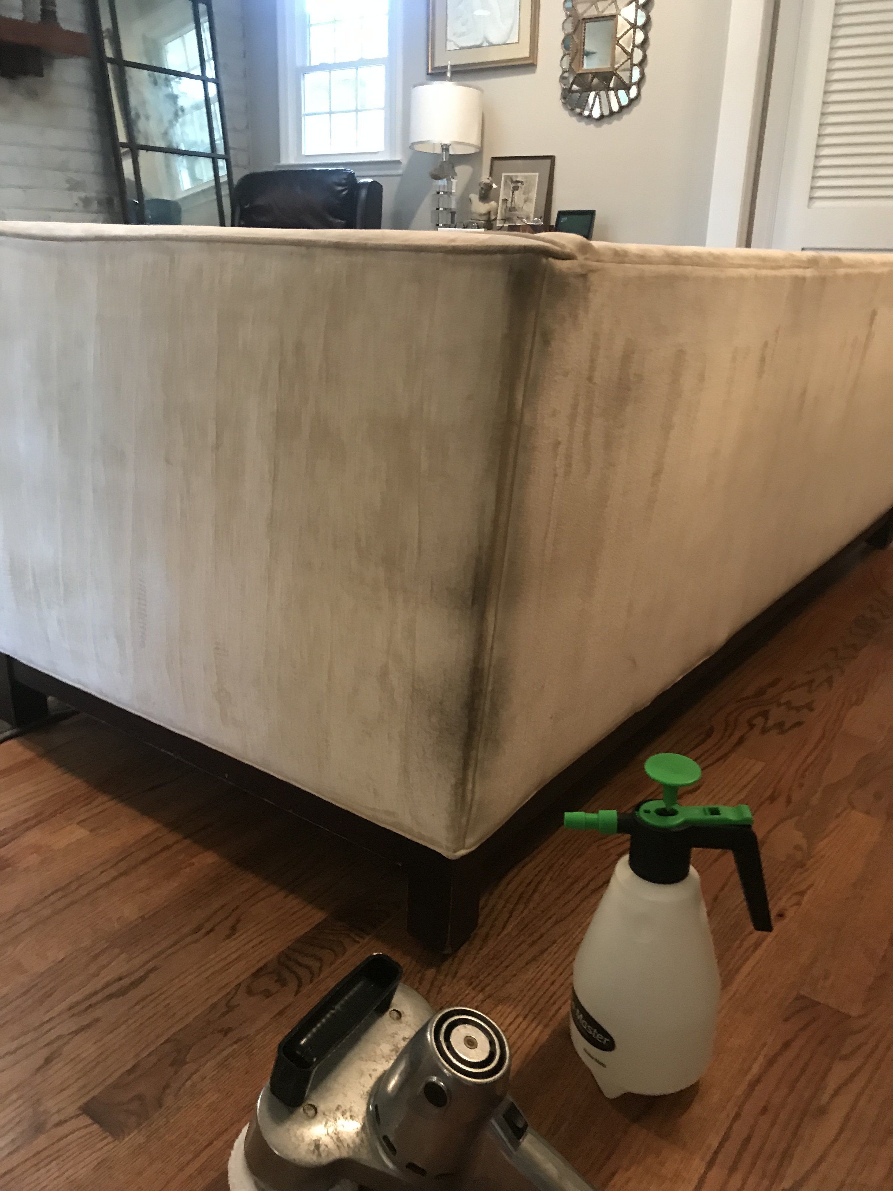

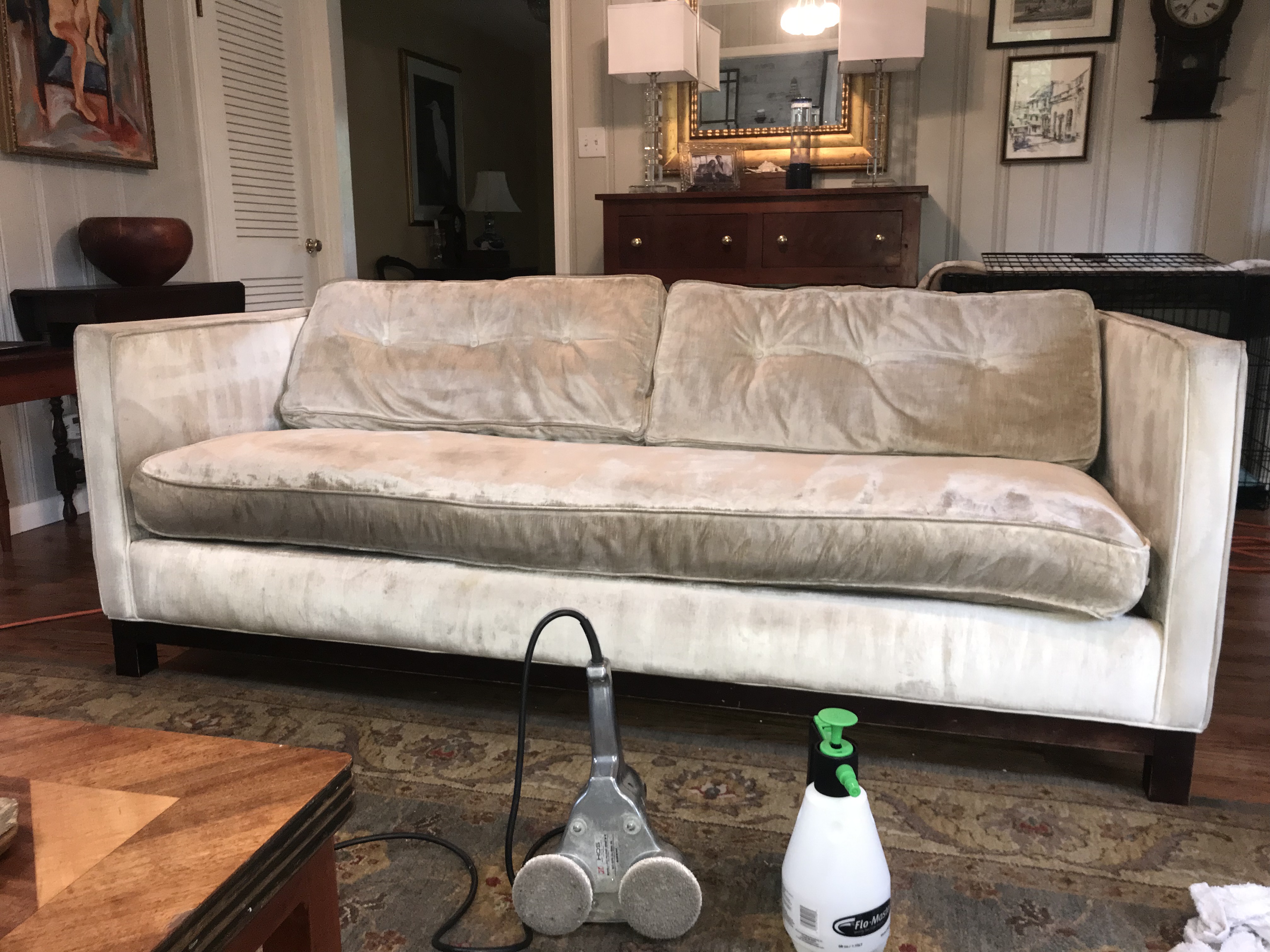

Just my Orbot Micro, Releasit DS2 and a rag.
Black Lab + White Sofa 😮
8A632485-0BCB-4E10-B2D1-D40ABBC65BBC.jpegDDA6D3AB-CCCC-4B6E-88DE-B4A535A5978A.jpegD8B5A643-6E64-4ADF-AA16-2475A66D7100.jpeg905D75D1-3DA9-4A8C-8465-718602E28FBA.jpegDA8E0653-B8A6-42F9-BA24-DC17488AA7B3.jpeg

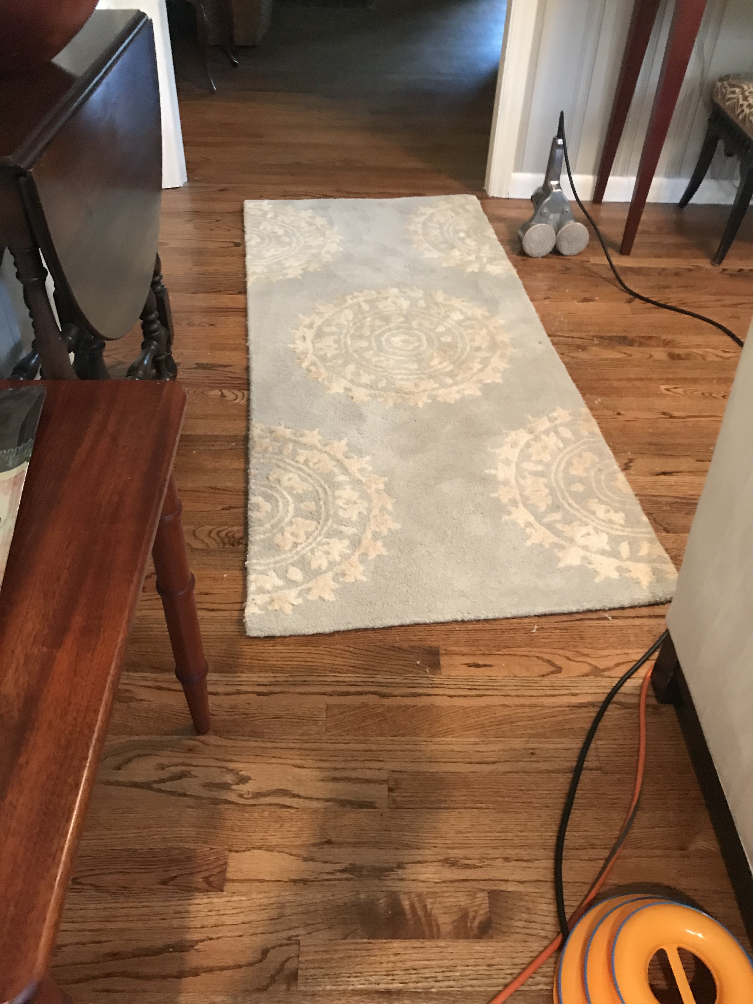

Then I buffed the hallway runner on the way out the door.
