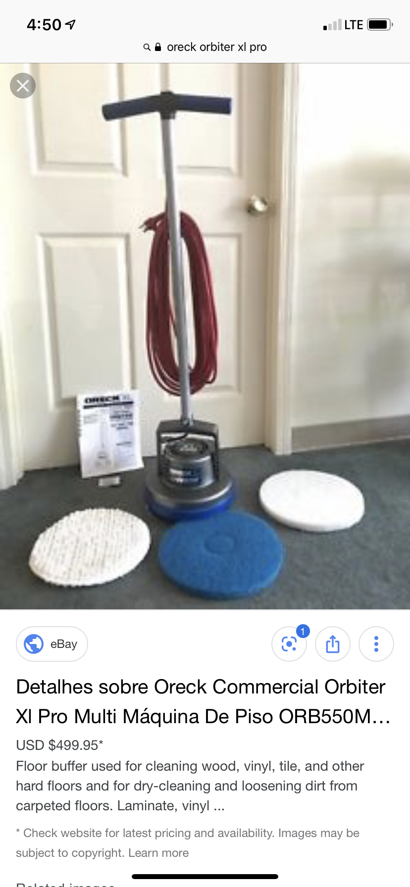

It sounds lighter and more maneuverable than an oreck. I like the idea of switching between a brush and pad. The price is about the same.

Get the oreck orbiter and if your going to use cotton or micro pads then take the t-hooks off the oreck's pad driver ( they will rip up your pads) and replace with velcro, you can get some at wal-mart in the craft section get the industral.
To clean the stairs with the oreck start at the top, you'll be standing up straight looking down the stairs with the machine in front of you, lower the oreck to the first step clean and let it roll over the nose of the step and clean the nose, step down to the next step and repeat. this way there is no bending over or getting on your knees.
