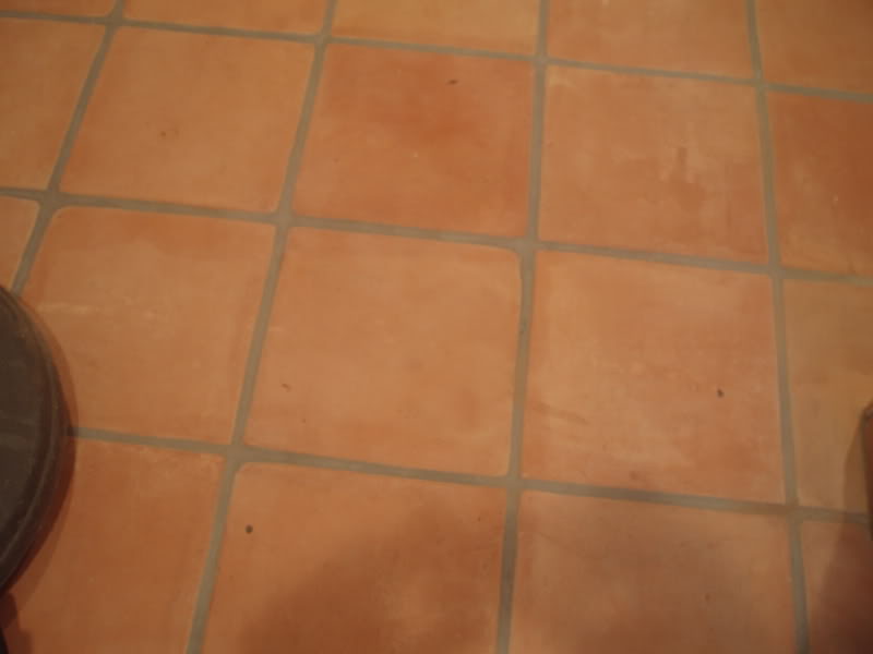

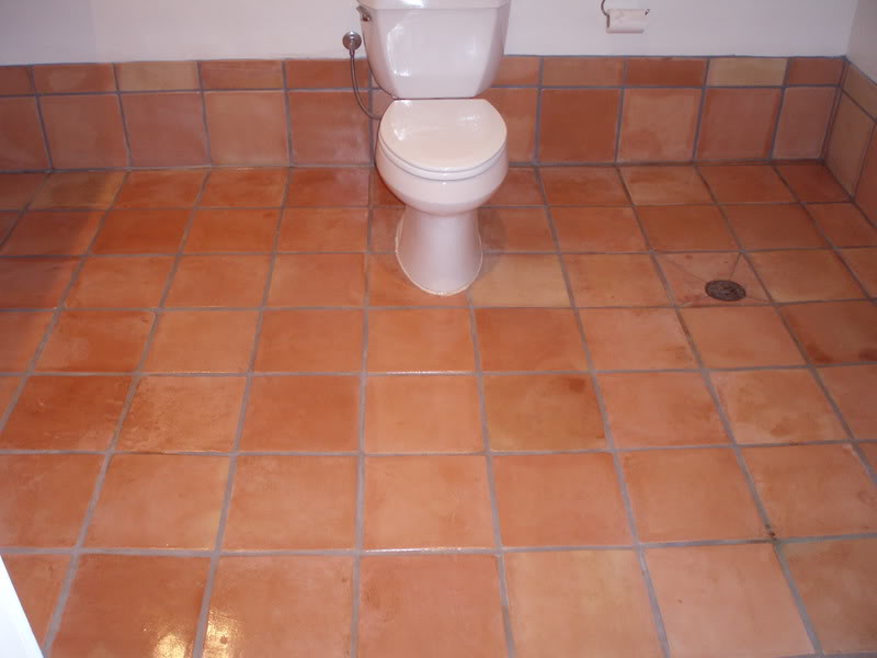

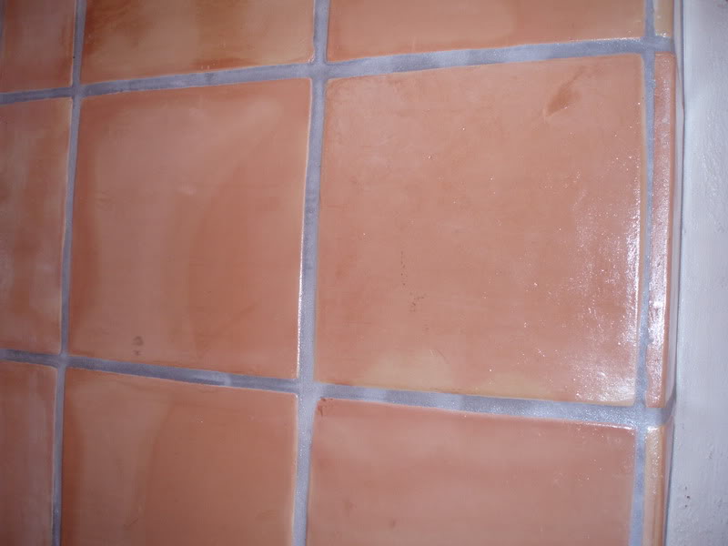

Nice even install with only one coat of some jive acrylic.
700 sq ft.

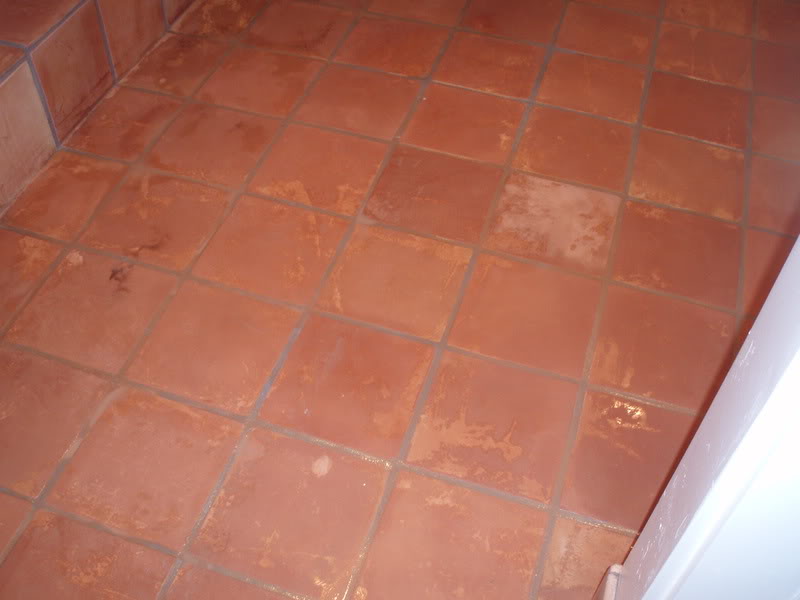

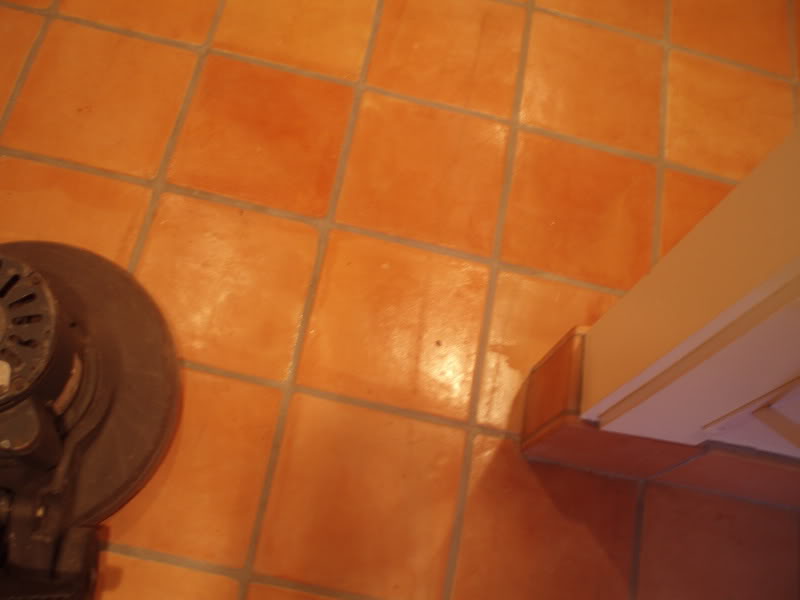

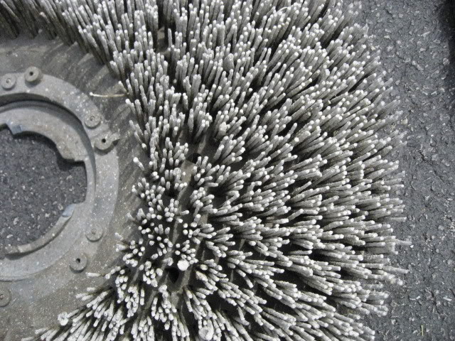

We were able to remove 85% of the sealer with just the dry Nylagrit brush I got recently from Jon Don.

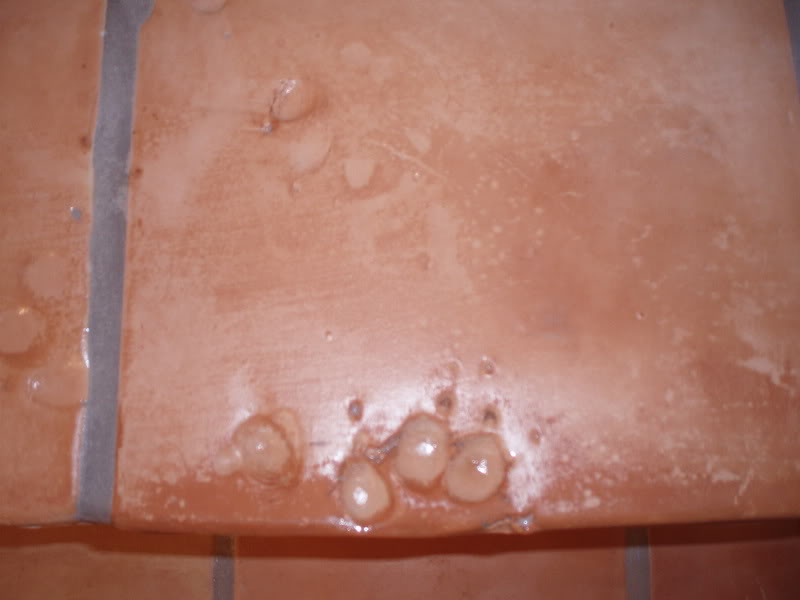

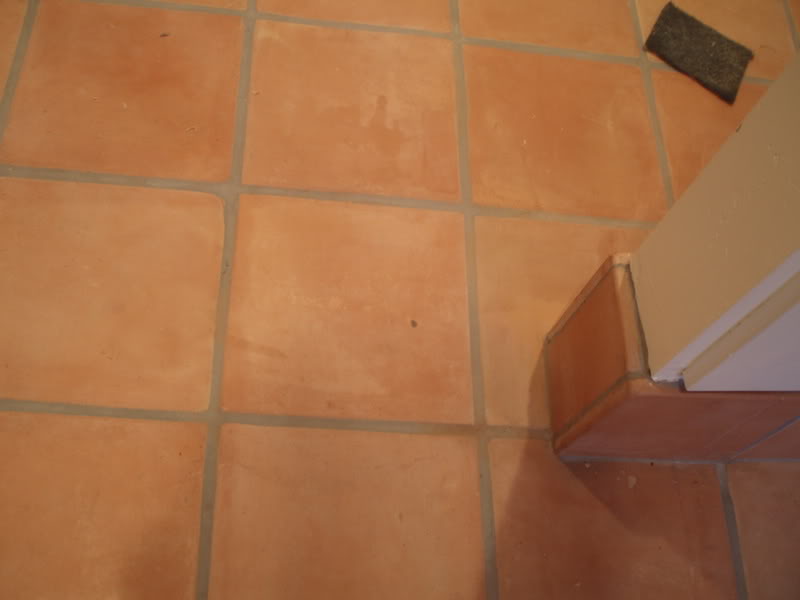

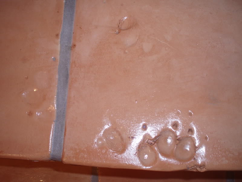

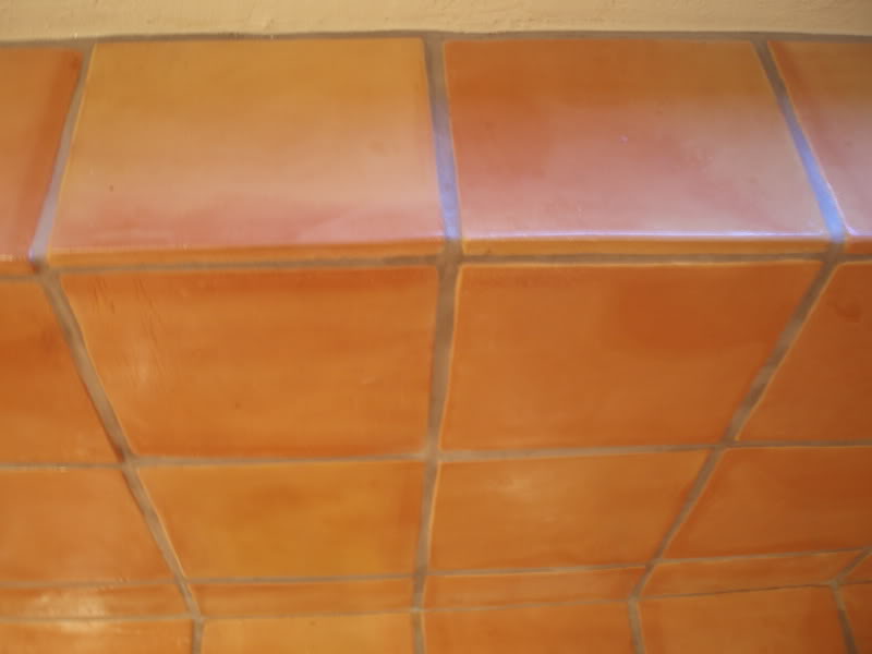

Notice the peel seal near the base board
Gone!

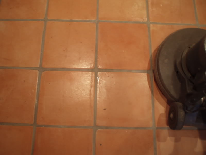

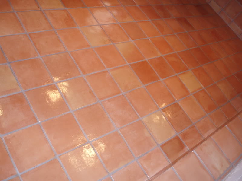

Shiny...
Not shiny

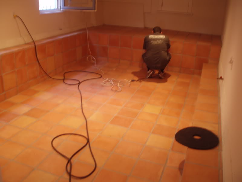

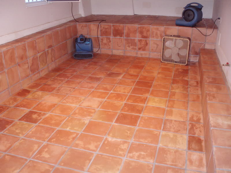

Taking it off the walls

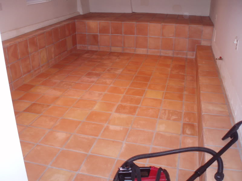

Stripped and drying
I'm going back tomorrow to seal her up.

Have you guys used those on any other hard surface for scrubbing?
These cimex brushes I just got, suck. Looking to go with a little nylo grit action for these dirty commercial joints.
117,270
Concrete, brick and maybe the Lucky Dragon that's gone for 12 years w/o cleaning are the only things I would think that thing is safe on.

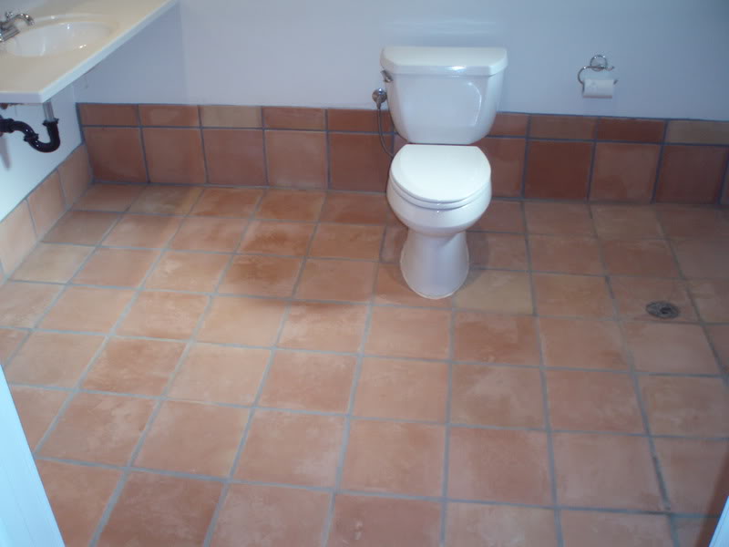

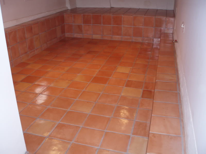

Went back today to find it nice and dry and ready to be sealed up.
After one coat of a Pre Sealer..
and after 3 coats of wax
Look ma, no drips!
