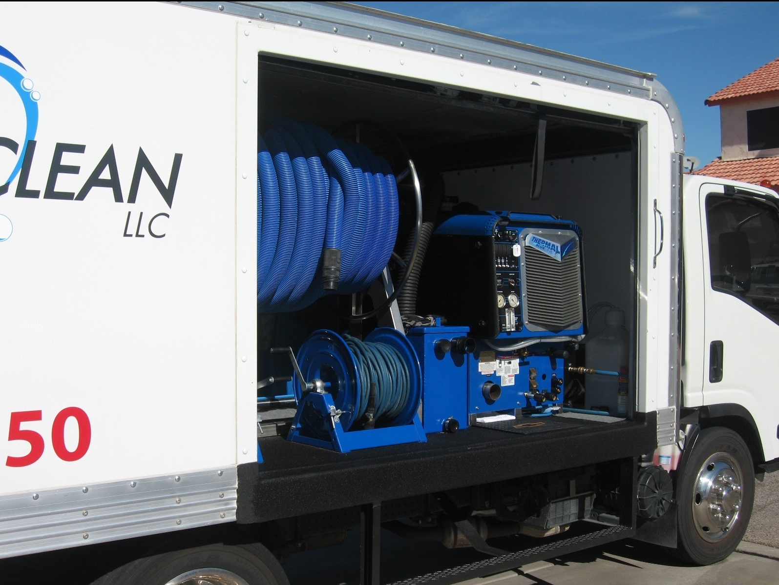

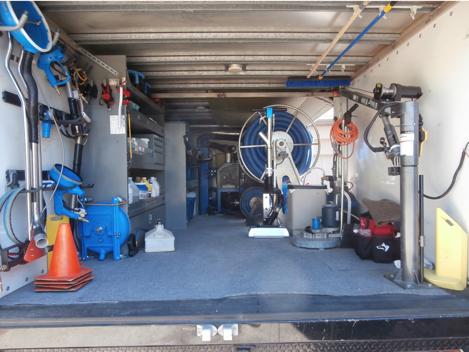

I talked to the guy who bought me company about a week ago... And this old girl is still working hard with minimal problems... Could have built almost 2complete set ups like this for 80k..
