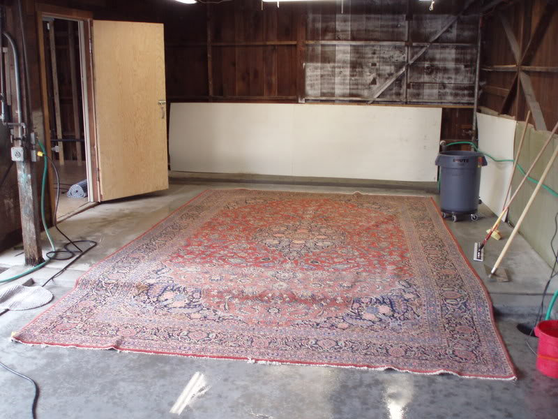

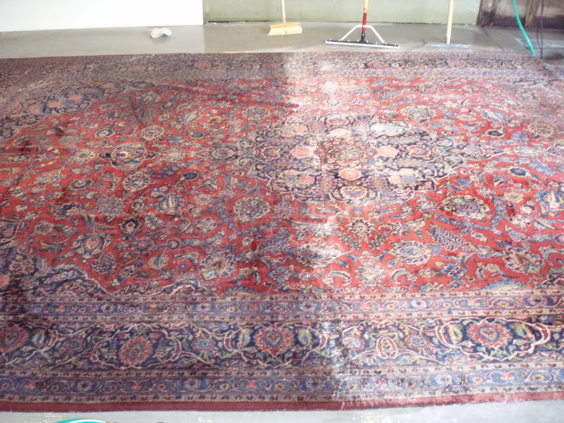

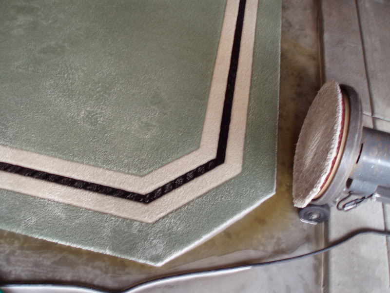

First full day in the pit.
115,966
Good lord but that's a lot of work.
12 rugs, 10 wools, all were very dirty.
Lots of trial and error, blown fuses, vats of urine, more water down the drain than I care to think about and I'll admit it, some frayed nerves.
Dust, vacuum, hose down shampoo, squeegee, flush, extract, groom and hang to dry.
What took me 45 minutes a rug Ken Snow does in 4 minutes.
I need to speed this up.
I would have to charge $22 a foot to clear what I make cleaning wall to wall.

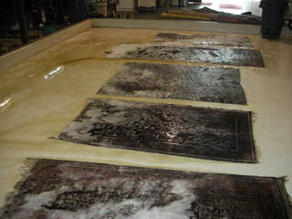

OPPPS! didn't anyoneone tell you that “BIG MONY IN AREA RUG CEANING” requires big work?
This is one of life’s moral cross roads like when a guy finds a wad of cash in a couch give it to the custy or keep it. You can’t get a reasonably used dirty rug clean in 10-30 minutes they need to be soaked out, flushed and worked over until the water runs clean. You can however shampoo, extract, the surface of most rugs leaving a dirty foundation the client will never know about and stick them as if you really cleaned the rug which many rug cleaners (most) do.
I think I said before make your wash slab as large as you can it's the only way to speed up the process and do a really good job most of the time I’m washing 3-5 rugs at a pop instead of washing one rug for an hour it's 3-5 truth is some rugs take a day to wash washing .... i'm not even talking dusting.

You have to start somewhere, and I think you started with a logical setup. Once you consistently clean 10 rug per day you might want to make some changes. You can either keep expanding your wash floor and hire more staff, or invest in some labor and space saving equipment.
PS: Be careful immersing piece-fabricated rugs like the border rug. If it was put together with heat seaming tape and spent any time soaked those seams are prone to coming apart. Likewise, a glued-on backing will come loose.
