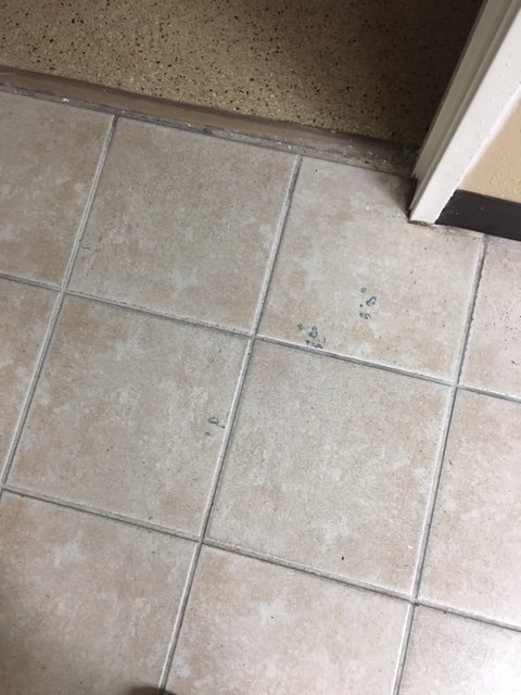

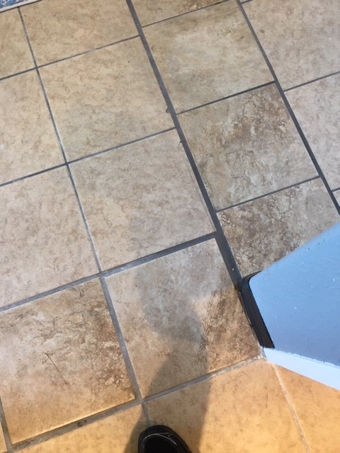

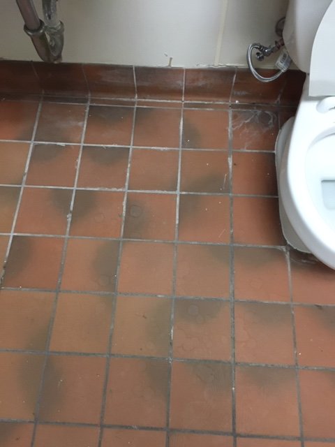

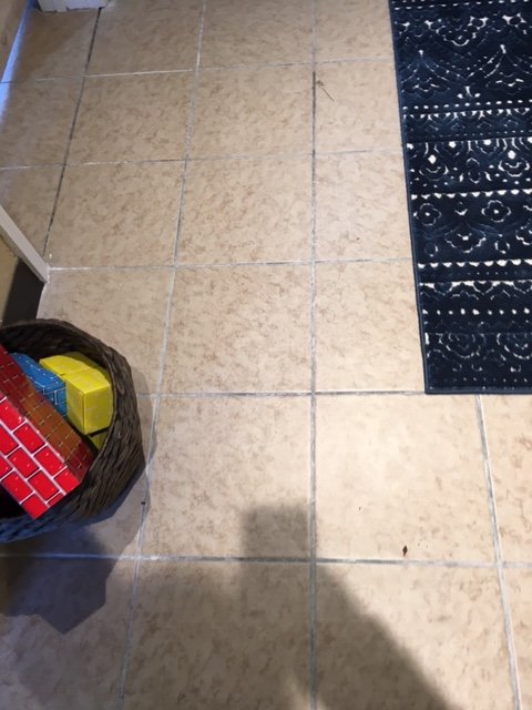

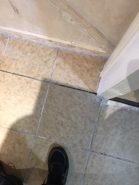

Did a tile cleaning estimate today. Included are pictures from the inspection (potential client has some construction going on).
The tile and grout have different conditions going on. Advice on cleaning would be appreciated. I have a Trinity Phoenix MX, a CRB with black brushes, Anamoly, Viper Venom, Simix, and various pads, a shop vac, and a Rotovac Ranger (extractor) with 5" tile wand and a Rotovac 360i.
The red tile is in the bathrooms. The rest of the tile is in other areas. Half of the floors are covered in Pebbletec like a garage floor. I think the cost of the Pebbletec helped them decide to have the tile and grout cleaned.

Any advice for the red and beige tiles. The grout also.I didn't mention it, but I also have so Simix.

Tony, plan on several iterations. There will be part that cleans right up and bits that may require paint stripper to bust old finish.
Be patient and meticulous. It will be fine.

No. But set expectations and go in first with floor stripper. Let them know it will be a process to undo years of accumulation, not a simple event. See how it goes. You might even go over with a small bottle of floor stripper and test to see if it is effective. See if the buildup needs to be scraped with a razor blade and so forth.
