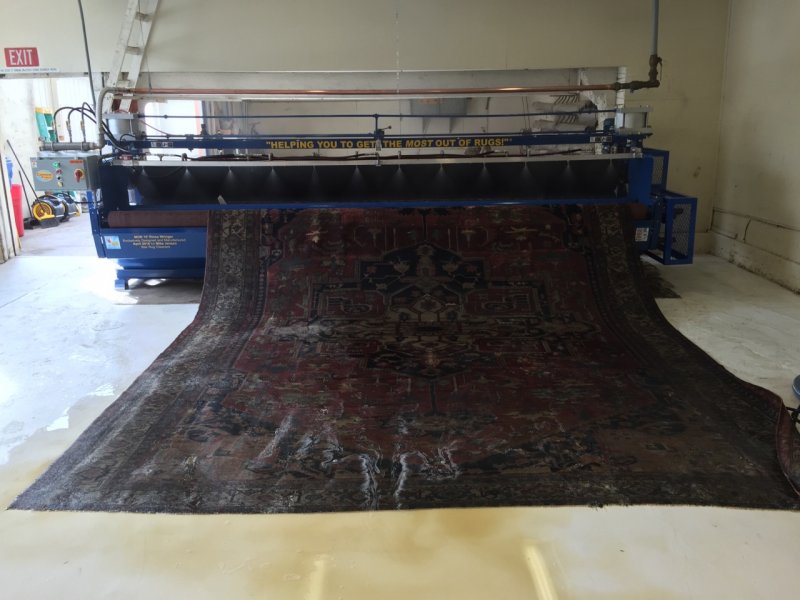

Hey @T Monahan what was the usable size and price tag of that machine you showcased at Hagopians this past Rug Summit? I understand everything can be built to order... I'm trying to get a ballpark figure I need to budget for...
What we are looking at here is a 16 foot basic Rinse Wringer. We make 13', 16', and 19'. The bells and whistles create the cost. A 13' Rinse Wringer starts at $125K and the other machines that are bigger with more add-ons like Hagopian's can exceed $250K.
Note: Above unit was made and delivered last year.
9,756
Ok, I got it... The small one was just a demo/mini version of what you could expect? Thanks Tommy!

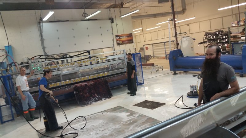

This is the most current MOR with a linear motion jet spray. This 16' machine is a wash wringer at Joe Gabel's
9,756
Joe's one is a sweet setup... I'm still in awwwe of Roberto's wringer... That was 35seconds to run it back through in reverse...
Time saver is an understatement...! I understand now how fast and efficient a wringer is...
I'm going to protest at work until I get one...!
