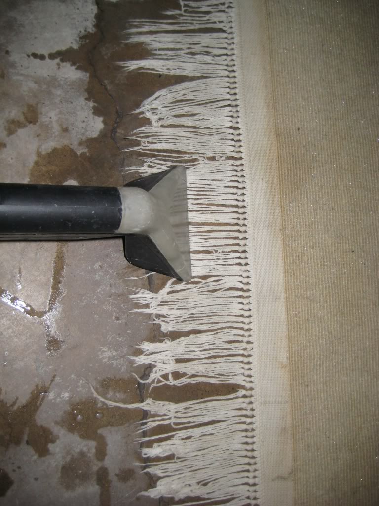

With our process, for real dirty fringe, we mix 2 oz Boost all , 2 oz Buff all, 4 oz of shampoo to a gal of hot water. Spray an acid on the wool just above the kliem to help prevent color run and scrub by hand with a fairly stiff brush. Then rinse with an acid based rinse.
We also explaine to the client during the time we pick up the rug what to expect their fringe to look like when we return it. If it has vac damage or previous bleaching we explain this before hand. I let them know we will very seldom use a bleach on them.
We also will use procyon if needed. I have had some good results with it using it the way they recomend..
85% of the time we just heel our 175 and scrub the fringe the same time we are shampooing the face fibers and follow with an acid based rinse.

Yes, a good scrubbing with some of the products mentioned above cleans quite well.
And the haitian cotton different formulas do a good job as well and are already acidic.
However, how do you deal with distortion + opening (or un-twisting) of the fringes as a result of the scrubbing??

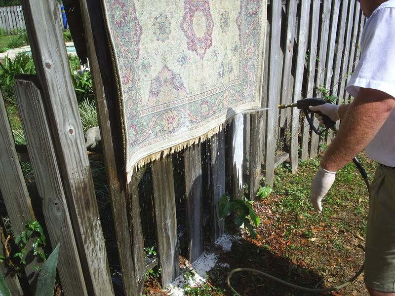

If the fringe is too fragile for scrubbing, or you are worried about untwisting strands (good question by the way...) - then you can use warm/hot water and help spray out the soil.
In this photo, you can't quite see - he is wearing a black electrician's glove to protect his hand and arm as he sprays hot water on the fringe to clean it.
Now... if the fringe is really bad .... you can charge $15-25 a linear foot and put some new fringe over the old. Problem solved! :)
Lisa
P.S. If you sprayed that shampoo on land in CA (I assume it's pretty harsh, because you have some gloves on...) - that would get you tossed by the CalOSHA troops. :)

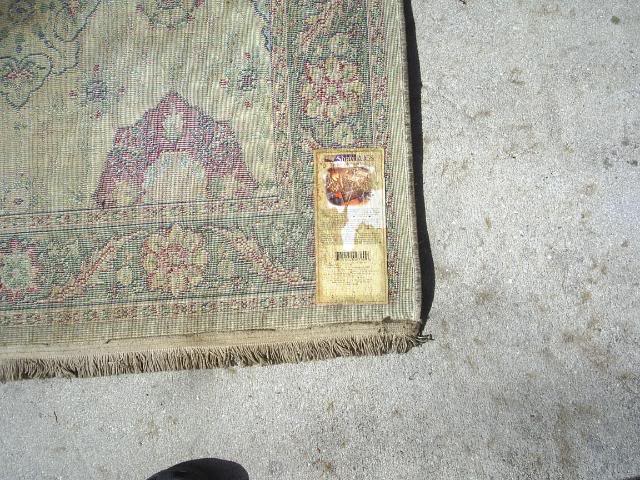

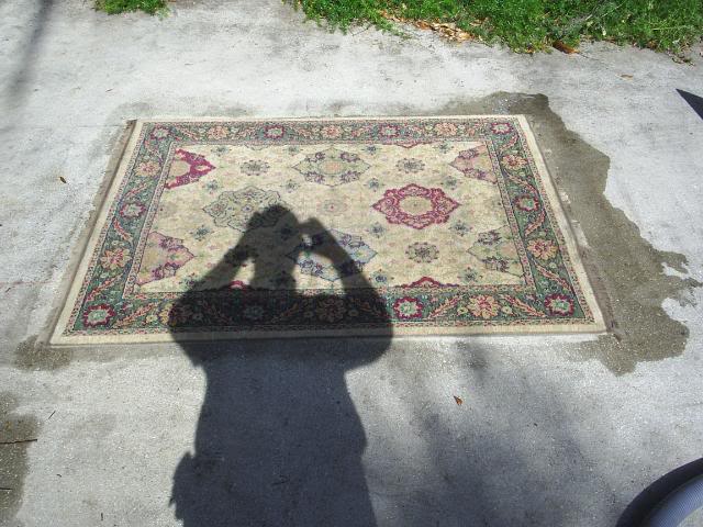

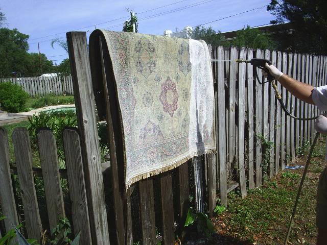

Great convo. Most fringe gets blasted in the wash process (Ellen's term not mine!) Then if they brown out a little during drying, most of the time a quick acetic rinse ala MB All Fiber and a quick extraction. Even on most color runs, bleach should not be the first grab all. There are other special products for those situations that work without damaging the cotton. Or atleast not nearly as harsh to the cotton.
joe harper
Oct 21, 2008
4,993
florida
joe harper
Ah .. Ha..!!!!
HaRReiT & Lisa.... !gotcha!
Now you both know that ..gUrU's.."should NEVER assume.... :shock:
The cleint requested the rug be cleaned as an "add-on"...She was Quoted $250.00 to
have the rug Pit Washed. Her response was... :shock: ...
The rug was "Riddled with Cat Urine"...& The fibers were "Brittle" from NUMEROUS cleanings
with "Woolite" Rug cleaner..!!!! The rug smelled HORRIBLE...
She ask if there was anything we could do at a ChEaPeR price... :?: We told her we could
FLUSH the rug out & treat topically with Hydrocide & leave outside to DRY...for $150.00..
There would be "NO GUARENTEE"...&...She would have to "SIGN-OFF".. Thus the PICS.. :wink:
No sHaMpOO...here...The gloves are to protect the tech from the URINE... :roll:
Rug was vacuumed ...Flushed at 500 PSI... hot water...Fab-Set was metered @2gph...
Rug was then...Steam cleaned.Hydrocide was topically applied,and groomed & left to dry..
Customer was contacted the following day...Rug was still "Damp"...but cleint was :D
We have since cleaned the rug, in place with the RDM.It looks great..MISSION ACCOMPLISHED.
