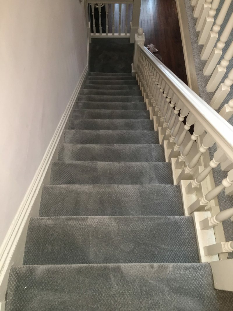

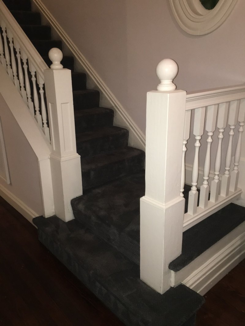

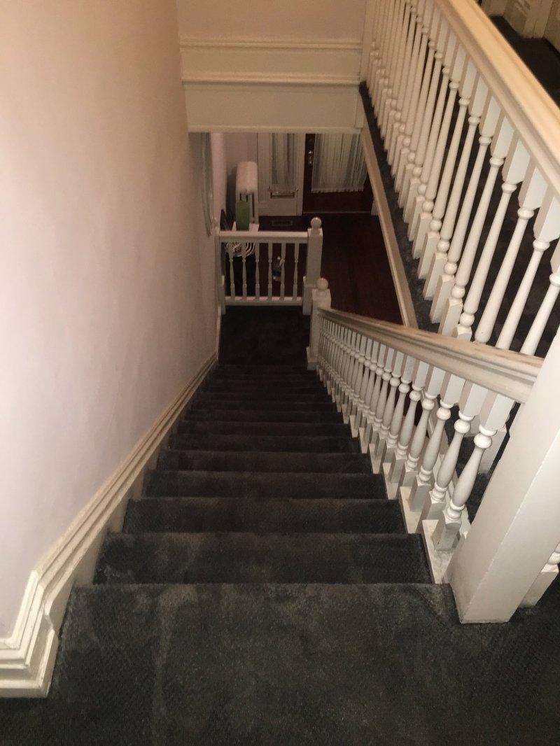

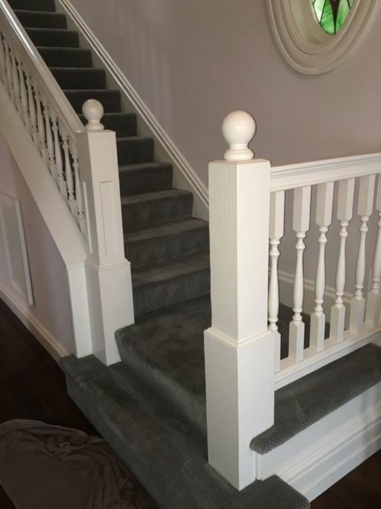

Nice job my technician completed today while I'm conducting a training in New Hampshire. Complete color change throughout a house. He took a light gray and changed it to a darker gray.
Dyes are guaranteed permanent and colorfast for the life of the carpet. Carpet maybe walked on 30 seconds after dyes have been applied.
Carpet dyeing saves you up to 80% as compared to the cost of new carpet replacement.

Hey Chris. What do you guys spray with and do you have to protect the walls? How the heck did he do that so quick with those stairs involved?

Kevin, we use a dye wand for apply the dye for jobs like this. Here's a video that will illustrate how we do it.
We use a dye shield to keep the dyes off of the walls. Having said that, the dyes will usually wipe off of the walls with a rag very easily.

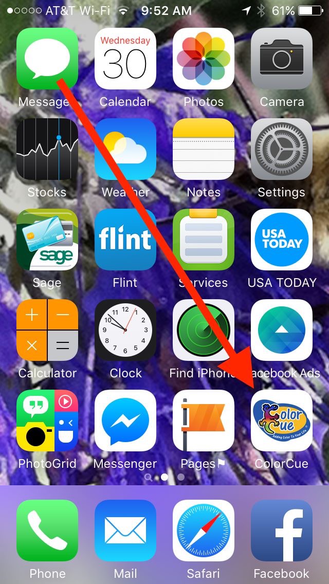

We no longer use Palettes. It was far too cumbersome and had features that made it very confusing. We are now exclusively using the ColorCue app which automatically calculates all of the colors for you. It permits you to simply take a picture of the carpet or rug and will then automatically measure all of the colors and show you exactly which colors are needed in the precise amounts. No more guesswork.
