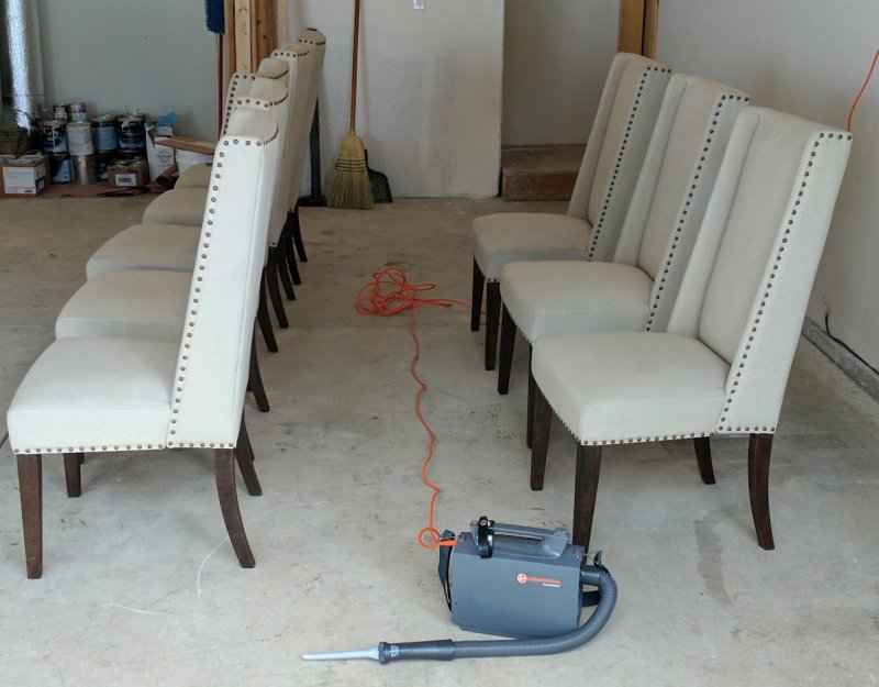

My recent cleaning of these linen chairs got me thinking about brass tacks..
Is there a way to test (the countless variety) tacks to see if rust is going to be an issue?
I know it's best to not get moisture near them but as you, I and Murphy know, spots always happen in between them...
