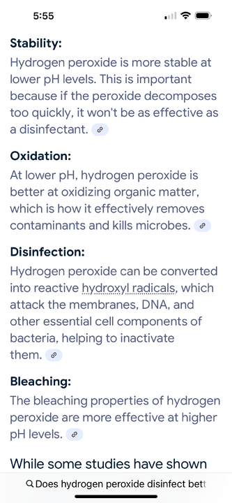

Peroxide apparently oxidizes better at neutral to acidic ph.
Peroxide bleaches better at higher ph.
What I learned is don’t mix peroxide with your pre-spray unless it’s a pretty neutral one. If one does mix peroxide with a higher ph cleaner, the oxidizing effectiveness decreases, and its ability to bleach increases.
FU guys.
