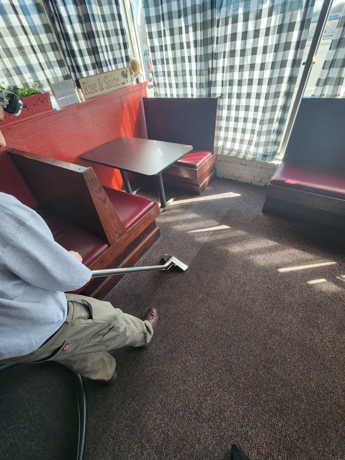

Hey y'all. While I'm not approaching restaurants for commercial work, 2 of them fell into our lap by befriending the owner while my wife and I were having breakfast there a few weeks ago. Thankfully they are each breakfast/lunch joints that close at 2pm.
The owner admittedly neglected the carpeting in the smaller diner that we just cleaned. Not the nicer one I met him at. This was a great place to practice and pull out bigger guns. So I used full strength Saigers Code Red boosted with Bridgepoint's Citrus Solv 2. I think it was pretty effective. Had the heat on my PEX portable at full blast and the psi at 250 hoping to not overwet the low pile carpet while trying to penetrate several years of impacted grease.
Wondering what techniques you would use to effectively clean greasy and neglected carpets without overwetting them. I'm guessing extended dwell time, fiery chemistry, and mechanical agitation would help a lot but I don't wish to taint a shiny crb with ancient restaurant grease that we bring in to high end residential. We setup air movers and hung out an extra 30 minutes when it was done to help accelerate the drying process. The owner was impressed and told me the carpets were dry the next morning, that was a relief. Anyways, any thoughts or tips?

Bump that pressure up to 500. The carpet will survive.
And you bought the crb for a reason. Use it
Besides that, you’re doing great job
Good tips thank you. I appreciate the encouragement as well!
With the lower psi I wasn't concerned about damaging the carpet as much as shooting moisture down through the backing and onto the floor possibly extending dry times until the next morning when the employees arrived. But also concerned about the backing and possible damage to the carpet in that sense.
I was also thinking about potential wicking causing spots and dinge everywhere for the same reason but wondering if the impacted ancient grease still at the bottom of the carpet fibers would act as a barrier to prevent wicking in environments like the greasy diner. Maybe I should've gone there for an early breakfast the next day to check it all out.
If any of these things are a potential issue (which seems to be the case in much of what I read), I suppose the solution to all of it when using 500 psi on a low pile carpet is to do extra dry passes between each wet pass.
14,295
Nah. No need to worry. My avg pressure is 600.
As for wicking, yes. On any heavy spots, you certainly need to double the dry passes over them. But you’re learning 👍🏻

When you said low pile, you've meant CGD? If you don't want to use a new CRB
( rightfully so) buy used one if you're planning to continue to service greasy restaurants. You can get a
used Oreck Orbiter for now, it wil help you with tough traffic lanes and if you get brown, black, blue and orange brushes, you can hack your way in the world of tiles&grout and hardwood floor cleaning as well 😉. The main takeaway from your experience is that you have to convince owner of the diner to commit to scheduled cleaning, monthly- best scenario, or quarterly. If diner is busy, it shouldn't be a problem . Otherwise, you're going to have the same problem, a trashed carpet.

I'm not a fan of using a CRB on CGD. I instead opt for something heavier like a 175 or Mytee ECO with a red fiber pad. Saiger makes some great products, but if you get a chance try some Prochem Ultrapac Extreme. It cuts the grease like non-other and because it cuts better you use less water.
I am also a advocate for post VLM using an encapsulation product. This always yields great results.
If it's a really greasy place nothing beats Rotary Extraction followed by Encapsulation.

Get a rotary before you buy a CRB
Don't let anyone convince you different.

Guys love CRB's because they're light in and out of van.
Fact is, rotary kicks their azz on any carpet for shearing soil off a fiber.
15 seconds of side by side agitation of CRB vs roto scrub on soiled CGD will be all the convincing you need.
You'll see with own eyes
BTW, Bridgeport Flex is a great pre-spray too.
Citrus terpenes are great cleaners, but don't rinse so easy from my experience
