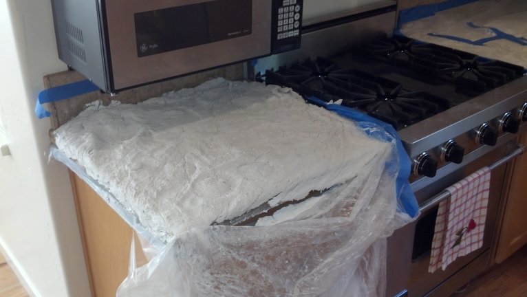

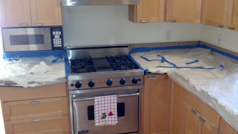

Had a lady finally bite on my price (usually I just tell them how to do it)
which is high cause I have to come out (I thought) 3 times to ATTEMPT to poultice stains out, one to apply, one to remove the plastic wrap 24 hours later and a third to clean up the mess.
Well the first time (plaster of paris, 40 vol and acetone) didn't do much so I suggested a 2nd round minus the 40 and low and behold... :shock:
now she is going to have me do all of it.. :roll: :roll:

same thing I used ConnOr.
plaster of paris and lots of acetone, mix it up so it resembles thin yogurt, keep it under wraps (blue tape) for 24 then let it dry completely.

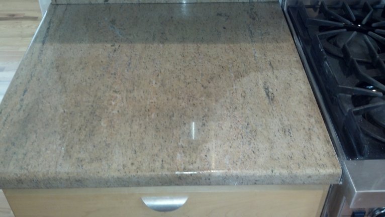

There is NO finish on a polished granite Jim.
The light spot on the right corner use to be dark brown from fried egg grease. When I poultice the whole slab tomorrow it will even out much more.
But not perfect.

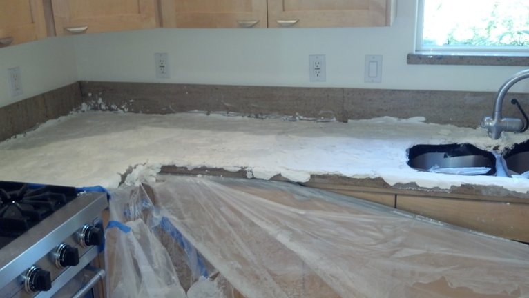

I finally got out there today to applied the 3rd coat
3.5 gallons of acetone and 50 pounds of plaster (Mixed)
I never want to be around that stuff again.

This dang project is taking forever.
I'm headed over there tomorrow to clean up this mess and seal her up regardless of remaining stains..

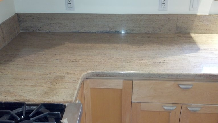

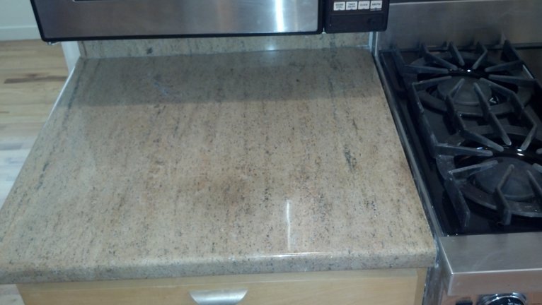

Before..
After
This are looked the worse, all sorts of weird symmetrical lines and streaks of embedded soiling that is not gone.
Some staining remains along the edge of the range but WAY brighter over all.
No fun at all cleaning up that plaster.
