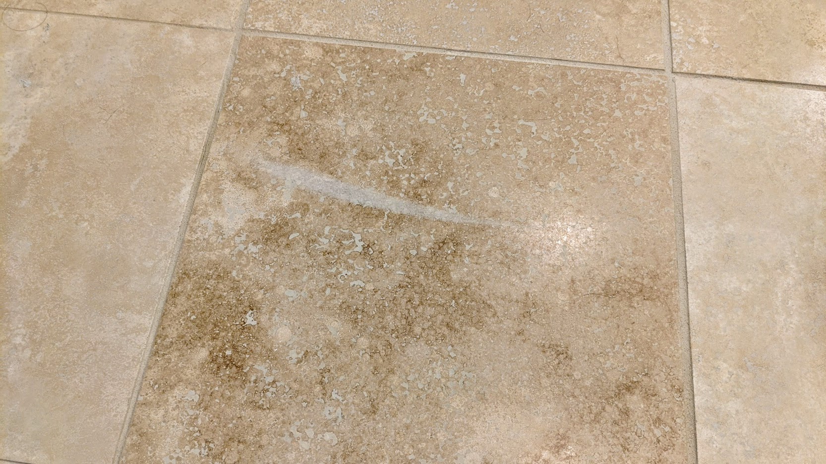

Here is the $50 scratch repair
The white streak is a kind of a gnarly scratch at least a biz card deep. It s new floor and they said the tile installer had no answer as to why he didn't toss the tile or on how to repair it.

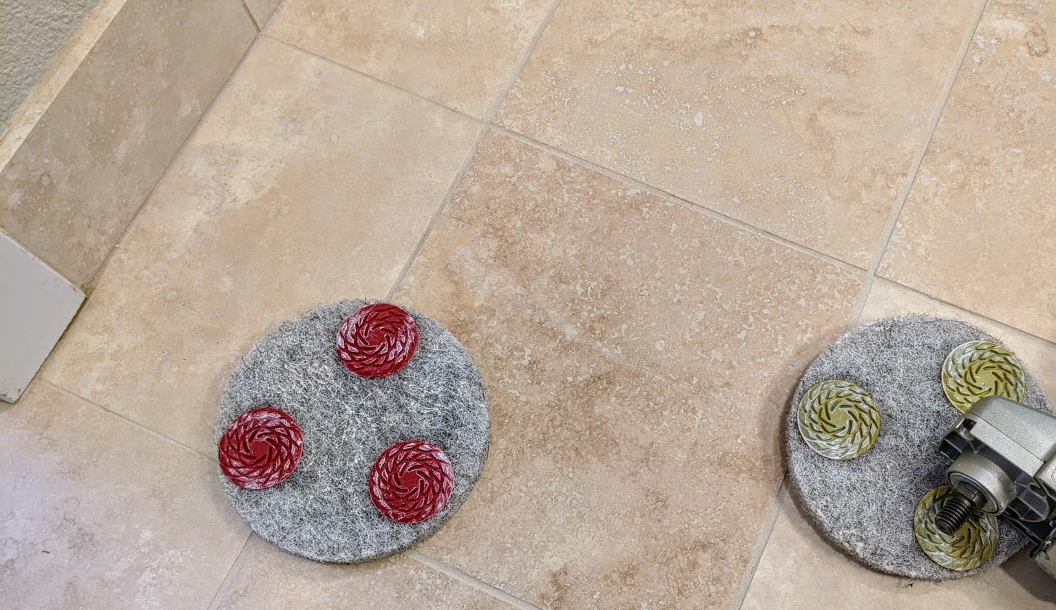

45 seconds with a 220 resin and 30 second with a 400 had a perfectly matched sheen no sign of the scratch and a smooth as a baby's bottom tile. All the other tiles were very rough from grout residue and uneven epoxy fill..
The whites "comet tail" swoosh is natural in the stone so I'm guessing someone tried to remove it too aggressively

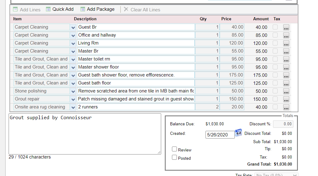

Could I have pulled a Chris Howell and charged them $500, maybe.

View attachment 100632View attachment 100633
Could have just sent them a pic.
