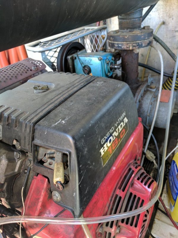

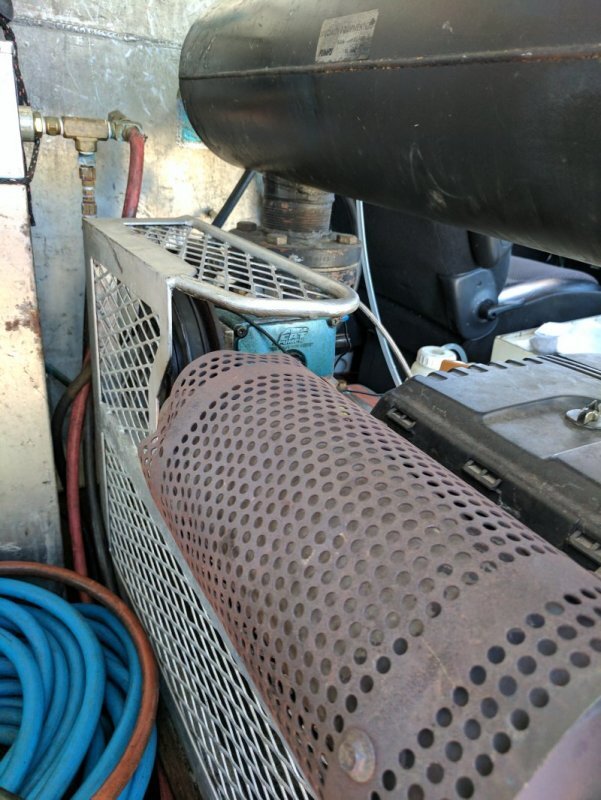

I built my own but when I say that, I also had professional help in fabricating and assembly. Then tweaked it it about over the years. 18 HP Honda, Sutorbilt 4mp blower, cat 290 pump, lg 3ht propane heater. Parts were scavenged from other units except the motor and heater. Been reliable for the last 12 years or so. Rebuilt the engine once at 5000 hours. Blower is belt driven and my belts last a long time.

Here's some pics.
28,268
Cfm is about 300 at 3200 rpm, I usually run it at 14 inches hg. Heat will fluctuate between 200-230 degrees f depending on the outside temperature. Although I designed it, the main assembly was done by a company specializing in industrial vacuum systems. Cost was about $8000. I probably wouldn't do it again. For just a little more you can buy a nice heat exchange unit that will come with a warranty and dealer service. This machine was designed so all the components are easily replaceable which means I will probably have it for the rest of my life. I would really like to have a heat exchange machine like a Legend or a SS 370 but just can't justify getting rid of this one.
