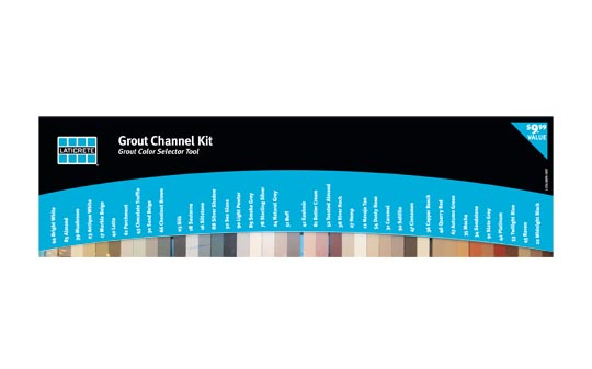

117,240
Go the all the tile stores in your area and find out what the most popular grout brands are. In my area it's Hydrament and Custom.
Both of these companies sell or give away (if you talk to the right people) a kit of 3 inch by 1/4 inch plastic simulated grout in all the available colors.
It REALLY helps the customer and you pick the make the right choice. Paper color charts can't compare.

Mike thanks for the color chart looks nice.
