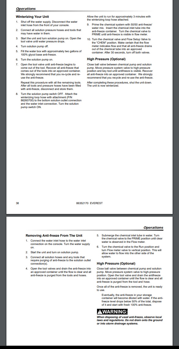

I live in Montana and for my first 5 years owning a TM mounted in a trailer I winterized every night. @BIG WOOD is correct with his advice. I can winterize my setup in under 5 minutes.
1. Suck all water out of water box. (I use my 1.5" cheater house, that I just stick into my vacuum port directly on my waste tank.)
2. Fill water box with windshield washer fluid. Usually at least 3 gallons. There's a way to cheat the float to get by with less, but 3 gallons usually does the trick.
3. Run an open ended solution line until you see washer fluid coming out.
4. Stick your rinse line into a a jug of washer fluid, and prime until you can see it in the sight glass of your meter. I'll often continue to run about a half gallon through while running more fluid out my open ended solution line.
5. If you wish you can run remaining fluid through tools and lines.
6. Suck remaining fluid out of water box.
Even after following these steps there is still potential for frozen gauges and anything that is brass can crack with even the slightest amount of water left. I would often also run 2 heaters with a thermostat set to 39° on different breakers.
Best of luck.
