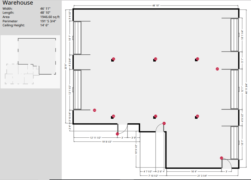

We are moving into a new building in the near future and I'm working on plans myself. What I'm doing is cutting the equipment out of paper to the correct dimension according to our drawings, this way I can lay it out and develop a flow that will work efficiently. I don't worry about the existing drains to much because you will be cutting up the floor for perimeter drains anyway and if you end up too far for the slope they make special sump pumps for that. We use all Centrum Force equipment and Toms right, you don't want any curbs, just perimeter drains. If you ever need to soak rugs overnight you can build quick temporary pits out of pvc and cheap plastic for a liner, I've seen horse troughs and other items used for soaking urine contaminated rugs.
Make a list of all the equipment and other items you will need and their dimensions. I do this for all future equipment that I may need and storage as we expand so I can be ready when the day comes. This is what I believe you need in order of importance and I'm sure it's incomplete. There are also many other small tools, equipment and other items that you will need.
