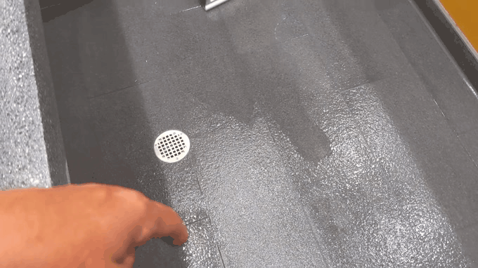

The video of your grey floor. It looked pretty splashy.
North East Ohio
I was just fixin' to find that vid.
Later in the vid when pulling left to right, appears to be a substantial amount of water left during back stroke.
I don't consider that a big deal though really
and I don't know how a "well known member" of the Society of CC's couldn't/wouldn't know they had a 2" obstruction in the vac system :headscratch:
115,988

You're right Mike I watched with the sound off and am making assumptions... Is the correct answer, but I can see you're going to be a dick today.
24,043
The only way to watch your videos is with the sound off. Hahahaha
I took that pic of the video you posted with no sound on here....Marty, do I need to say it? I don't feel like sending you a royalty check.
