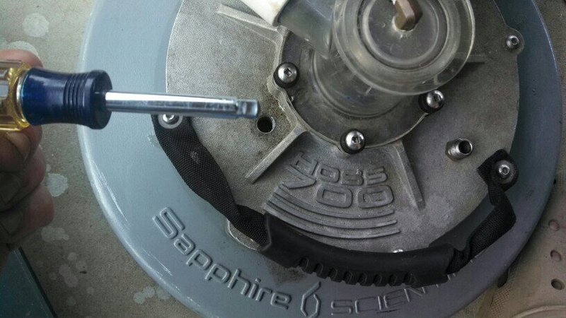

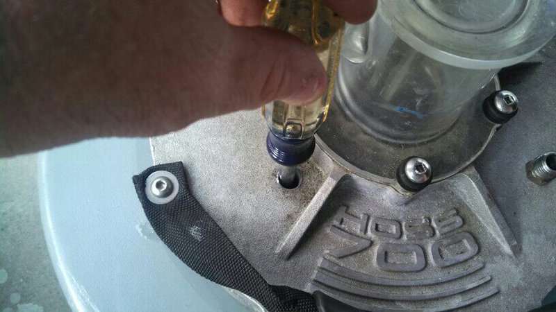

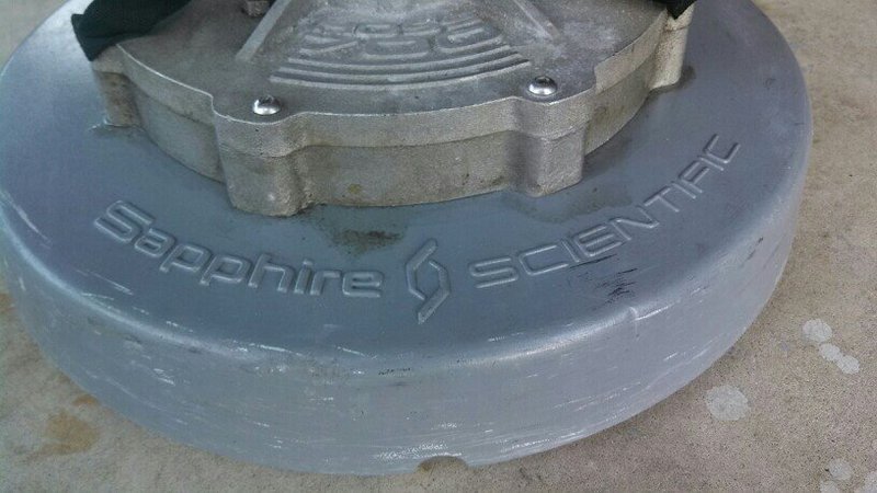

If I did this with my hoss, I would have a mess on my hands. I am constantly wiping fluid off the deck. Is there a gasket in there or suppossed to be a gasket in there?
Jim Martin
10,877
Jim Martin
I will take a closer look at it when the sun comes up but I don't think there is one in there.......(?)...
Have you tried snugging them up a bit.........

Is it leaking from the breather stone or from the case lid?
117,270
My RVXL didn't come with a breather stone. Started leaking from the gear box lid almost right away.
They want me to rip into it to replace something called a roll pin and or send it back for them to do..ugh.

I am guessing it has some kind of gasket material but not sure. Maybe some silicone or something.
Jim Martin
10,877
Jim Martin
Sorry........the only thing that went like I wanted it to was the sun did come up..........
I looked at both of mine and it looks like there is some type of sealant between the metals........
How bad does it leak when you are using it.....
I would be more concerned about sooner or later running out of oil and locking the thing up....should be easy enough to separate and re-seal.......

I just checked it and it was too low on gear oil. Put almost half a quart in it.
We only use it a couple times a week. I wipe almost every time I use it. I just topped it off about 2 months ago. I didn't realize it was leaking this much. Obviously getting worse to lose that much that quick.
